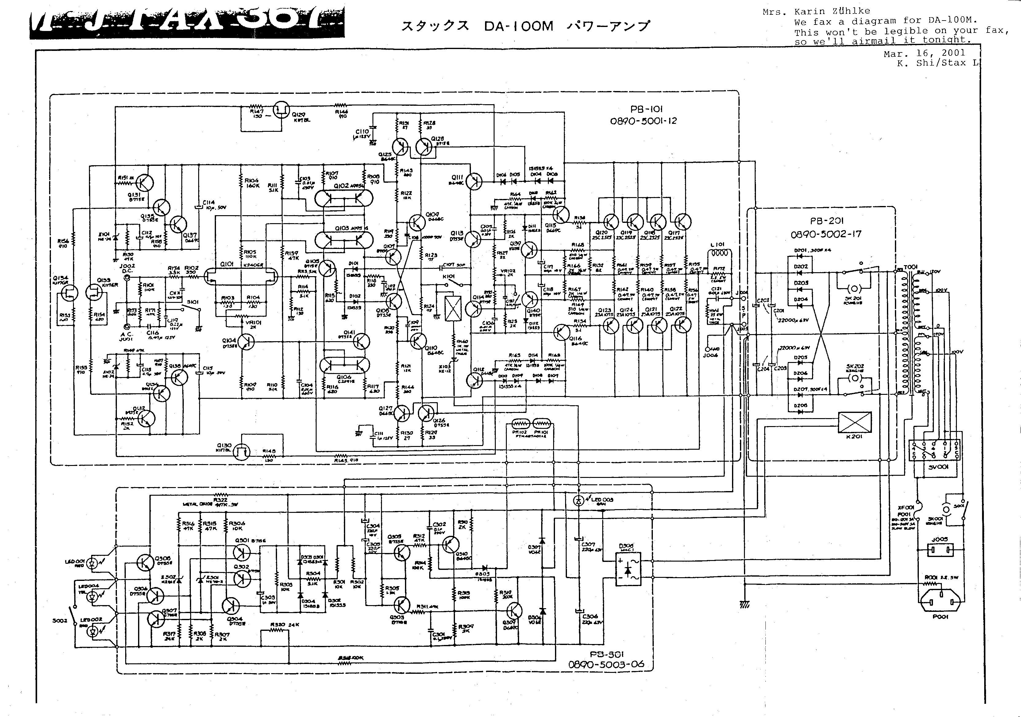

STAX DA-80 - 80M
Hi all , i need from STAX DA-80 or 80M schematic.
Walter

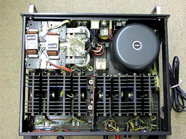

You have pictures of the insides of your amps ?
(pas des images, alors, ça c'est un crime très grave)
jacco you ruin me, i have ordered shootky diodes, 22000uf nichicon power supply , small ones nichicon FG , 0.47R non inductive emmiter resistor , kerafol insulator . i will report the result in a week or so ( if it will not burn before 🙂)

Hello everyone The DA100 power supply circuit has diodes D301, 302 marked T3. Please tell me the modern analogue of these diodes. Thanks.
