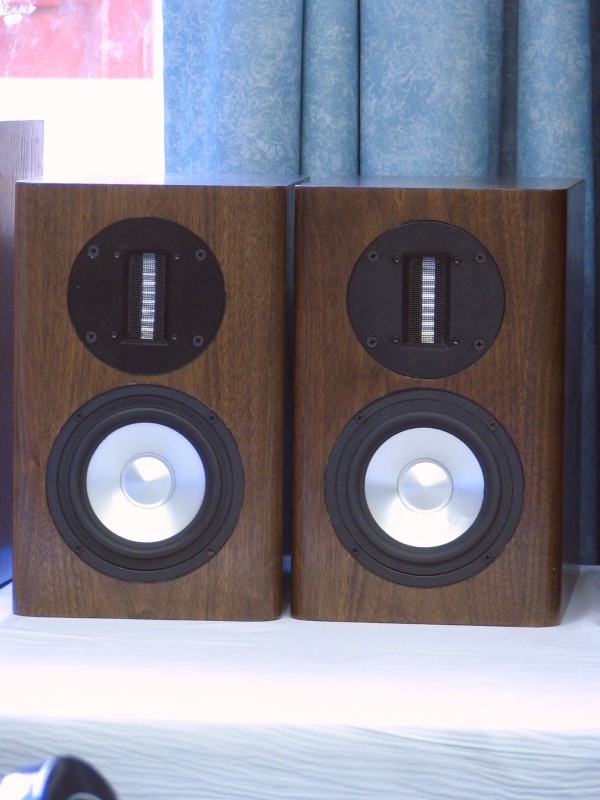

the link to my Jordan JX92S with the Aurum Cantus G2si ribbon design is as given below. A great sounding speaker indeed!
Jordan JX92S with Aurum Cantus G2si Design

I don't think adding a tweeter to the JX92 makes sense either. I recall that ribbon tweeters don't have good spectraly decay characteristics due to the basic structure. Dome tweeters are realy out of the question. Laminated foil ribbons might work, but have some other issues involved.

Jim Griffin said:the link to my Jordan JX92S with the Aurum Cantus G2si ribbon design is as given below. A great sounding speaker indeed!
Any phase response plots available?
I might be moving to Birmingham this year . . . you be willing to audition those puppies if I drove up?Jim Griffin said:the link to my Jordan JX92S with the Aurum Cantus G2si ribbon design is as given below. A great sounding speaker indeed!
