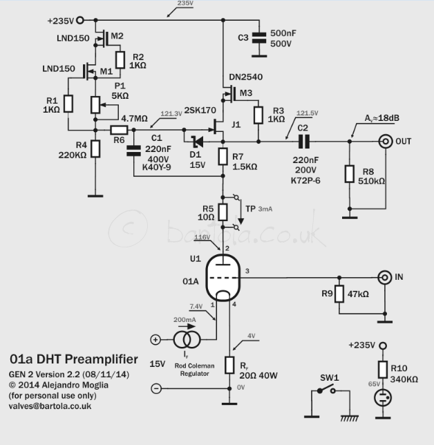

If I am not misguided in my thinking, this V ref idea should subsitute nicely into the circuit included in place of the LND150 CCS based reference.
Yes - the reference voltage there is set by the CCS controlling the current through R4.
Note that the MJSR voltage is only adjustable in deltas of the chosen zener voltage, i.e. a typical granularity of 5.6V (*), but there are ways round that for such a low-current voltage reference - the CCS in the 01a G2 is only set to about 500uA/0.5mA.
(*) with 21 x 5V6 zeners under typical operating conditions you should get about 120.5V of regulated output.
