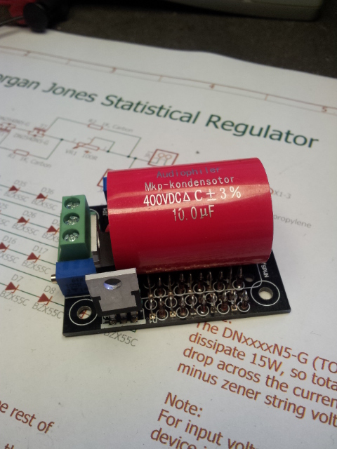

Yes - I use a 400V, 10uF polypropylene (MKP) capacitor from Germany - they cost less than USD 5 and from my tests, are pretty good - they are also not too big... The whole PCB is 40 x 55mm.

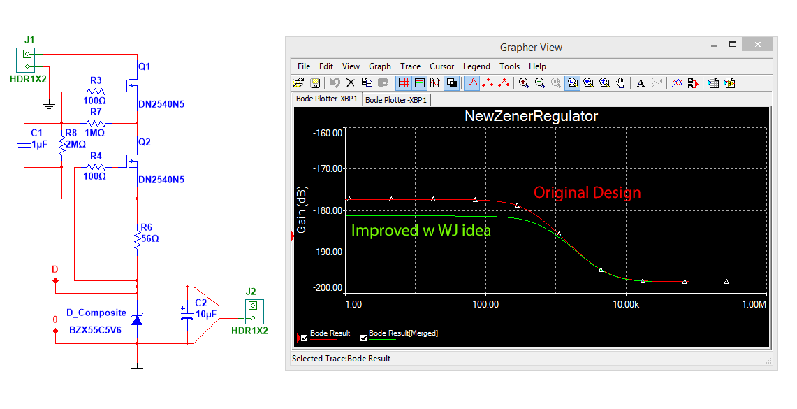

The comment about not being able to adjust the current with the 100R pot suggests either you've wired the CCS wrongly or you've got a dead FET.

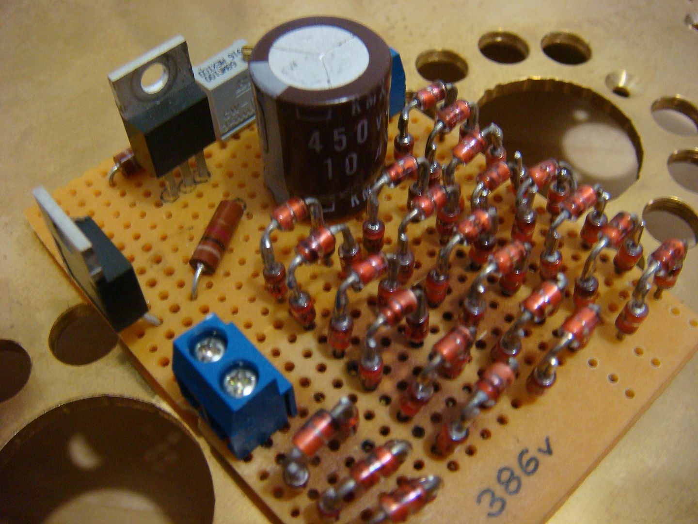

I've 379v coming out of the regulator from a string of 69 pcs. 5.6v zeners.
Cheers!

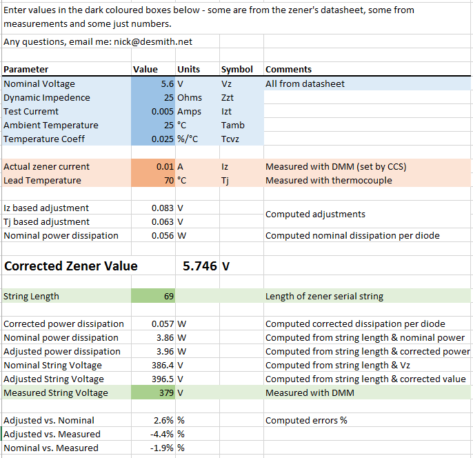

The nominal value of 69 x 5v6 zeners is 386V - To get a measured 379V is a bit odd - are they all the right way round?
Basically, with those zeners you expect the actual zener voltage to rise slightly with zener current (Iz) and with increasing temperature (though the effect is less than that of increasing Iz).
See the enclosed spreadsheet which models these effects pretty accurately - I would expect to see about 396V, assuming, conservatively that you've got about 10mA going through the zener chain and that they are running at about 70C.
Whatever happens, if these are BXZ55C5V6s, then the zener voltage should be ABOVE the nominal in this use case. If you are not using those, let us know what ones you are using...

Based on the 396V figure by Nick (instead of 379V) and your problems with setting the CCS, I suspect you may have to little voltage for the CCS to work properly? A simple test would be to temporarely short out some 20 zeners (with a clip lead) and see what happens.

I agree about Vin as a possible cause - he's also using an electrolytic rather than a polyprop and I hope that there is some headroom above 400V - I allow about 15V across the CCS to get reliable operation and to keep thermal losses in the CCS to a minimum.
Normally run between 10mA & 20mA through the zener string (as recommended by MJ) - the board I designed has test breakouts for both output and zener string current...

Playing with the Statistical Regulator is also on my "to do" list. I will probably be using these point to point wiring boards, attaching zeners to both sides, and mounting the whole think to the chassis (so the board is vertical). With enough holes in the chassis the air flow would be quite ok to cool down the zeners.

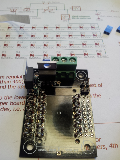

My boards also only take 40 zeners, i.e. nominal 224VDC, so you'll need two boards - one just with zeners, the other with zeners and the CCS etc... The boards will need to be stacked about 10mm apart with spacers and have a couple of jumpers between them...
