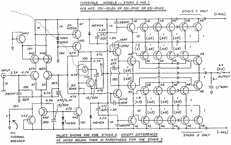

I have a Stasis II and am concerned about the fact that the VBE transistors are in fact MPSA 6571 on both channels (vce 20 w).
I do not know wether the've been seviced with a replacement or built that way; Are the MPSA 42 the original parts as on the drawings?
Sam,
I have two Stasis 3's sitting in front of me. The Vbe multiplier is not attached to the heatsink. The thermal breaker is attached to the heatsink. If you look at the diagram you will find that the resistor is 4.7k. The unknown device is a thermister.

The transistor types are now shown from the driver stage to output stage. Any ideas? The output devices are loaded with resistors which have marking such as 1(.68), 1.5(.3) etc., Does this mean 1E, 1E5 resistors and the numbers in parenthesis the voltage drop.
--snip--
[/COLOR]
Reading the schematic it says that values are for Stasis 2 and the values in parantesis is for Stasis 3.

Can somebody please inform what the component I have marked is ??? :scratch:

I wonder if it goes wrong to attach the mpsa 42 vbe multiplier to the headthink through short links from the back face of the pcb(approx. 6 to 8 cm). so that it senses more of the overall temp of the amp?( the plastic can could be glued in a flat metal pipe )
what do you think of that? would mr Pass be ok?

I am having trouble getting my Stasis II in good working condition,
can you help?
the problem is a sudden loss of control of the bias current after some time (variably from a couple of minutes to some 10 mn.)on one channel.
Bias adjustement is now set by a 10 turn trimmer,( as the original trimmer was worn out) and everything is fine up to about 0.5 A bias, but when set to 0.8 or 0.9 A ,after a while bias jumps suddenly to 6A !
it occurs always on the same channel, the other one works fine
we've checked all components, changed mpsa 42, thermistor, driver transistors, checked all connections and circuit board for cuts, etc
point to point checking is identical on both channels unpowered
but we cannot perform checking while under power because of the bias instability
Have you any comment or hint? It would certainly be the most helpfull and welcomed

Hi Nelson
We have done what you suggested and everything was fine during an hour or some, with bias set at 0.75 amp.
then we fed some output from a preamp, the oscillation was there again and bias was up to 6 A.
Next step we shall cross the cards and output transistors to watch if the problem moves sides; and then ...
