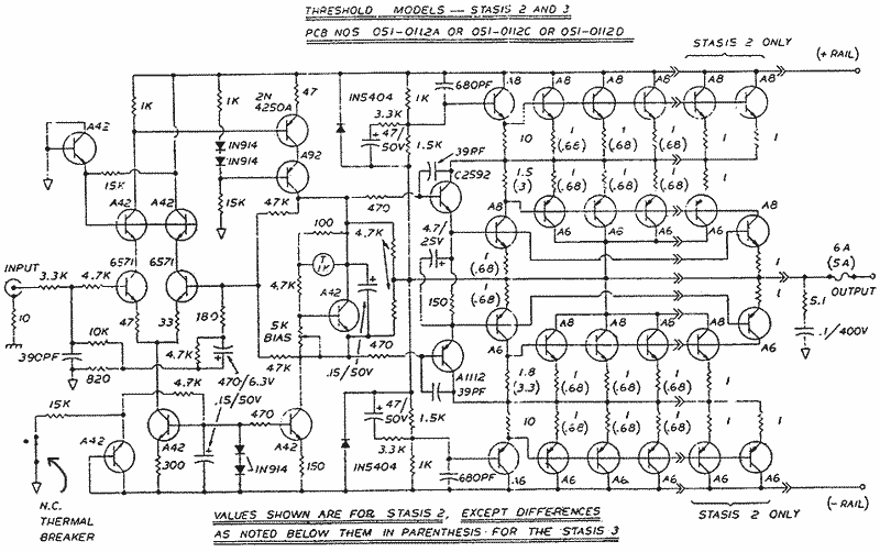

Here is the schematic for the Threshold Stasis 2
and 3. This was a very old photocopy, and I had
to spend some time trying to clean it up, but it
is now readable enough.
www.passlabs.com/temp/stasis2-3schem.tif

Dear Mr. Pass
I know that I have seen this already (but I don't know was it a SAE or GAS model) : NFB not taken from the output but from the VAS or driver stages.
Was there any other reason, apart from stability issues, for doing so ?
The output stage topology per se, I must admit, is quite clever ! 😎 🙂
What were the THD figures that could be achieved with this circuit ?
Regards
Charles
The licensing deal with Nakamichi was purely a $$ deal.
The PA-7 was the approximate equivalent of an S300.
Sorry I don't have schematics of the SA1000's, but it
was simply a balanced version of the other big versions
of the Stasis series.
The THD figures of the Stasis series varied by amplifier, but
were generally in the .00X range at low wattage, increasing
to about .1% at full power. Distortion was flat across the
band, rising to about double at 20KHz.
Leaving the output stage outside the loop made the amp
sound better, and of course was a good marketing decision.
:Pirate:

Mr. Pass
Tanks for the answer.
But there is still a question that bothers me: I assume that the decision about the feedback takeoff point was made due to measurement AND listening tests and that several versions have been tried (am I right ?).
Did both correlate or was the feedback takeoff at the output sonically inferior but superior from the measurement point of view ?
Regards
Charles

Dave, thank you very much for posting the schematic of the Stasis amp.
I have a few questions about the schematic. I know that Nelson is busy at CES, so I don't really expect answers from him. But anyone else...?
The Vbe multiplier is shown as A42. I presume this is an MPSA42. I wonder how the TO92 package is coupled to the heatsink for thermal tracking. There is an unmarked resistor between the Vbe emmiter and output track. What could be its likely value? A meter like diagram is shon in shunt with the 100E resistor in the bias circuit. What could this indicate?
The transistor types are now shown from the driver stage to output stage. Any ideas? The output devices are loaded with resistors which have marking such as 1(.68), 1.5(.3) etc., Does this mean 1E, 1E5 resistors and the numbers in parenthesis the voltage drop.
A thermal braker is indicated in the CCS of the first stage. Where does this connect?
Finally, can modern devices replace the ones originally used. That is the rail voltage, output power and 2ohm capability of this amp?
I ask because I want to compare this with the Leach Amp which I have decided to build as 2ohm capable, in order to drive 2x18" hornloaded paralleled woofers at 1200 watts (4ohms) ie., Bridged Leach Amps.
