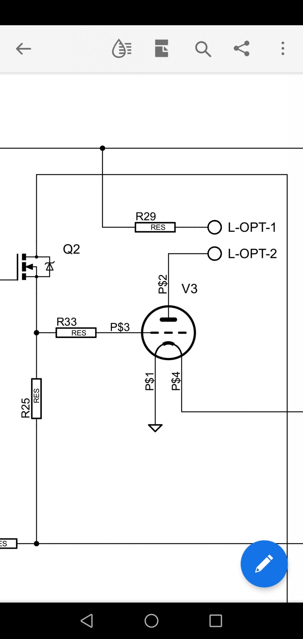

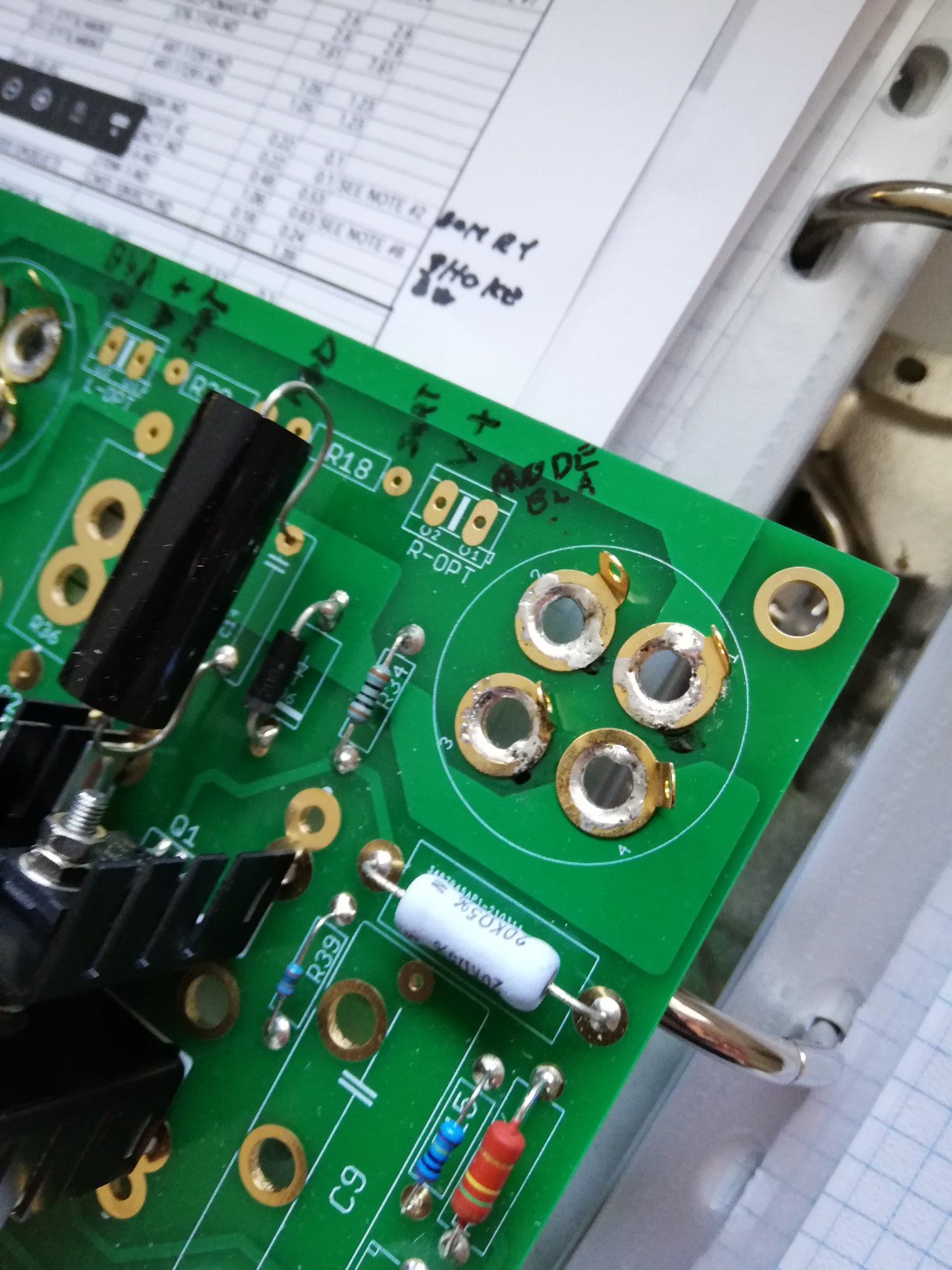

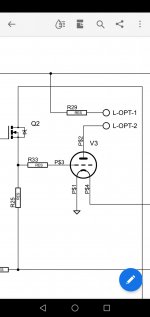

I would like to add holes for banana jacks for setting the biases. I've looked for the connection points and settings but so far have not found this information. It's no doubt somewhere obvious, but I'm not finding it. Can someone please direct me to it. Thank you.
Most folks flip the amp over and get meter leads on R18 and R19 above. I elected not to use banana jacks on this amp for bias because those resistors are at B+ voltage and I didn't want to expose them/B+ on the top plate.........but you certainly can.......perhaps they sell covers for the jacks.....dunno...
Thank you for the images and information. Hopefully the image of the jack's I have in mind appears. I can make plugs for these, though, with the other test points to consider, and as these will be under the Aluminum plate, it makes sense not to add the B+ jacks. I can make the bottom plate/cover easily removable.

You could consider recessing the jacks on the rear of the chassis with a cover plate ...just thinking out loud...
This is what I've used, the insulation is about 1/8" deep, or, the contact is recessed about 1/8", which seems adequate given there would be separate pos. & neg. But with several voltages to check, it may be more practical to remove the bottom plate and check the PCB contacts.
