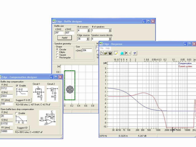

Okay here is the Baffle step simulation using Edge(i hope i did it right...)
and this is the baffle compensation
p.s the mic was kept at 1m and the baffle size is 297X837(in mm)

thank you Navin,
the thing is after looking at the Bipole idea...it will need a fair bit of woodworking skills and am not yet ready for it (and don't have the time..) i have decided to keep it a 3way(TMW) and am going to keep the crossovers outside the box so that later i can try out an active setup, as Nappy suggested.
now as i understand...the inductor in the baffle compensation circuit should not be an air cored one.
Why?
if so then the inductor is going to be expensive. what happens if i use an air cored one?
if not then
can any of the Bangalore guys help me in letting me know where i can get good inductors......... or
if i can make one on my own can anyone give me instrcutions as to how i calculte the inductance(like the one given on Rod Elliot's site for air cored inductors)..also the materials that i can use for the cores..

why does the bipole require more carpentry. you only need make a hole in the rear baffle.
the only reason to use iron core for baffle step ios that the inductor values are large. iron core is cheaper. only you must use soft iron.
i also find that air core inductors tend to soften the dynamics if they are too large. why i can only guess. over 1mh it might make sense to investigate iron core.
