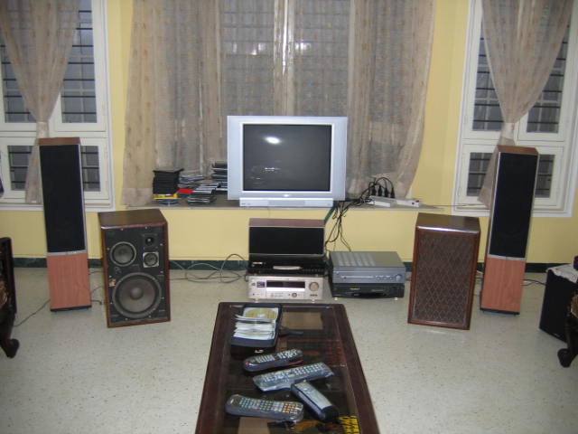

i know that for my first project a 3-way may be too much work but i don't mind cause from June 4th onwards i am pretty much free for 3 whole months. with the help of this forum i'm confident that i will be able to suceed in getting decent levels of SQ.
here is the problem.
i presently have a pair of old(30 years old) 3-way 4 speaker system sealed monitors. the cabinet is made of teak and filled with glass wool.
as i see it i have 3 possibilites.
1> Replace the existing drivers with the new ones that i have bought and concentrate all effort on designign a new crossover for the 3 way and keep it sealed.
2>ditto,except make it a vented enclosure.
3>design and build a complete speaker system from the ground up ,including the enclosure and decide as to sealed or ported along the way.
the dimensions of the old speakers is 20'x9'x11.5'(LxDxW).
The speakers are shown in the picture that i have attached. they are heavier than the wharfedale diamonds that are next to them.
Looking forward to ur views.
Sachi

Hey Nappy,
the volume of the enclosure is about 1.4 cubic feet.
Yeah, i will draw up some plots for the different configs before deciding.
anyone who can help me in this regard??
am using WinIsd.
Regarding getting crossovers designed, i think it would be better if i try to design it myself so i can gain some knowledge(even if it means making mistakes and more importantly learn from others)
Vivek, the towers are Wharfedale Diamond 8.4s.
Sachi

This is my first shot at designing a speaker.
here is the gain plot
The Gorup delay
the phase plot
The Gorup delay
the phase plot

How long to burn in the drivers before measuring? That's a complex question.
The longer you burn your drivers in, the less the parameters change with more burning in; but they never totally stop changing. (It's like asking how long it takes a note on a piano to decay... it never decays fully, but it will fall below your noisefloor eventually.) You might try measuring the drivers *right* when you get them, then measure after every hour of burning in, and decide when they've burned in long enough.
Please understand that your box volume will be off by some amount; maybe 1%, maybe 10%. Most of the time, no one worries about it very much, because most of the time, in-room response contributes more error to the speakers response curve than errors in the box.
In short: shoot the engineer and build the damned thing.
