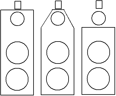

My whole reason for moving away from the H- Frame was because the whole baffle really only needs to go down to around 90 hz to meet with my subs, and your advice in post #6 "if you don't intend to use the H or U frame below 60 hz there's no advantage." so I've only really been thinking about single flat baffles.
Really, I'm just trying to come up with the best baffle I can in order to give this experiment the best chances. The only reason I considered the huge baffle (before I read your PDF) is because the two nice BB ply boards I have that will become the permanent baffle are that size.
I know that's a bad idea after reading more on the subject, I'm just trying to figure out the best possible size and shape before I attack those boards with the saw. :)
These are the two I'm thinking about at the moment.
Edit: Ignore the Neo3 faceplate, that's the only model I could find to import and I'm far too lazy to draw one myself :p

I'm going to try it in steps, starting with the baffle that just narrows a bit toward the top. I may steal one of gainphile's ideas and use my old passive xo for the mid and tweeter and just try equalizing with the minidsp, that way I can eq the bottom woofers as well.

My three-step proposal:
Make the square baffle and put the dipole tweeter on top of it. Take care to keep the distance between the mid and the tweeter quite small. If the midrange appears to need less baffle width, you could cut off some triangles. If you want even less baffle for the midrange, cut off the triangulated part and install your coat hanger. :)
Try to keep the woofers to the floor. You want to use the Allison effect.

Beautiful, thanks Rudolf :)
