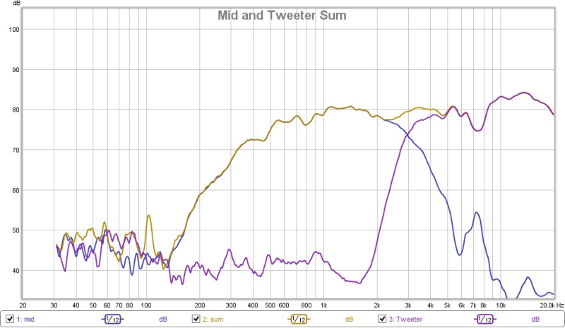

Here's the mid and tweeter sum with filters engaged, both @2800, mid 24 db/oct tweeter 48db/oct.
Edit: Added complete with overlay, individuals, plus with mid reversed.

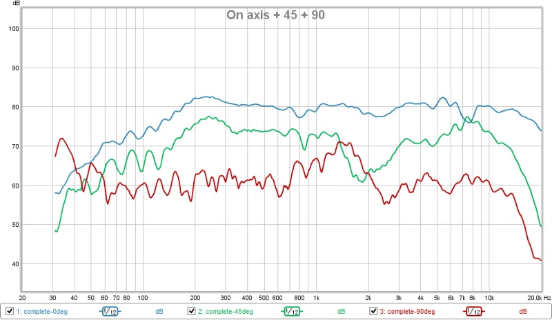

Aaaaand now...a very small amount of tinkering with the tweeter's response, on axis, 45 off and 90 off.

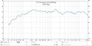

Edit: And, just because I'm curious (sometimes way more than I should be!) Here's an additional, 180 degrees measurement.
Edit2: I'm thinking I might leave the woofer as it is, with the roll off below 200 cycles. Once indoors, I can cross over to the subs at ~150 and adjust the slope so that they sum while running the mains full.
Playing music through them outside right now and walking around in a circle doesn't sound as peaky as the measurements would suggest.
Mid-tweeter is almost there. If you can try a 36 dB/oct high pass for the tweeter (instead of 48 dB), the acoustic crossover might become really symmetrical.

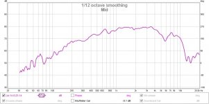

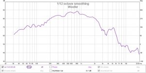

The woofer-mid transition is still a (sort of) mess. Can you show the response of both drivers in that area without any corrections? Possibly you need to apply some EQ before applying the high-and lowpass filters.
Sure thing, here's the tweeter changed to 36db/oct BW filter, no other changes yet.
Edit: It might get a little peaky now, Cicadas are starting to wake up...they're loud!
Edit 2: Mid and Woofer..Woofer is basically uncorrected, the mid has a little EQ to soften it up.
Thanks, but still not symmetrical enough. How about lowering to 24 dB/oct? And probably raise the frequency of the high pass 200-400 Hz on that way. Just try to achieve the deepest notch for the inverse phase case.
