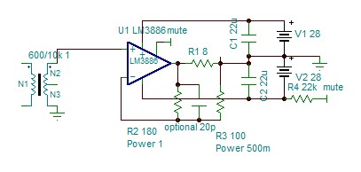

attachment.php
This is the highest quality sound I could get from LM3886 with split supply. Put it on small heat sink to allow it run at 70°C non isolated IC version.
You don't need a PCB, but two tiny ones that you can tailor by scalpel. The supply feet are plied upward to receive the capacitors and the mute resistor, the feet of the IC are not through hole but flat soldered. The signal feet are left flat, a second tiny PCB holds the feedback resistors, optionally the capacitor. The input transformer 24$ a pair comes with it's own PCB.
The pin1 is doubled by electrolytic capacitor lead soldered from root to PCB, the negative supply arrives at the tab, the pin 2 out+3NC are soldered at the root and on PCB together.

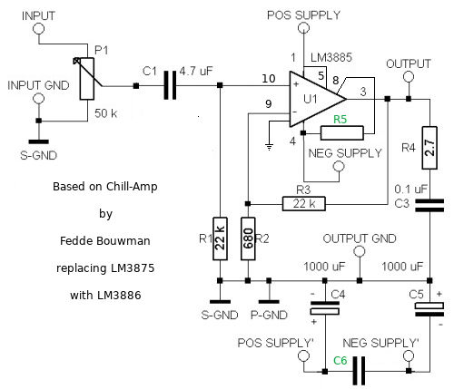

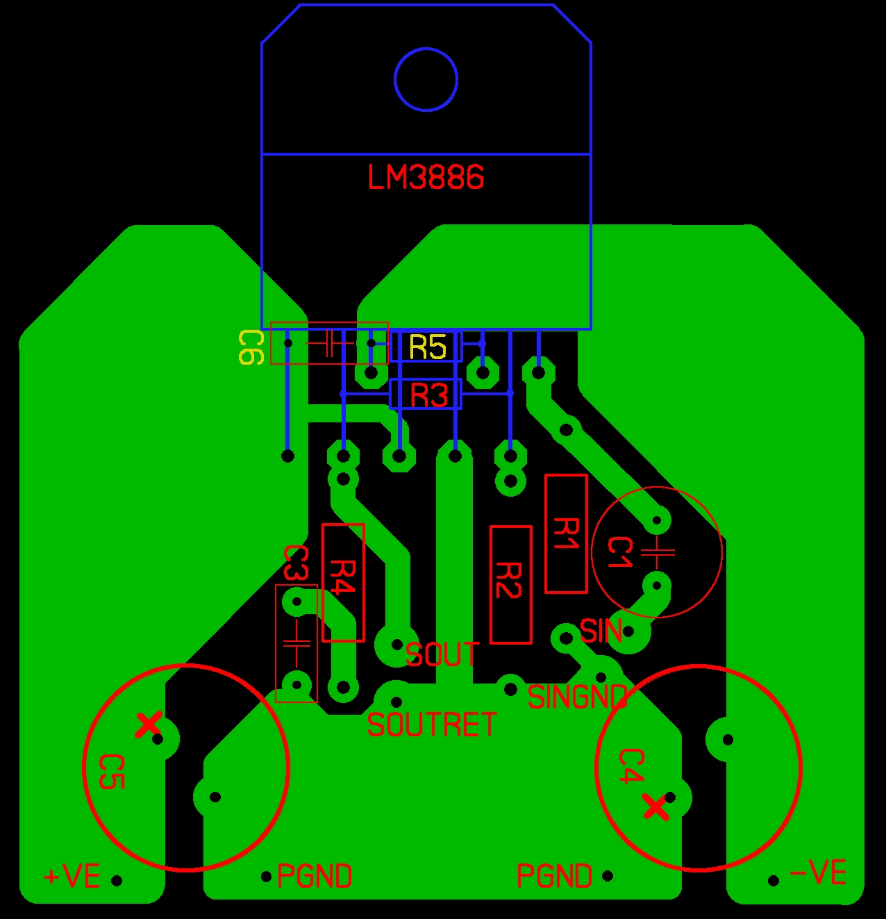

Hello there
This is the PCB pattern and the amended schematic to suit the LM3886. The Board is around 2” square or thereabouts. An off board Theile network will be used. The component values will probably be taken from an LM3886 schematic.
The LM3886 will be mounted to on the trace side once the pins have been bent to suit. Two resistors will be mounted direct to the appropriate pins.
Regards
AC

There are so many variations possible on this but a few things I would change...
1/ AC couple the feedback return. It is bad practice to DC couple and it will also cause higher than necessary offsets.
2/ A small air spaced coil at the output is good practice unless you can 100% guarantee any load attached would not cause problems.
3/ Add some kind of RF filter at the input.
4/ Doesn't the mute behave better with a suitable cap added? Look at the data sheet for examples.

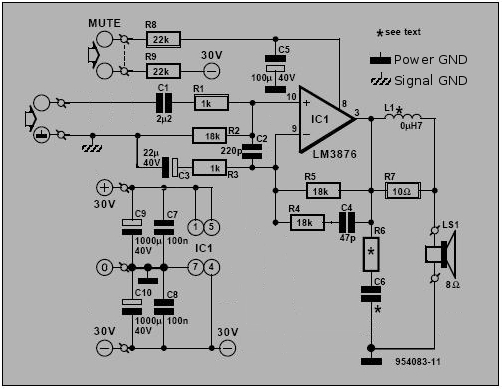

Hello there
Thanks for the pointers. Having got to this point I think it will be easier to add the components required and tweak the layout to suit the additions. See the attached schematic which my original ‘working’ set up was based on. I think this has all the points you mention above covered.
Regards
AC
