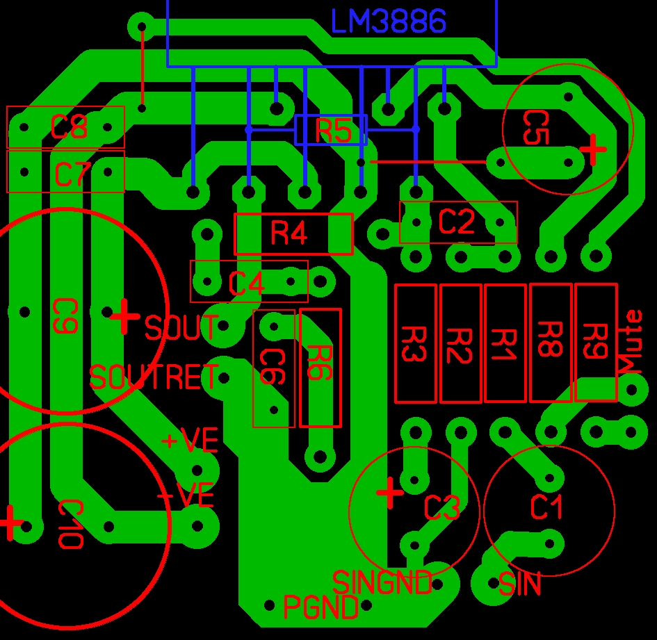

Hello there
I hope you all had a joyous Yule.

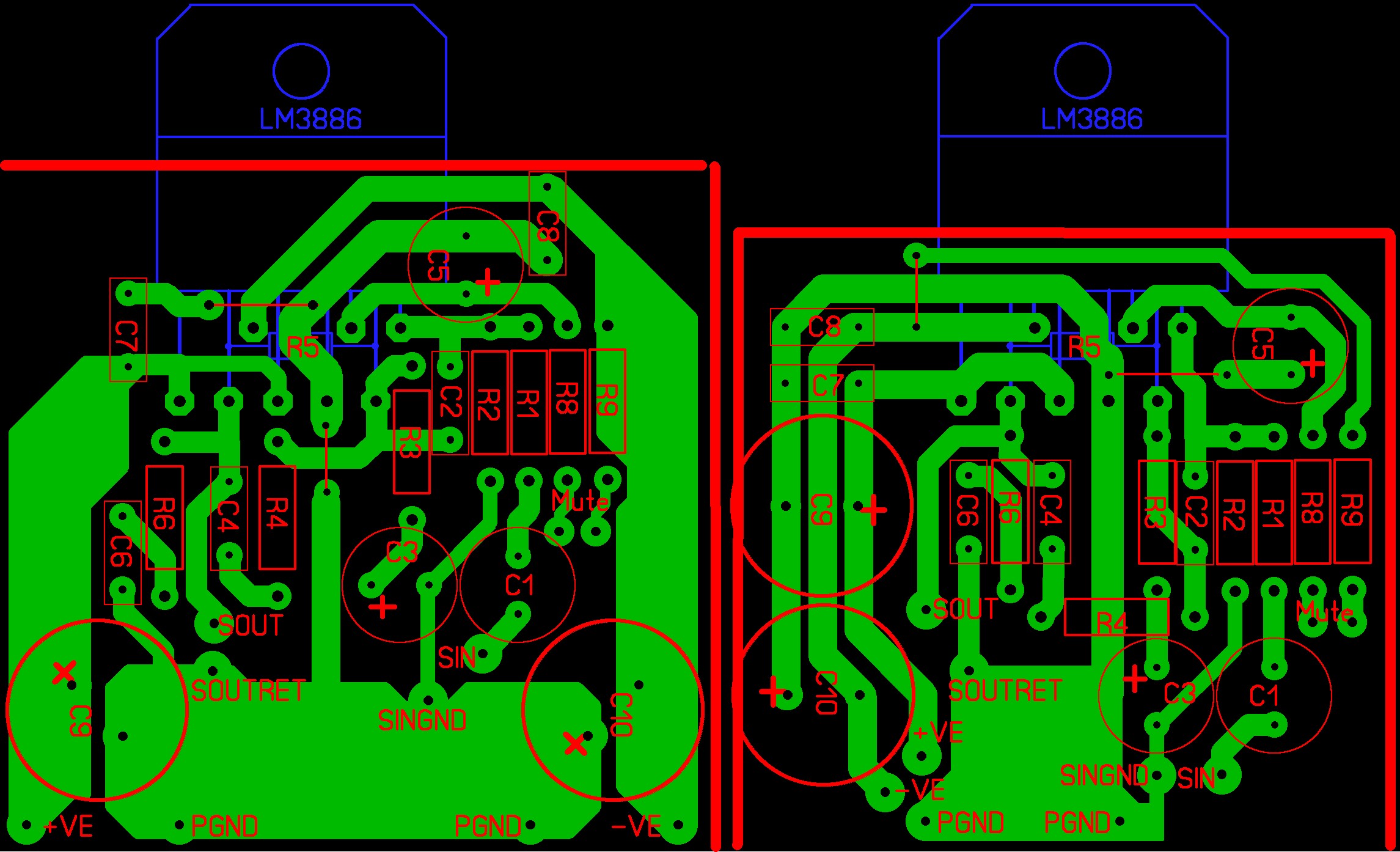

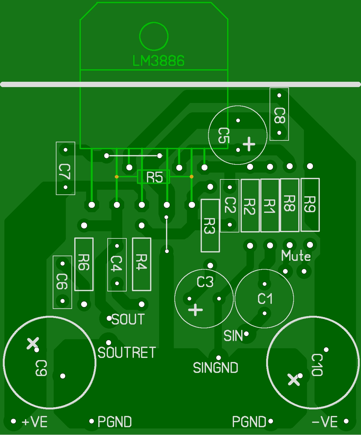

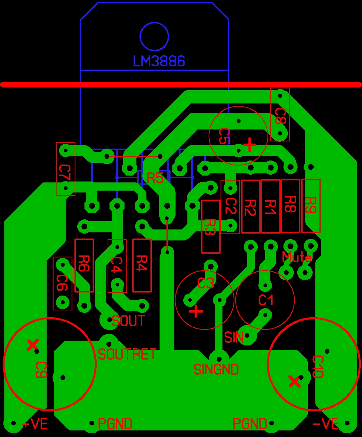

Finished the PCB design. Presented here for roasting. The chip will be mounted flat on the trace side. The board is around 48mm square.
regards
AC
PS Just noticed I haven't traced C6 to ground 😀
regards
AC
Often true, but this is a VERY SIMPLE schematic and layout.When correctly designed 2 or more sides pcb will improve the amp performances compare to one side pcb.
Extra complication does not provide significant advantage, if at all.
You still need to join top and bottom, so 2 soldered connections per via, that alone takes a lot of the shine out of the idea.
Compared to that, a few wire bridges here and there (IF needed) , are simpler/practical.

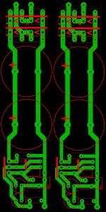

Hello there

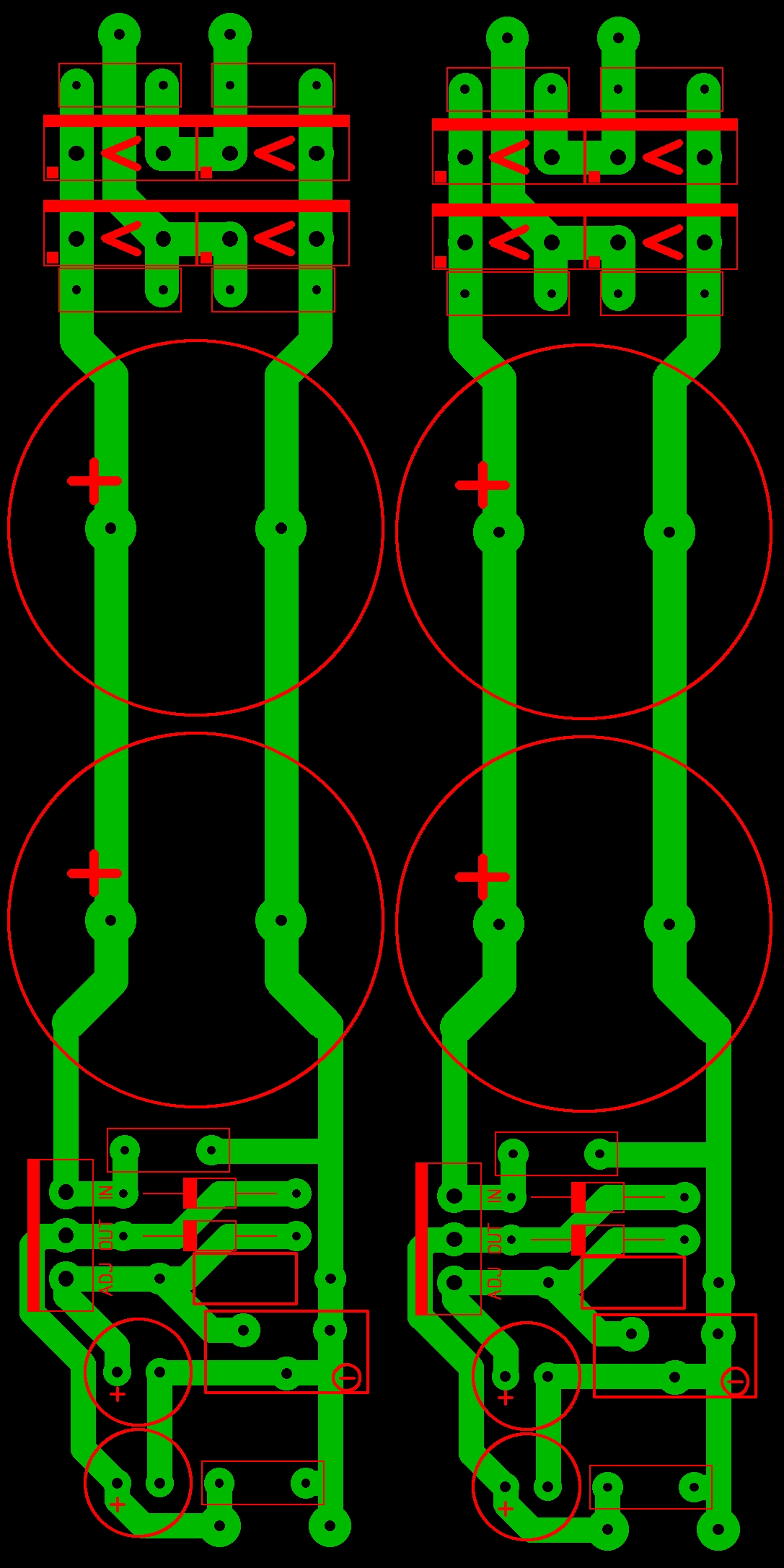

PSU PCB Sorted.

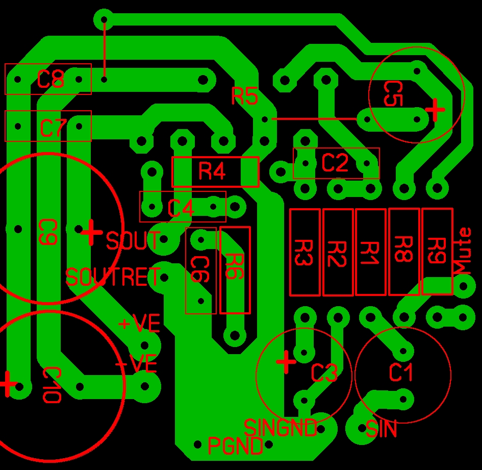

R6 (Zobel resistor) should be a 2 W type.
I suggest taking the ground for C9 and C10 south to the ground pour instead of all the way to pin 7 and south from there. The largest currents are the charging currents for C9 and C10, so reducing the impedance and "antenna" (loop) area would be good.
It looks like one pin of your input cap is floating when the source is disconnected. I'm generally not a fan of that. I would put something like a 470 kΩ to ground just so the cap doesn't float.
Tom
Tom

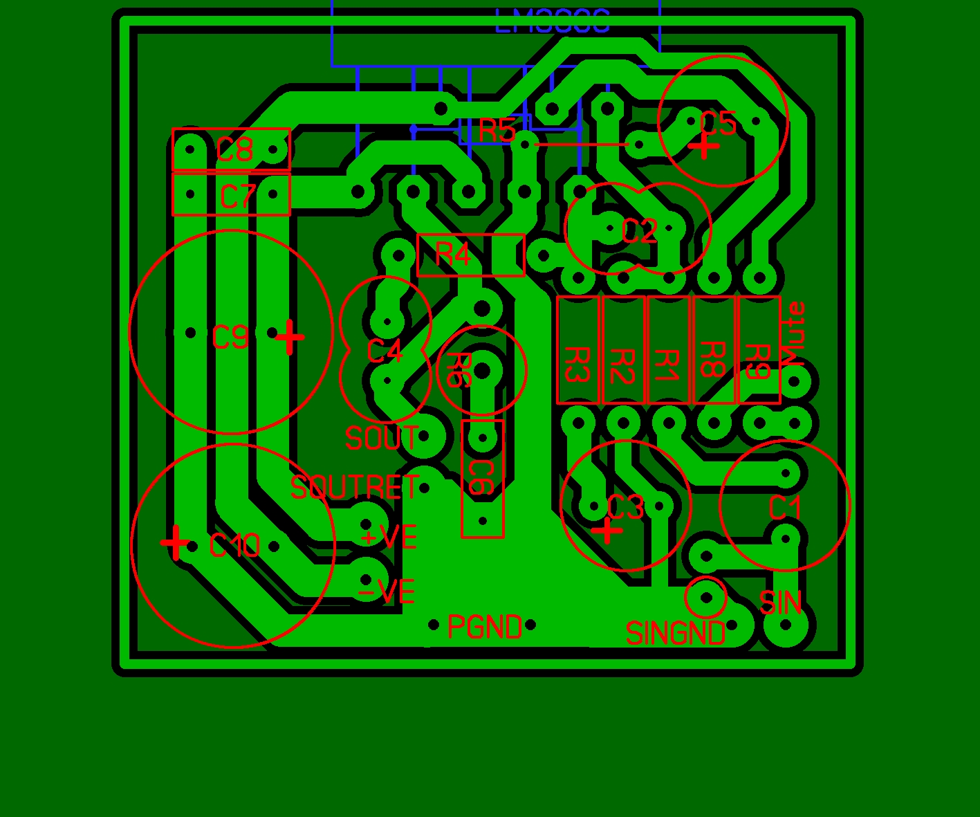

PCB Revision Bb
Hello there
Thanks for the pointers Tom. PCB tweaked as per your guidance. Also made the component outlines reflect the real world to avoid later issues. R6 is the 2W outline but vertical to save space. Do I need a ferrite bead on the long wire lead to avoid rf?
Resistor for grounding the floating input is vertical also.
Regards
AC
Hello there
