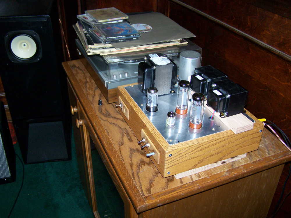

Ok, I have spent most of the morning wiring up the amp for basic triode mode with the transendar OPTs...
I powered it on - with sacrificial speakers and a spare iPod (hey it is a test) and nothing blew up. Once I realized that the iPod was totally useless as an audio source (it was wiped clean at work since we are using it as a video preview device) and I was satisfied that it didn't have mega-volts on the input - I brought it into my man cave.
First initial impressions were not exactly stellar. But that soon evaporated...
A little Stevie Ray, some Stones, a bit of Smokey - and a dash of Dire Straights later... Oh my.
This amp drives my Fostex FE166e horns to places its never been before.
Very nice George, thanks for the design work !
pics of the horror show of the initial build to follow... yes a few things that I didn't anticipate came up at the last second... we'll call it a beta test.

If you mount the PC board so that the tops of the tube sockets are flush with the top of the chassis, you don't have to worry about hole size. Just make the hole the size of the socket and no problem with any tube you may choose.
Are you planning any finish on that aluminum. I assume it is just mill finish and has no chemical finish done to it? Looks fantastic!

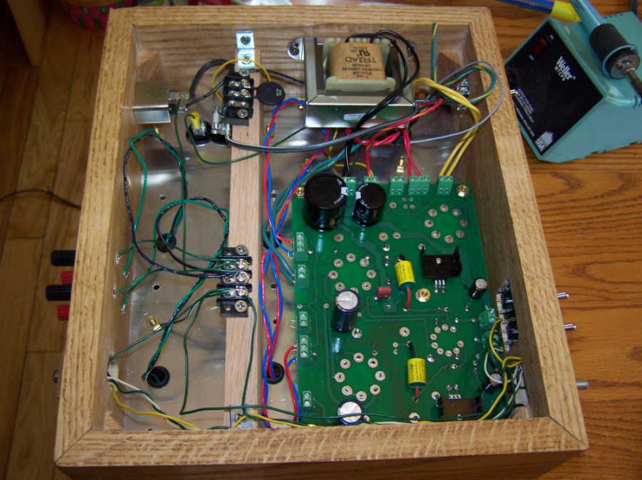

and a right side up pic.
You'll notice the ugly wood screws on the side of the chassis. Once I put the OPT's on the top plate the front part of the box started separating. The weight was just too much for the glue.
None of the switch plates are attached to the case, and it has yet to be varnished.
The damn thing sounds so good, I'm not sure I'll have the heart to take it all apart again.
