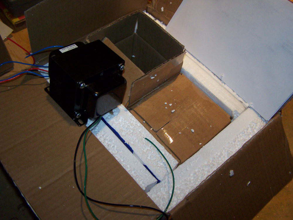

I received all of my parts on Friday, with the exception of the Edcor OPTs.
Couple of problems - both my own doing, first the channel coupling caps C11, C21 I had sourced on my own since I didn't want to do a separate Mouser order - and of course I didn't check the package size against the PCB. The vishay's were boxy and too short, and while I've made them fit - I might as well do this right.
So I'm probably going to bite the bullet and put in auricaps. Pretty pricey little buggers @ $10 for a .22uf, but luckily there are only two of them.
The second issue is that the 1500uf 6.3v caps for the voltage regs were backordered on Digikey until July! I have a source for 1800uf's or I can go to local parts guy and buy some 1000uf's...
Other than that the board went together easily.
I did find some transendar 5K opts on ebay - the pair went for $119, and I can get those pretty quick - so of course I pulled the trigger on those, so I can have some sound out of the amp while I'm waiting for the monster Edcors.
So this weekend I'll be building the box and cutting sheet metal for the switches, volume and inputs. With luck I'll be powering it on next weekend...

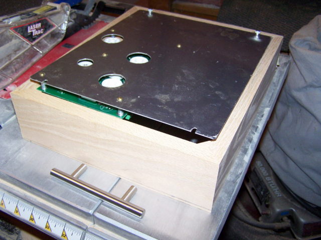

Here are a couple of pics of the build so far
hmm - looks like one attachment per message.

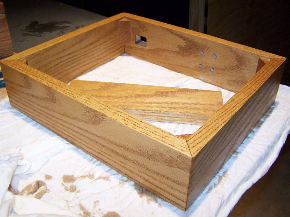

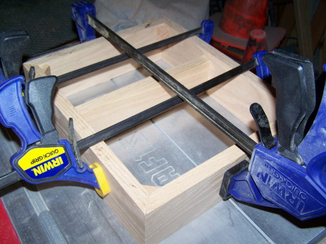

This is the box - red oak 1" thick (actually 2cm). The center support isn't glued, I'll be attaching the choke to this support as well as the fuse, current limiter and misc wires.
NBD. If you look at the right edge of the photo, you'll see where I had to cut out a notch in the wood frame for the RCA input jacks. This was by design - given the small size of the aluminum top plate, I wanted as much real estate as I could muster. Putting the RCA jack slightly over the frame bought me an extra quarter inch, which made the spacing around the binding posts (at the other side of the plate) a little more comfortable.
Yes, it's not a big deal... I'll get to it before I start the wiring.

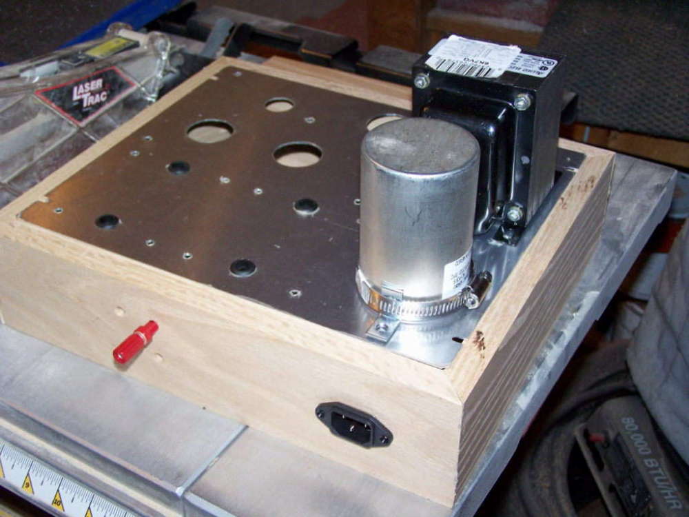

Finished the holes in the top cover - plastic is still on the aluminum, but I'm really hoping it is still pretty clean.
The IEC connector has built in line filtering - which I thought couldn't hurt. The speaker connectors will be screwed into the wood ... believe it or not this works pretty well and is very sturdy.
I need to make plates for the inputs, and the front panel (volume, switches and power light). I've decided that a machine shop can spit these out pretty quick and anything I do I'm probably not going to be happy with.

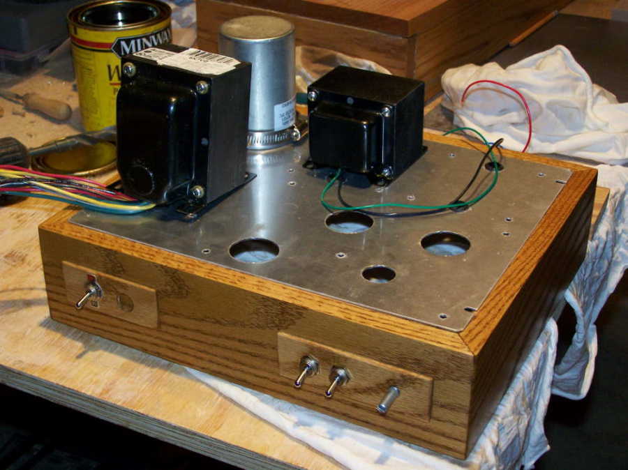

pic update of the day
Figured out how to mount the front switches - the blank hole is for a power led. I have a nice one that looks like it belongs on a guitar amp, but it uses 6V, and I'd rather not hack up the board for the DC...
So I'll go to the shack for a red AC light.

I'm not sure what you mean by mounting the MR cap bracket under the chassis. Right now the clamp holds 2 L brackets which are screwed to the top plate.
I was thinking that I could spray paint the MR cap black to match the transformers... might make things a little more pleasing and very easy to do.
