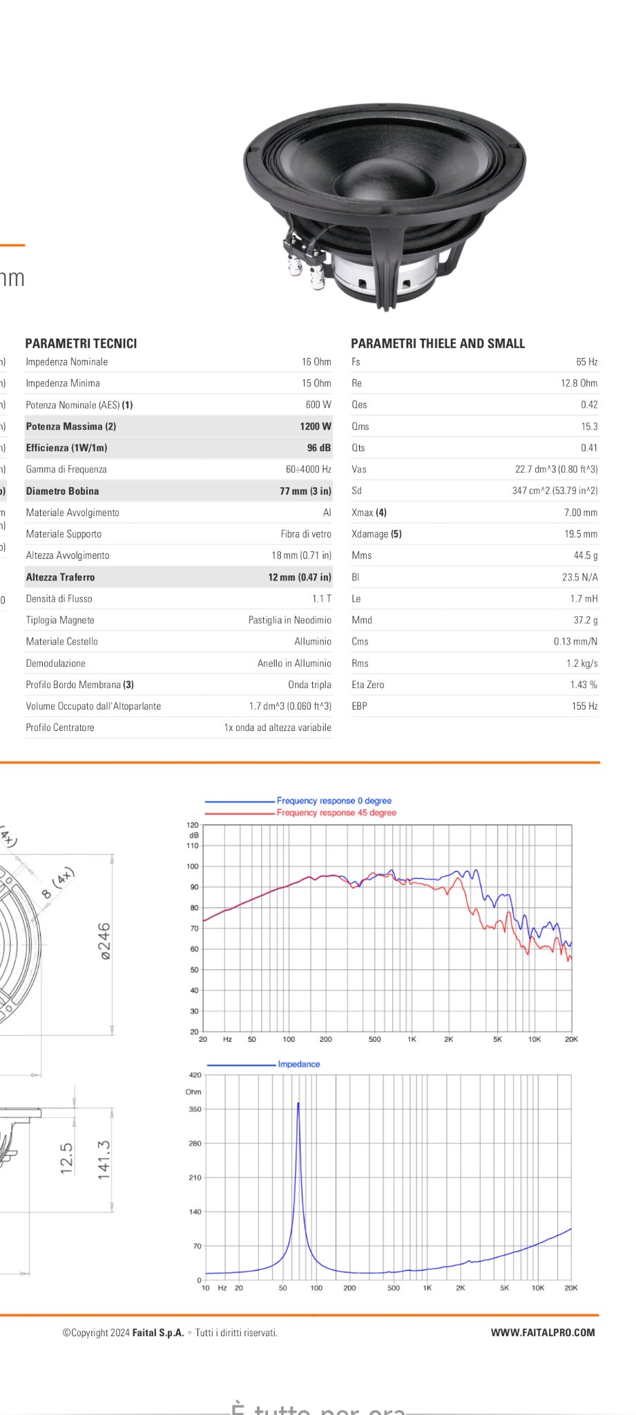

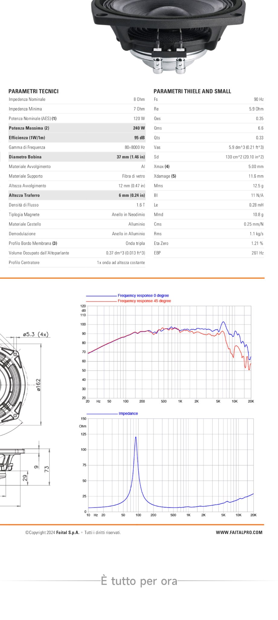

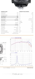

these are the datasheets of the transducers that seem excellent. Let's say that I took into account that the impedance remained fairly constant in the service range.

The faitalpro-10FH520-16 looks pretty flat from 100 to 2 khz with sensitivity of 96 db. The faitalpro 6PR160-8 looks pretty flat from 150 hz to 5 khz with sensitivity of 95 db. The very expensive beyma TPL-200 looks +-5 db from 2 khz to 18 khz with sensitivity of 100 db. The tweeter has a 5 db boost 1800 hz to 5 khz which could be toned down a little. Having two 10FH520-16 would boost senstivity 3 db over the 6PR160-8 which means resistor padding the woofers, which is a bad idea. If you do not intend to run above 600 w AES, I find the 6PR160-8 unnecessary. Cross the 10FH520-16 to the TPL-200 at 1800 hz, with at least 12 db/octave low cut on the tweeter. A set of traps could pull the tweeter down 3 db from 1800 to 5 khz. A series resistor of 8 ohms would attenuate the current on the tweeter by half, or - 3 db. Perhaps 10 or 12 ohms series the tweeter could knock it down to 96 db. There should not be a lot of beaming of the 10FH520-16 at 1800 hz. WIthout the 6PR160-8 you could return to the two series woofer plan for 98 db woofers, and resistance pad the TPL-200 down to 98 db also.
If you do use the 6PR160-8 I would filter the wiggles above 2 khz off, and low cut at 800 hz. The cross of the 15FH20-16 would again be 800 hz. Woofer would be low cut at 100 hz since you run a sub amp. 54 hz is only 10 db down so if you build a big enough box to boost the bass you could low cut there and turn off the woofer most of the time. However woofer AES 120 w would limit the size of party you could host. You would have to study cone movement at the lower frequencies to not exceed 5 mm Xmax at maximum power. Two woofers with AES 240 w is more party capable, although a 5 m square room is not a huge venue.
