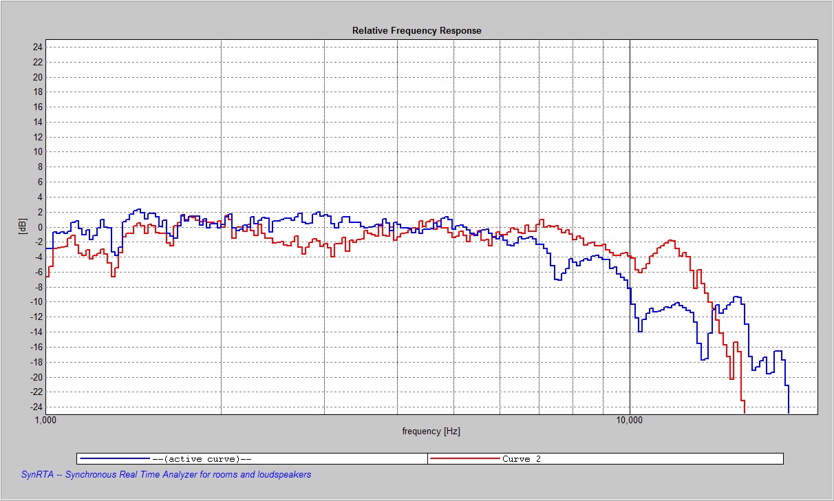

Here is the 1" PAudio 1" compared to the Emilar. Pretty nice response in this horn in my target range.
This is pretty impressive. 🙂

Which PAudio 1" is that.
A 340S P.Audio System Co., LTD

The P Audio drivers are really good for the money if you use them for live PA - never sound compressed, nice middle range but the ones I have fail the treble test with nasty upper treble spittyness and resonance - these were left over from a big modular horn loaded line array system I built for a local band 🙂
