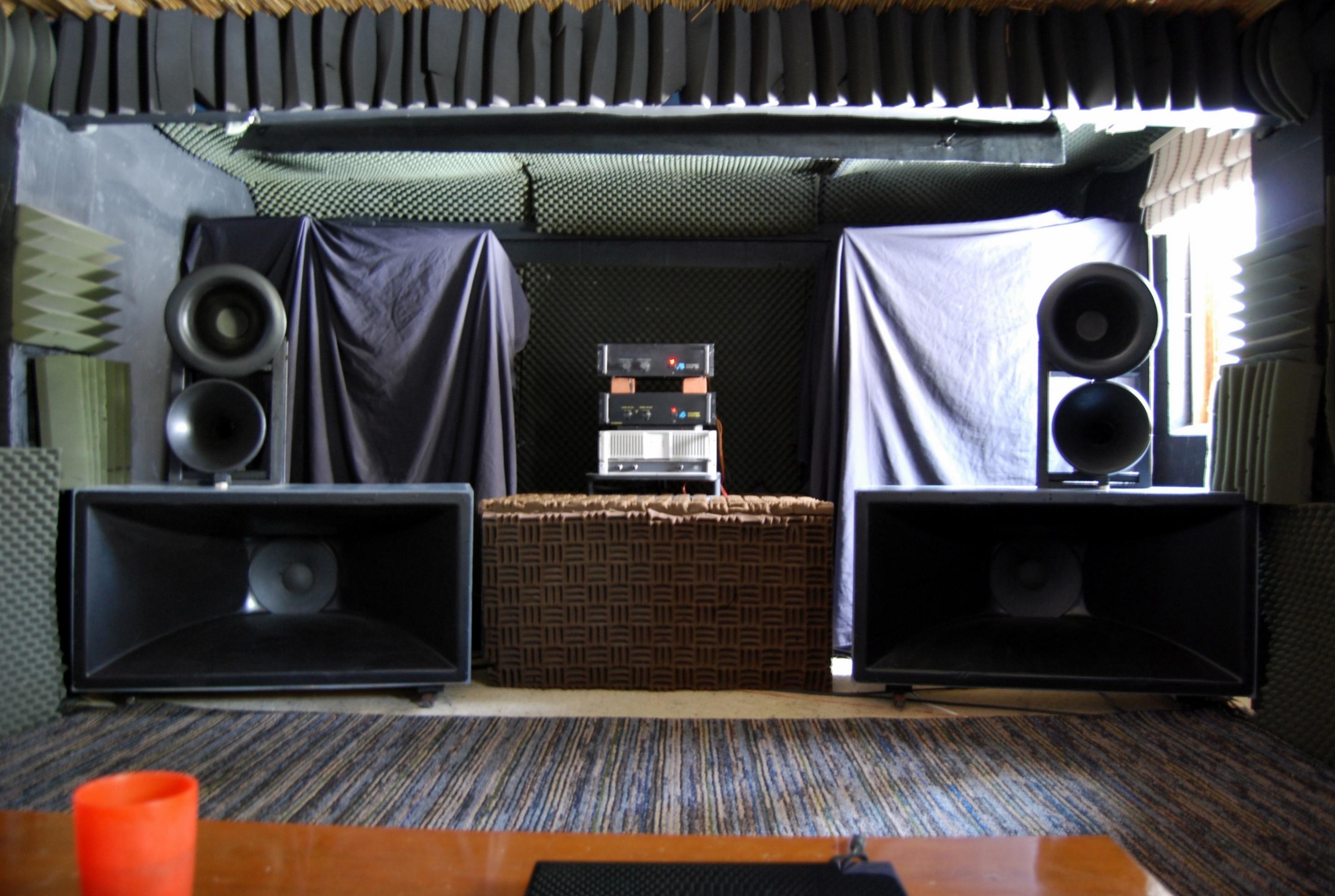

I'm doing the final tuning on the Stargate 6 System
The satellite horns from 100 cycles up are centered on the JBL CMCD cone midrange compression drivers, That are quite spectacular in what they do in a horn system where we always have a longing to extend the midrange horn to cover the lower midrange through the vocal range but come up short using conventional compression drivers and cones. Most large format compression drivers even in the biggest most awkward horns barely make to 500 cycles and are weak below there leaving the listener with bleached out, distorted, unnatural sound lacking in tonal density and natural fundementals. The cone loaded mid drivers have the opposite problem with the cone breakup, lack of phase plugs, mass roll off, and general lack of upper range presence, power response and dynamics. The JBL CMCD81H is the answer, It addresses all the problems with the traditional compression drivers and all the problems with horn loaded cone midrange drivers all in one sleek package. Load it in a good horn and mate it with the appropriate bass, upper midrange and treble horns and you will have world class playback. Beyond the whatever...

hello, I'm posting the horn system here right now. For the critical range 80 to 300 Hertz I am using a straight expo horn with 250 pounds of sand in it's enclosure. The driver is the Electro Voice EVM15L - the EV15L is a great driver in these horns and in this range it's probably the most efficient 15" driver on the planet. This is one of those things you have to hear to understand what it can do. Getting that range right takes a straight horn and lots of tweaking in my experiance - once you're there or close it can sound so real it will literally scare you.

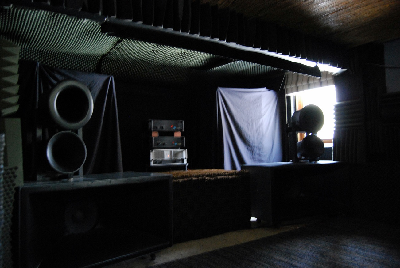

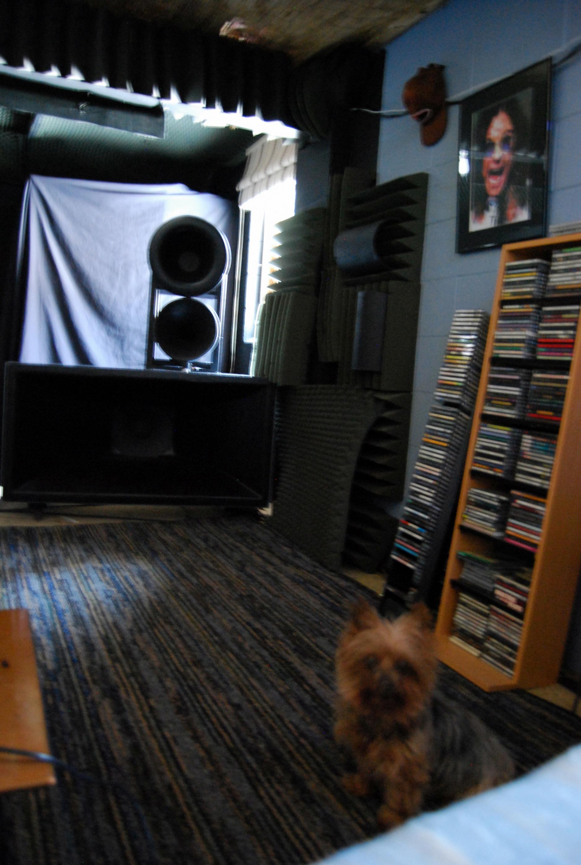

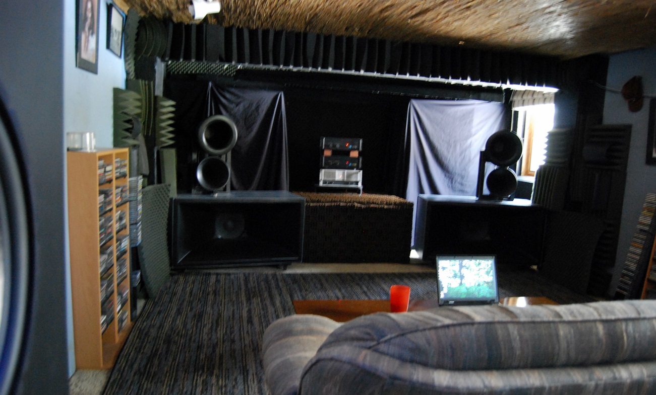

The midbass horn enclosure is 24" by 24" by 47" wide. They are filled with sand and are loaded with Celestion BX4085 15" bass drivers. The BX15-4085 is chosen for its pure sound and low distortion. In the horn it's not quite as efficient as the EVM15L but still around 107 db with a watt.
I use the midbass horn 120 to 300 cycles (plus minus 1 db at 4 feet) then handoff to the JBL CMCD81H 300 to 2K then the top is the Celestion CDX1-1425
