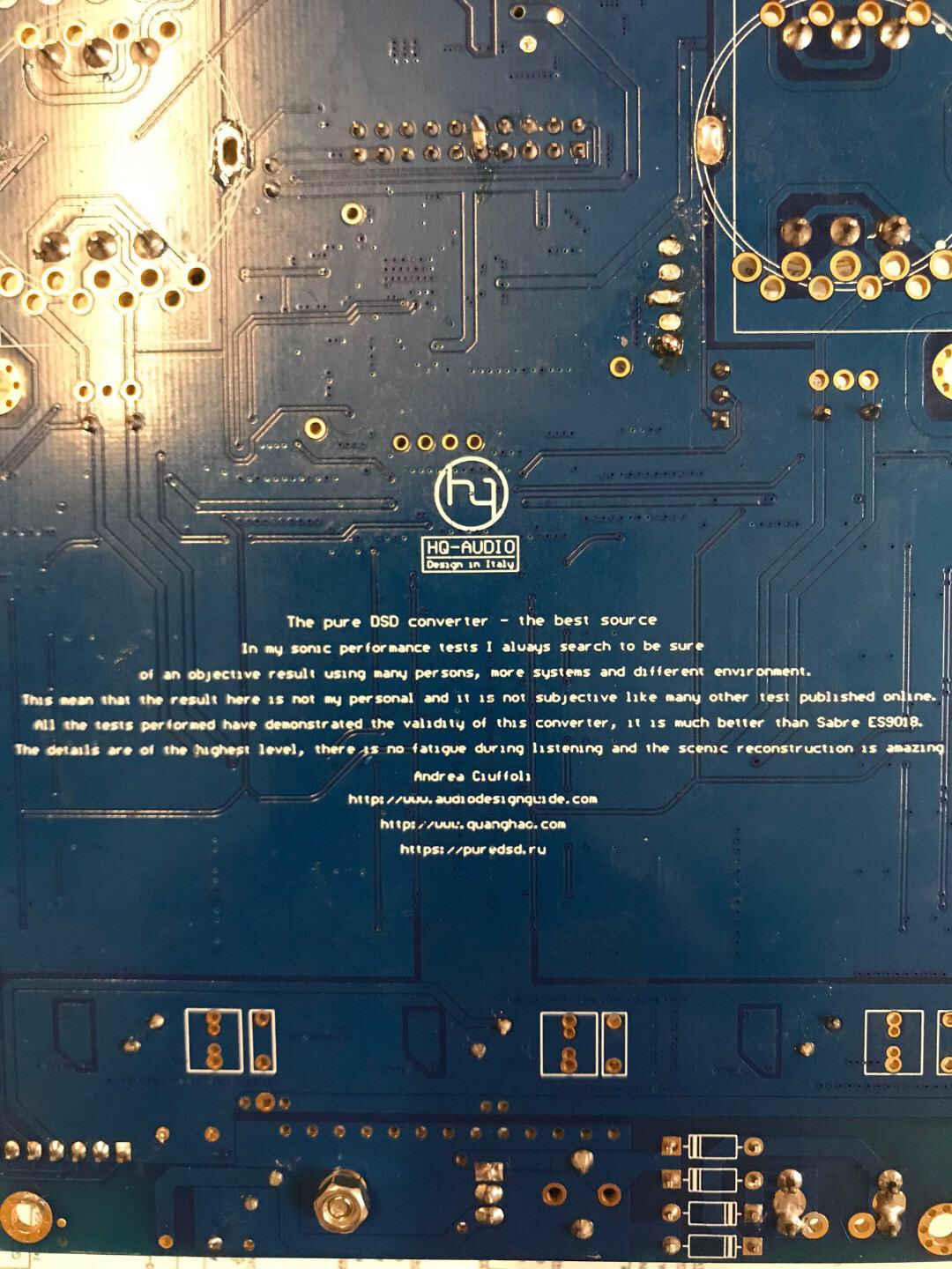

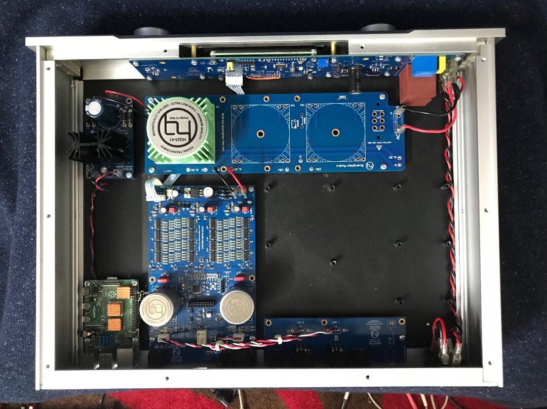

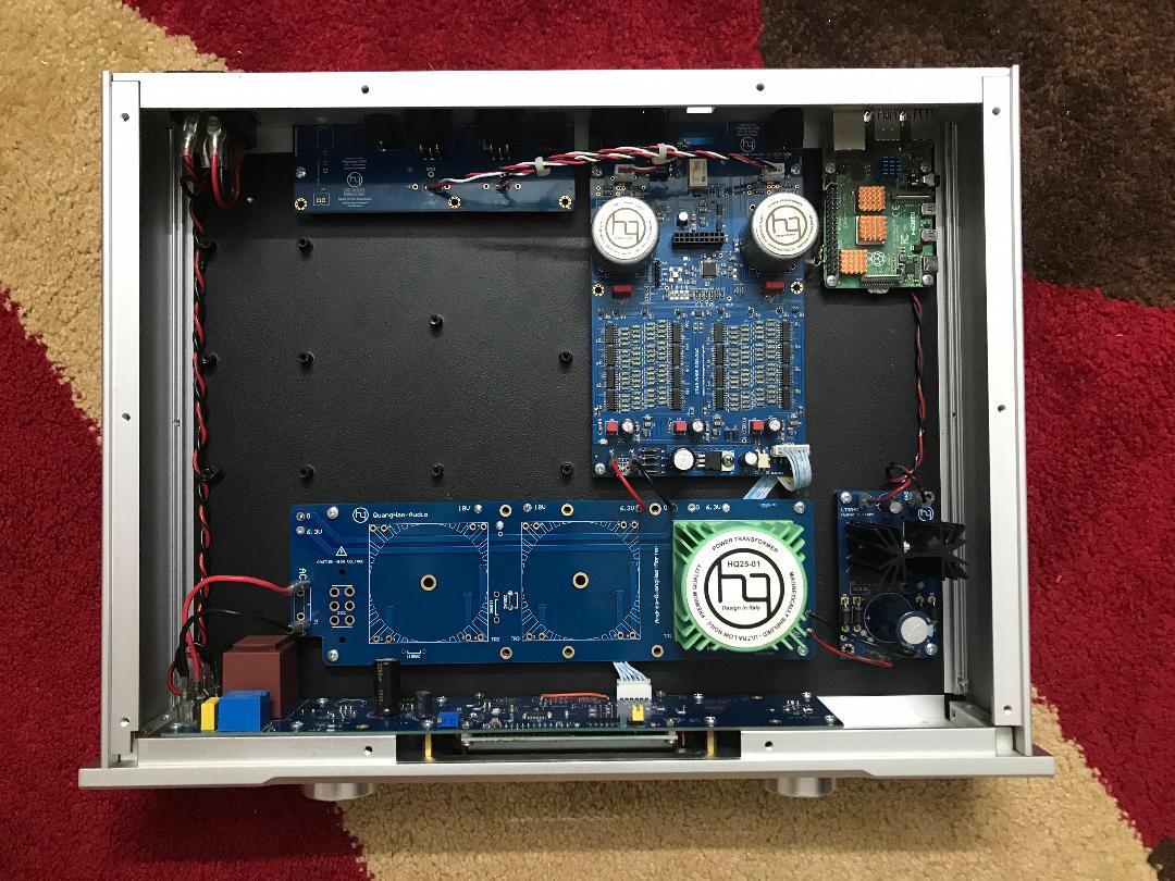

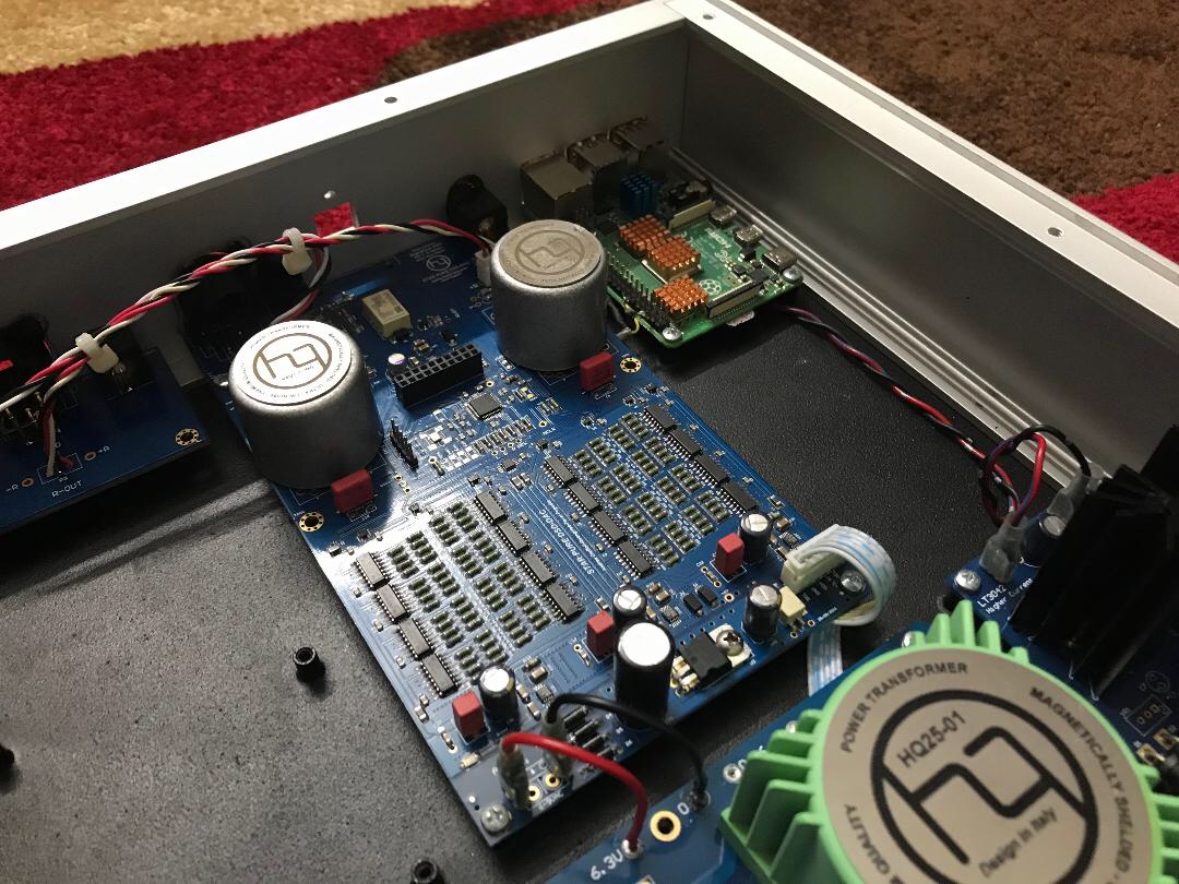

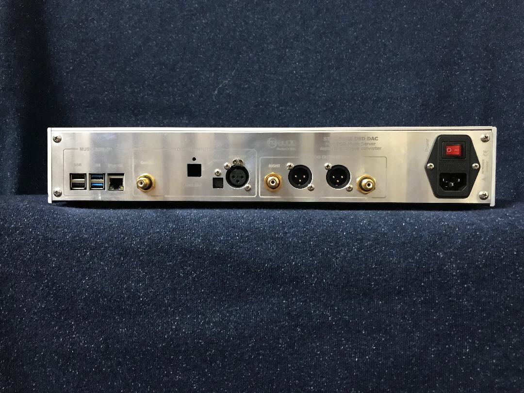

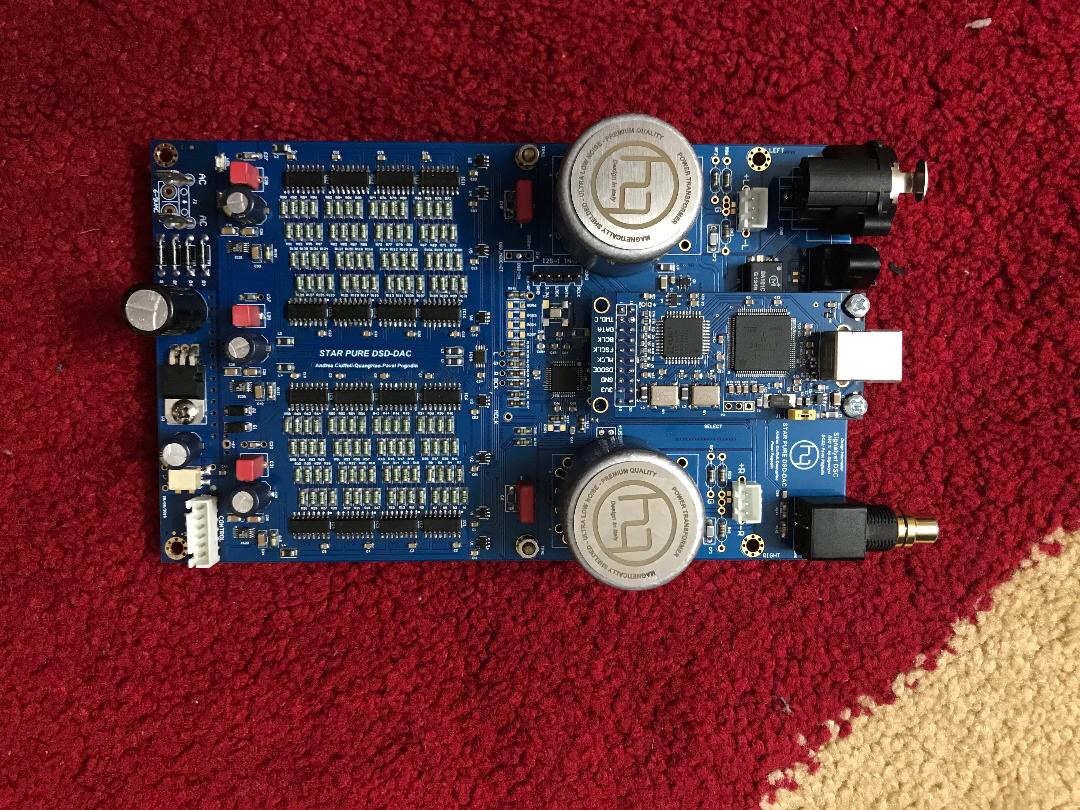

Some image I make it, please see it now.
Thank you very much!!
