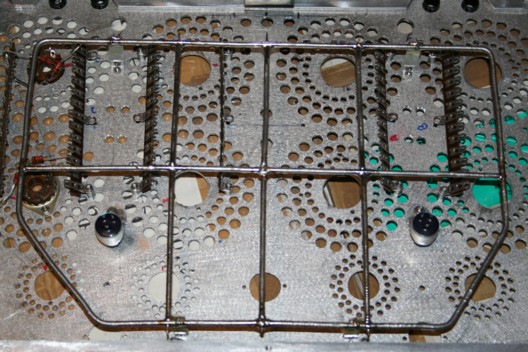

salas said:Don't forget the matrix buss bar solution.
Is that where you wear a long leather coat and indulge in a lot of violence?
Wish it was so sci fi! Its actually what richwalters always does:
''For over 40 years in amp designs I have always used a closed earth loop concept and it works. Pic of 3.5mm bus interconneced in grid form shown for 2x150W stereo using parallel o/p pairs. With this closed bus one can be rest assured that both sides will perform symmetrically with excellent 15Khz separation performance at full power and hum isn't an issue.
Using a chassis with tags, they nearly always work loose.
richj''
