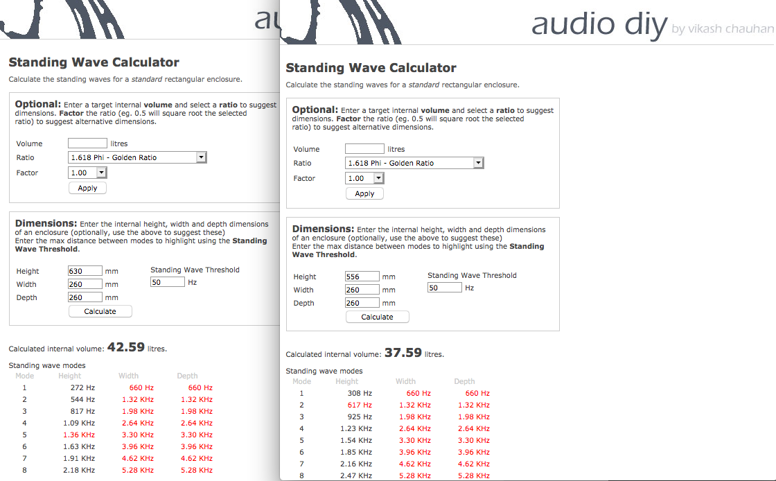

I’m building my first subwoofer and currently finishing assembling the panels.
Yesterday I read about standing waves and that squares and cubes were to avoid when designing a subwoofer.
My enclosure is already cut to size and partly assembled following my design of a ported, down firing sub with a square base (and the driver is to be mounted exactly in the center of this square).
I’m not worried about the panel vibrating, I ordered 1in thick mdf for it (I didn’t realize it was going to be that thick), but reading about standing waves yesterday worried me.
My internal dimensions are 26cmx26cm for the base and 63cm high (the slot port is at the top, 55.6cm from the bottom)
Thanks again for your help
Sounds about right. This calculator shows the first mode at 308Hz for 55.6cm height, 272Hz for 63cm height. Your box is actually only 55.6cm high, so the lowest standing wave produced would be around 308Hz, disregarding the cone and open area of the port breaking up some of the standing waves.
