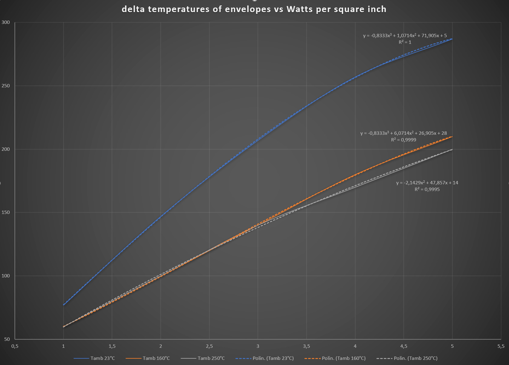

Thanks cerrem,Just a few observation to keep in mind... Idle plate dissipation may be really hot in some amps, however, when running signal the plate dissipation can be much lower...
I know better musical instrument that hi-fi amps, and indeed EL84s are the most abused usually (higher plate and screen voltages, higher idle power, etc...). This is not my case, as I usually stay around 60 to 70% idle current for AB fixed bias, and 80 t 90% for cathode biased "class A".
Totally agree, maximum plate dissipation is not at idle nor at full power, as it is expected by the intersection of the load-(quasi)line and the "W = V x I = const" ellipse. On top of that, guitar amps often intersecs twice the maximum plate dissipation, just because the avarage is within specs (almost half of the time the tube is off).operating voltages are totally different than idle...therefore the average plate dissipation will be much lower than idel..also taking into account the load-line path...is not linear ...elliptical ..
