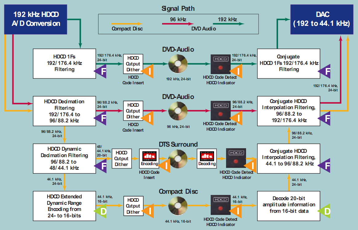

I try to understand the HDCD filtering process ("Conjugate HDCD Interpolation Filtering, 44.1 to 96/88.2 kHz" in attached picture)
Attached is the resulted FLAC file after was decoded by ZR36732PQC ...
For analysis the 24bit/88.2kHz file is necessary.
