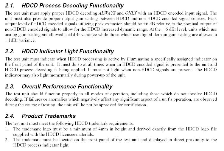

HDCD Equipment Approval Procedure
hello rossl,
I saw your unit, it's very cool one!
In particular, I think you choice 2X oversampling is very nice idea. Because you can evade the weak point of 3stage cascading oversampling digital filter like PMD100.
By the way I would like to you 3 questions.
In 1996, Pacific Microsonics, Inc released to HDCD licencer, "HDCD Equipment Approval Procedure Sheet".
In this sheet, there are some guidance of function testing method.
Now I have this sheet, but now PMI sold HDCD business to Microsoft.
My Questions
1) Do you know Microsoft member who submits this documents?
2) Do you want this document?
3) Do you want HDCD logo mark?

Hi nagaesan,
I am violating 2.1. of the licensing agreement that requires redbook CD data to be supressed by 6db. The scale button on my unit allows the user to either comply with the requirement or to turn off the "scale" and violate the licensing.
I have found that the requirment is not necessary and its only purpose is to make HDCD material artifically sound better. After several weeks of listening, I find there is no advantage to turning scale "on" and making the unit comply with 2.1. of the licensing agreement.
Turning on the scale lowers the signal of Redbook CDs by 6dB and lowers it closer to the noise floor of the listening system. This is unnecessary.
HDCD material, after being decompressed by the decoder, will have an average of lower overall volume. This is easily compensated by turning up the volume control. The higher dynamic range clearly makes these recordings better than Redbook and there is no technical need to artifically depress the Redbook data.

If a sound is small, we hear a sound badly. And if sound level is difference, we must controll volume, it is troublesome.
I know you do not want using PMD100's Gainscale function [Digital Domain -6dB] because always you want using fullscall of DAC-IC.
But, PMI forgives "Gainscaling function with analog stage".
For example, in case of MarkLevinson No.30.5L, this was Analog Gainscaling. No.30.5L had a Gainscaling infomation output.
This is No.5 pin[GAIN] output, and connect to MarkLevinson's pre-amplifier.
But in the case of me, I am using Digital Gainscaling.
D/A converter unit is DAC-1.5 of The Parts Connection.
The original DAC-1.5 is fixed No.5[GAIN] and No.19[SCAL] position.
I also want using DAC fullscale, but I don't want level changing when playback PCM/HDCD.
So I attached GAIN/SCAL switch on the rear panel.
By the way, do you know "full-scale output level" is difference" PMD100 and SM5842AP?
Please check "fullscale" square waveform on TEST CD with your cool HDCD decording unit.
