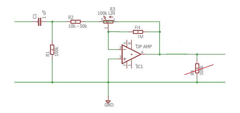

This is imho the way to do things.
You need no capacitor on the output, voltage there allways zero.
To prevent circuit to be offset by an input voltage the capaitor should be there.
A resistor from the out to the minus-in keeps the output at ground level if the wiper fails.For OpAmps with fet input it may be much larger (10M).
And don't forget, the input series resistor includes the output resistance of the source.
Mona

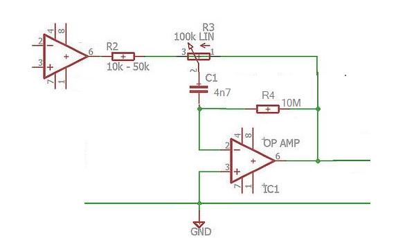

Thanks for the great input Ketje.
De-coupling cap for an inverting op amp is different from a non-inverting. Updated circuit below.
Now the question is if I should have a non-inverting buffer in front of it. Both for impedance reasons and making sure the thing is quiet when it's not powered.
Total component count for a stereo version is now ten, using a dual linear pot, a dual op amp and the two op amp bypass caps not shown in the drawing.
I'm using R1=50k ohm, which gives a max gain of 6 dB and a cut-off frequency (-3 dB) of 3.18 Hz.
Here are the gain curves, dB and voltage, from 0 to 100% turn of the pot:
You can also get rid of that fat capacitor like this 😀
An important thing to remember also is, you must use an op-amp that is unity gain stable for this kind of circuits.

Yes,
My question was sorta hidden in there.
I wondered if I should add a buffer in front of the circuit. Partly for impedance reasons, and partly for making sure the thing is quiet when the opamp isn't powered.
Still, there's the DC component to worry about. Isn't it? Won't that buffer happily amplify any DC fed into it?

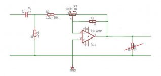

How about this? The cut-off frequency is 1.59 Hz:
An OPA2134, for instance, should be unity gain stable with proper use of bypass capacitors. Having a gain of 2x would absolutely fix any instability problems, giving the circuit a total max gain of 12 dB.
Should do for a FET input OP; a bipolar one may require something substantially lower in value. Typical input bias current for a bipolar is in the order of 50-500 nA, and even a part with cancellation circuitry may not be any less critical (e.g. LM4562 start-up trouble in single-supply applications).
Would changing these values make the circuit more universal?
R1: from 50k to 5k
R2(pot): from 100k to 10k
R3: from 10M to 1M
C1: from 4n7 to 47n (to preserve the cutoff frequency at 3.39 Hz)
EDIT: New schematic, cleaned up parts numbers
