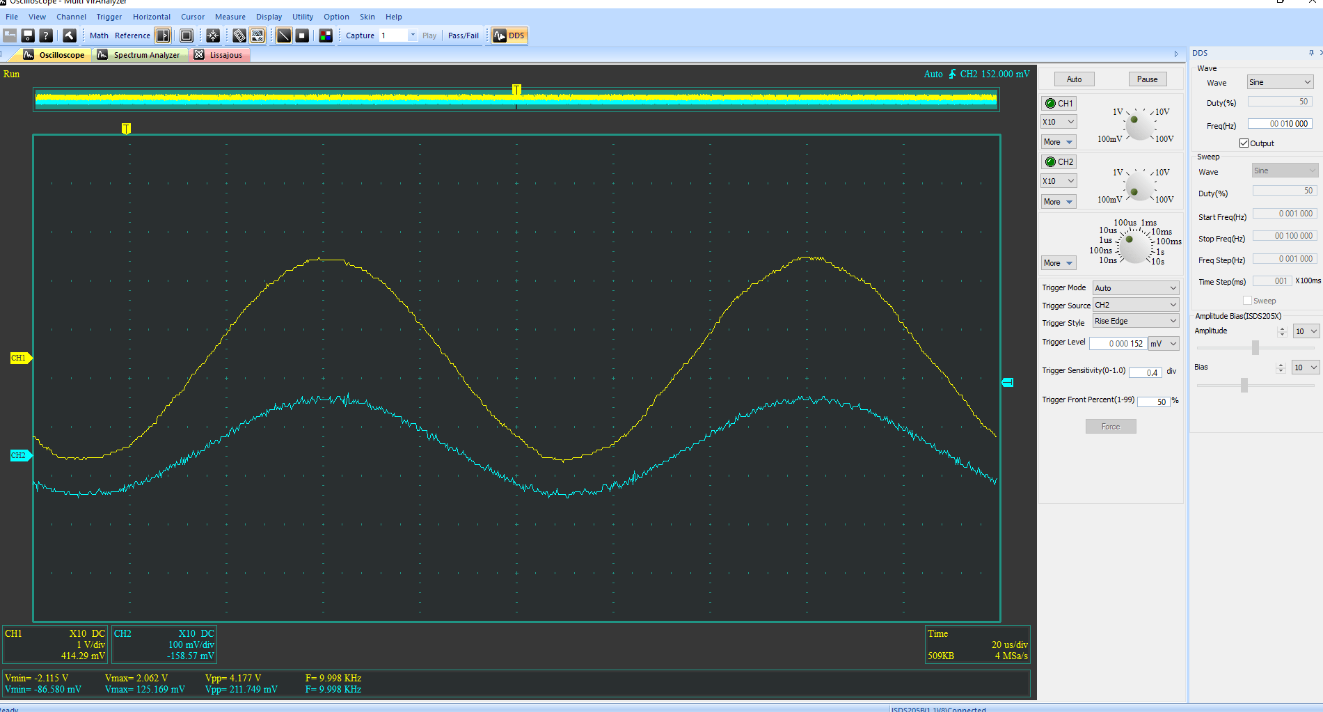

Similar observation to Grauwacke post 54The unwanted signal superimposed on the output seems to be about 68 kHz. Maybe that'll give you some ideas?
The only thing that I can think of that would run at such a frequency would be a switchmode power supply?The unwanted signal superimposed on the output seems to be about 68 kHz. Maybe that'll give you some ideas?
There is of course 2 lcd screens running on the same mains circuit as the computer, which surely use smps.
Or perhaps some noise from the computer itself?
I remember a professional designer spent a lot of time trying to revolve a noise issue which disappeared when an manager in an adjacent room turned his computer off before leaving for home.
Are your traces any different to Sadfaces ones?Have same issue with my two led lights, they turn up on oscilloscope traces.

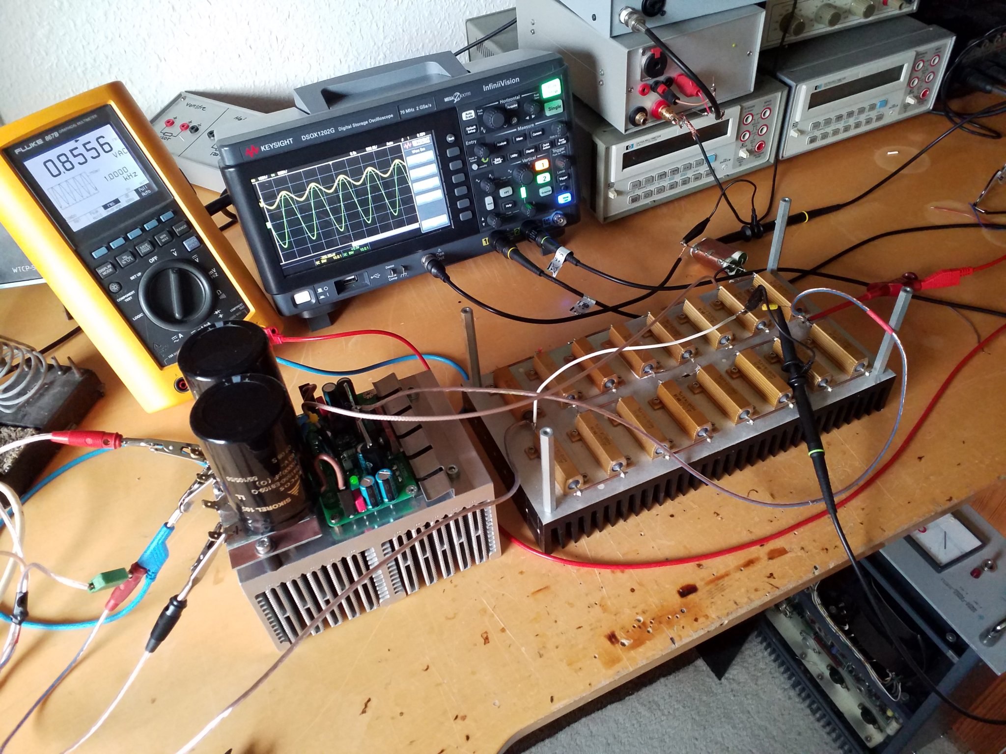

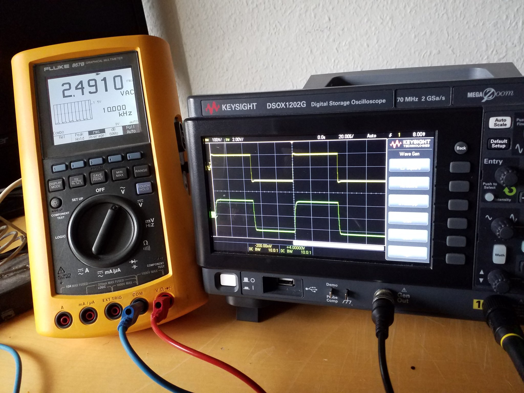

So I did some further testing last night.
Both channels look stable to me on the 4R load that proved to be the demise of my first P3A attempt.
So i started adding some capacitance in parallel with the 4R load.

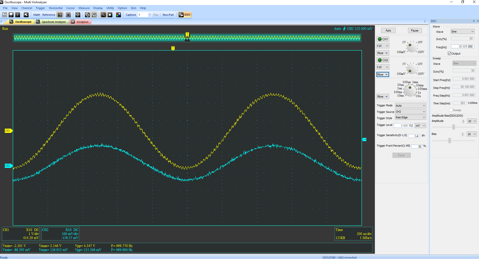

Both channels behave the same so I won't bother posting both channels. This is 4R + 3.3nF
1kHz sine wave
1kHz square wave
10kHz sine wave
10kHz square wave.
Whilst there is quite a ring at the output visible on the square waves, it is visible on channel 2 at the input so I don't think this is the output stage ringing but merely reproducing what is at its input.

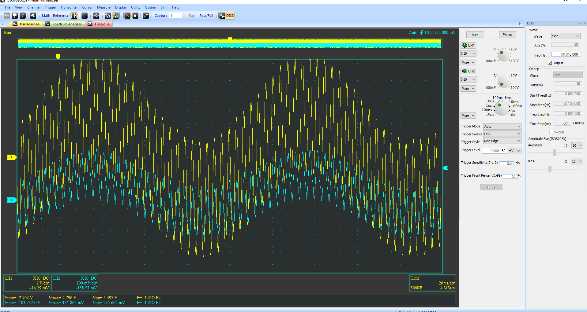

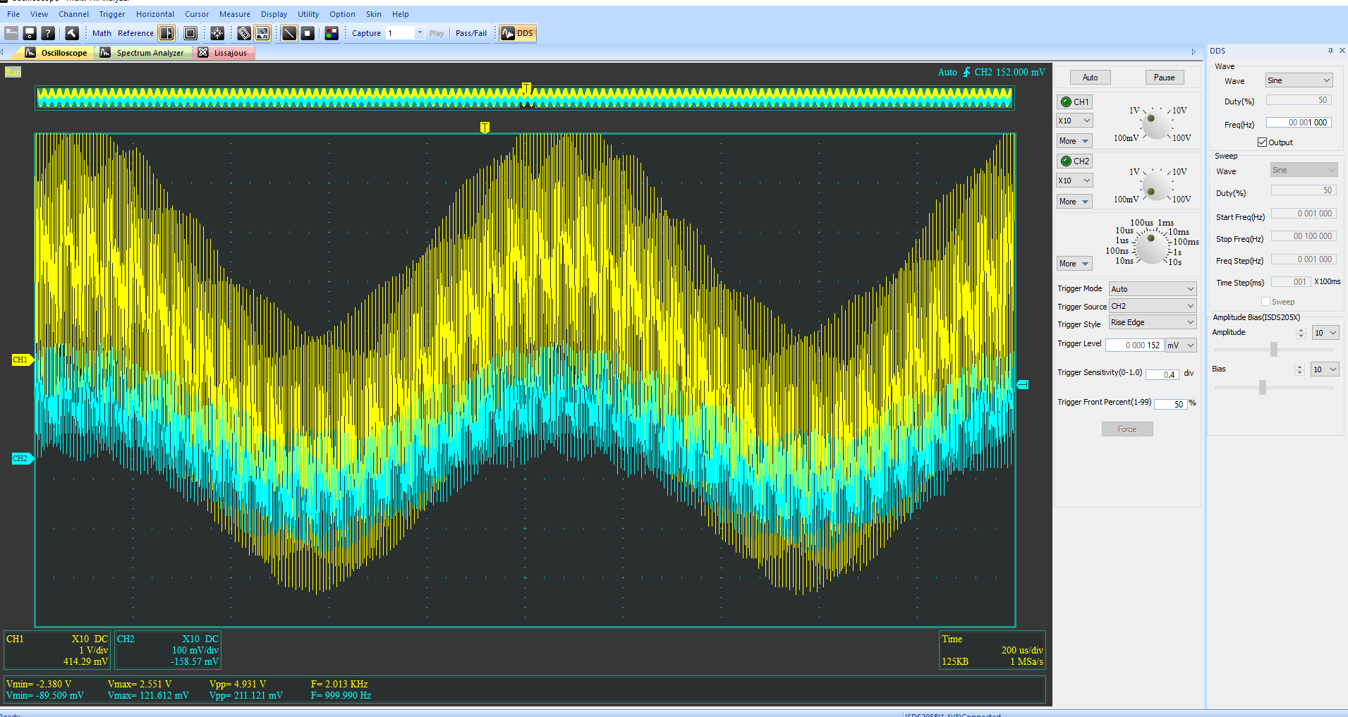

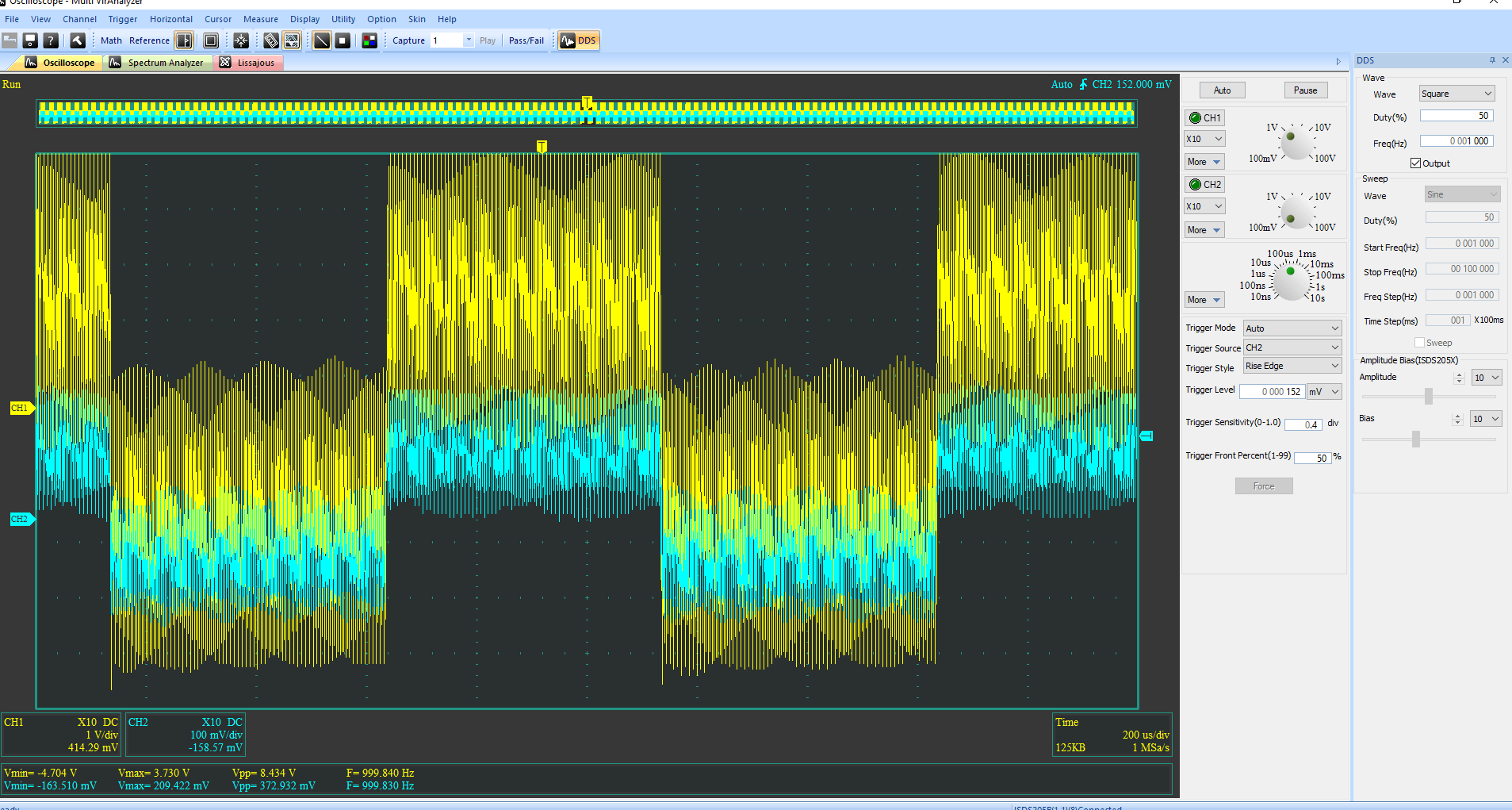

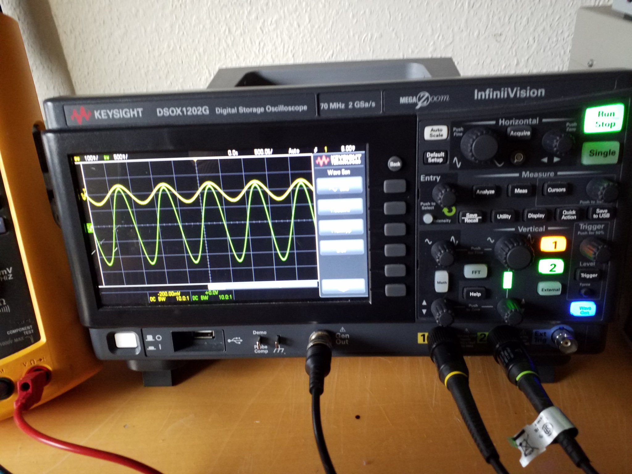

I think went to 4R + 150nF and got this.
1kHz sine wave
1kHz square wave
10kHz sine wave
10kHz square wave.
I noticed that on the really bad looking traces at 1kHz. The input and output voltages have a 27db difference which is exactly the expected gain of the amp.
If the output were oscillating I would think I would see a larger signal at the output. I saw this on the first attempt that clearly was oscillating back in post 1.
So if I am not missing something here, it looks to me like something is interfering heavily before the input of the amp and the amp is merely doing its job of amplifying the terrible signal at its input.

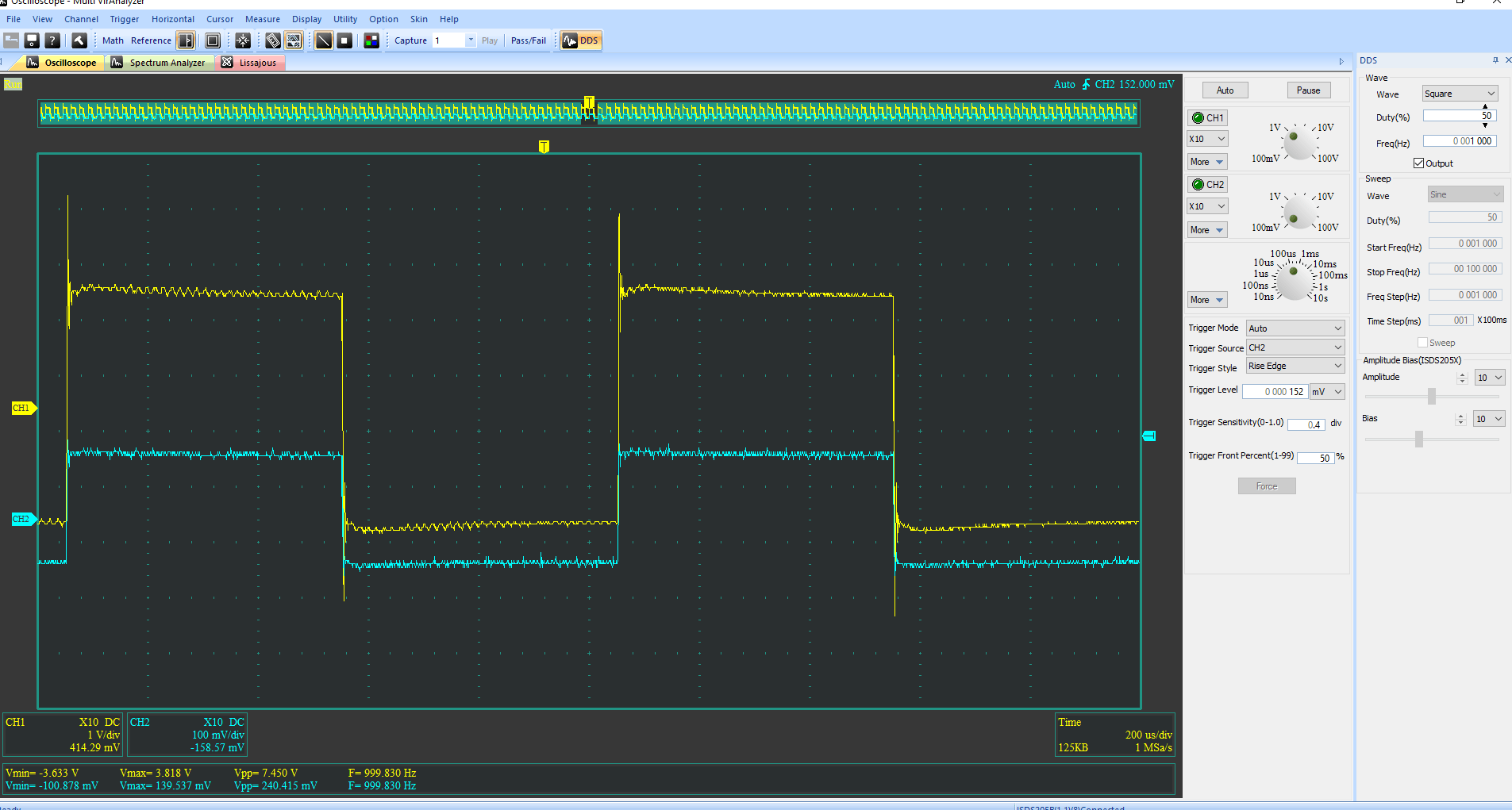

Yesterday I did post some square wave measurements over in p3a long thread.

So far no likes, I don't share your optimism.So I did some further testing last night.

If you have another amplifier you could have something objective for comparison to see whether the problem is due to your test equipment or this amplifier. The 4R +150nF images look like abstract art. It is hard to see your test equipment is the artist.
no improvement compared to post 1 graphs
maybe you have a compensation issue since its oscillating badly with a cap

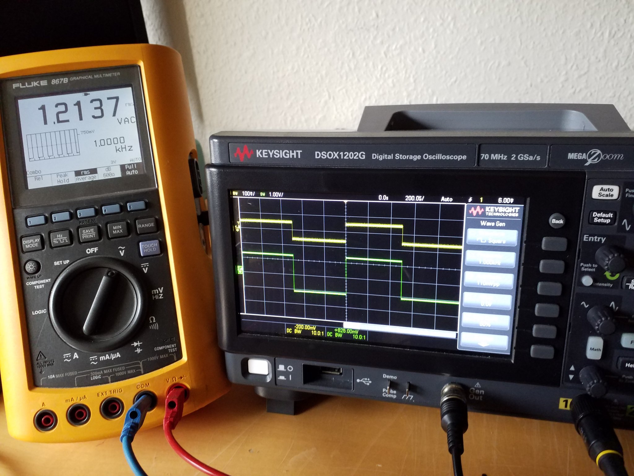

I did the 4 ohm with 150nf across load, it was quick and dirty, took it all apart yesterday, testing done, so this setup is powered by two switch supplies, and the 20000uf.
Looks clean enough.
3 first 1khz, last 10khz
Looks clean enough.
