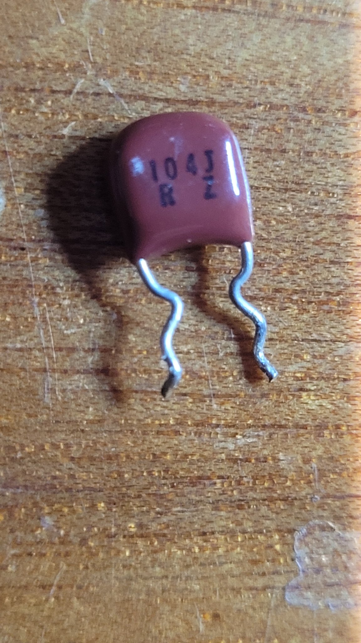

Need I worry about the voltage rating of the cap across C to E of the bias transistor Q9?
I salvaged some 104J film caps of an unknown voltage rating from a faulty CD player.
They JUST fit underneath the board without fowling anything.
no, that bit of the cct has only a few volts across it.

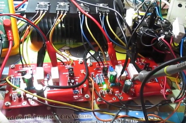

G'day Guys,
BD139/140 arrived and installed.
0.1uF film caps were soldered across Q9.
The first round of tests as per Rod's article have been passed:
1) startup with safety resistors
2) Left channel 2.5mV dc offset, Right channel 12.0 mV
3) test with test speakers: Music comes out of the speakers.
There isn't enough time left this evening for biasing. Time allowing, tomorrow I will bias up and start testing on the scope.

I set the bias over a period of 45 mins.
I set the bias to 25.0mV. Bias was stable within +/- 0.1mV over 10 mins after being set.
The coupled pair of Q6/Q9 is running at about 40c according to an IR thermometer about 5cm from the transistors
The outputs are sitting at 32c.
Dc offset was 3.3mV left channel, 16.7mV right channel after biasing.

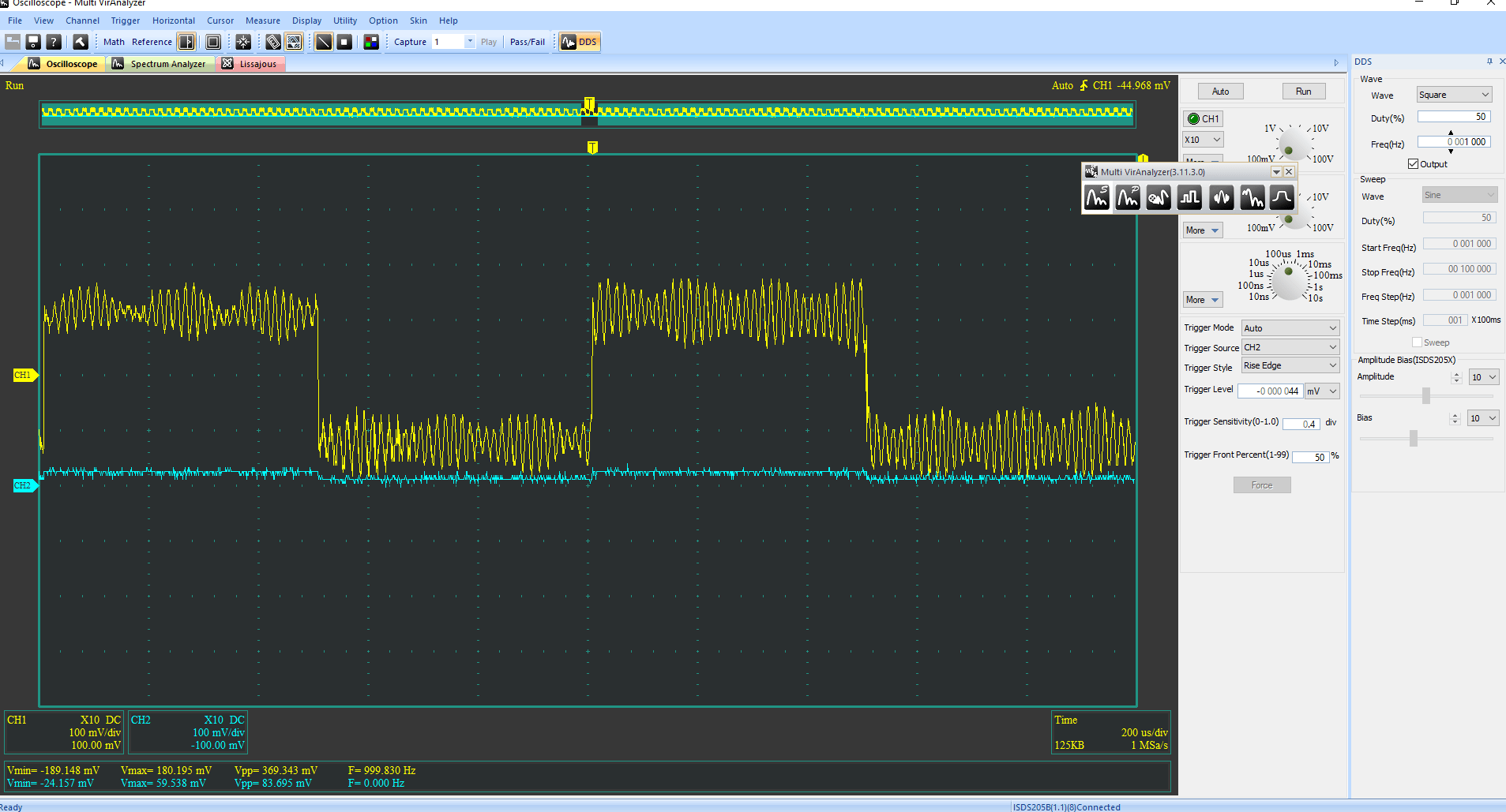

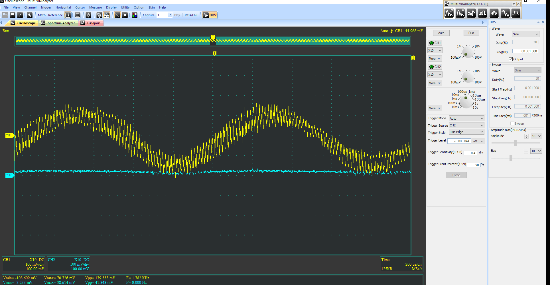

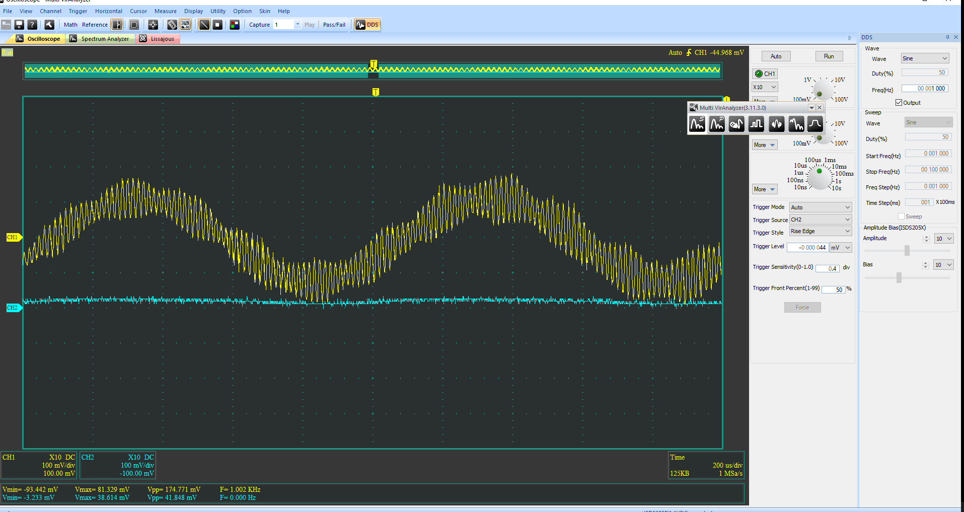

Well, first round of scoping went without any smoke.
It looks like I still have a power oscillator though....
Load is 3x 3.3K 5W wirewound resistors in parallel for 1.1K
Left channel 1KHz sine wave.
Left Channel 1KHz square wave.
Right channel 1KHz sine wave.
Right channel 1KHz square wave.
Compared to the first version I have:
changed the drivers/voltage gain transistors to BD139/140
Changed C4/C6 to a 220pF c0g ceramic
Put a 0.1uF film cap across C-E of Q9

Where are you connecting the probe gnd clip to? It should be on the ground side of the load when looking at the output.Well, first round of scoping went without any smoke.
If you short the probe point to the probe clip (probe GND) does the CRO display a clean flat 0 volt signal?
Connect the channel 2 probe to the input and display that as well. Make sure your input test sine wave is clean.
If you short the input to ground what does the amp output look like? Is it about zero VDC with nothing else?
Then connect the probes to the rails and look at those. Make sure the voltage rails are clean.
Try a couple of different CRO probes when doing measurement (Just in case the probe is bad). Try doing some measure without the probe. Just run some wire from the CRO directly to the AMP.

The measurements were taken from the speaker jacks.Where are you connecting the probe gnd clip to? It should be on the ground side of the load when looking at the output.
The ground clip was attached to the chassis rather than ground side of the load.
The blue line in the screenshots above I'd the 2nd channel of the scope on the input. I can't get any higher resolution than that at that signal level sadly.

I (perhaps unwisely) changed both channels to the new transistors/caps.You said in a recent post

Both channels appear to be behaving the same so far. Both possibly oscillating, more testing will tell.
