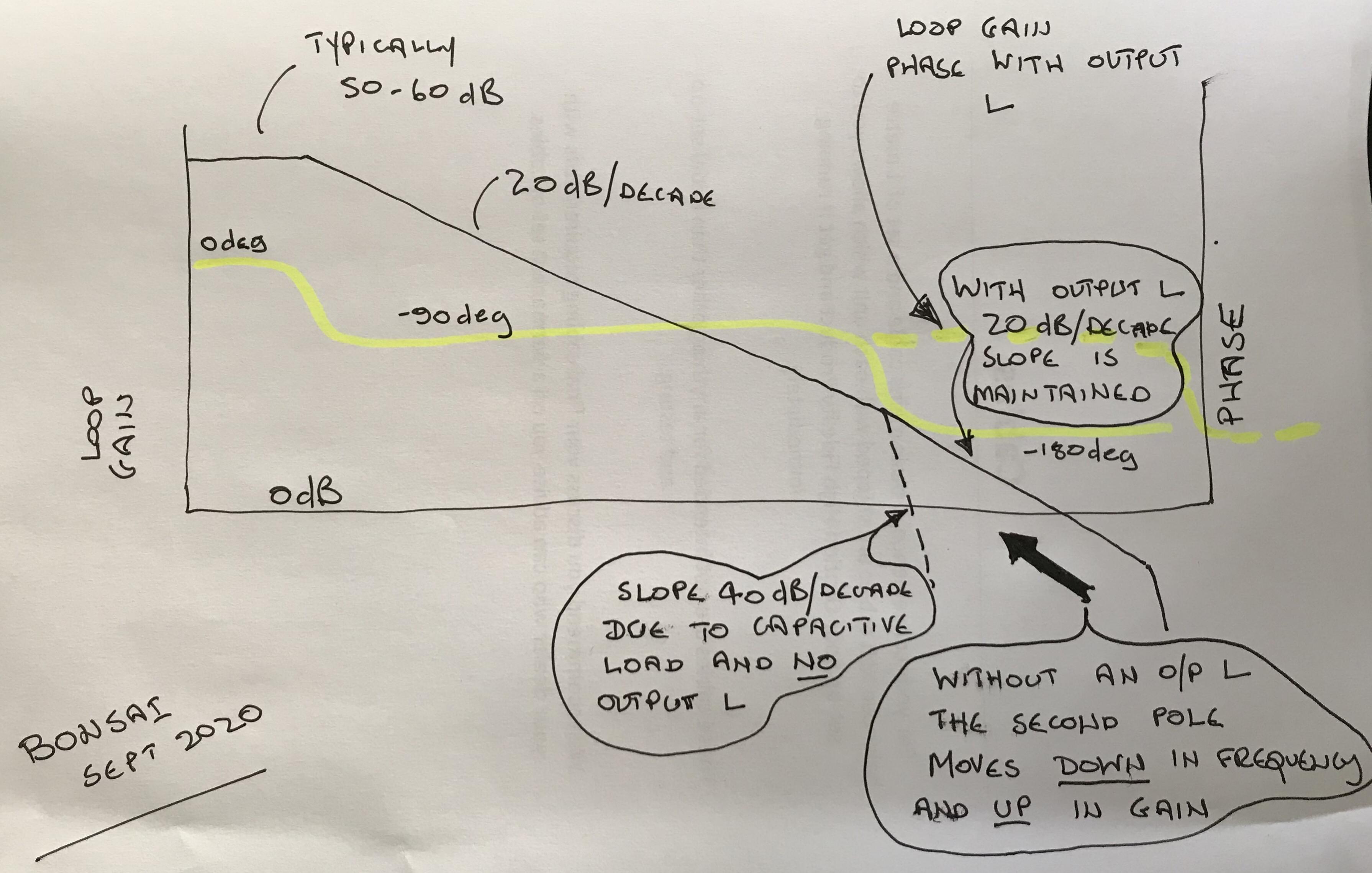

The loop gain drops at HF and the phase margin degrades without the output L(R) network. Again, please see the link to the presentation I posted a few pages back that makes this mechanism clear. This is straight control theory stuff - you can see the upper pole migrate down in frequency and up in magnitude as you increase the capacitive load. As soon as the pole is above 0 dB you have a problem because the roll off slope is now intercepting the 0 dB gain line at 40 dB/decade. The output L(R) network solves that problem.

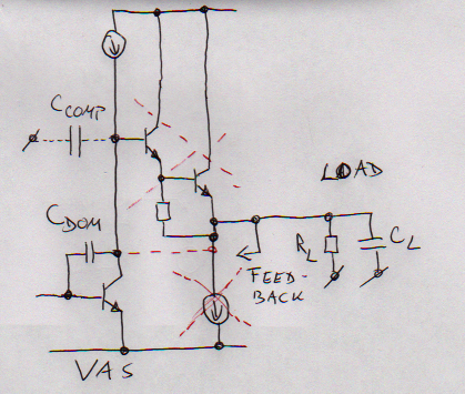

Are we talking about the same design? The OP mentions oscillations in his sim. As there is no LTspice version I cannot confirm.
Common emitter output stage
I'll try to explain why I think it is better with a common emitter output stage.
Referring to the schematic with a darlington output following the VAS, we are ensuring the stability by selecting a proper value of C_Dom. The Miller-effect make it possible to use a relative small value of this capacitor. We could, however, use a capacitor C_Comp instead (or in addition). However, then the capacitor had to be much larger (Slew rate becomes a problem).
Now, what happens if we remove the Darlington output stage and use the VAS as the output stage instead. The capacitive loading C_L now is at the collector at the VAS. (We have now removed the possibility that the darlington is oscillating because of the loading capacitor C_L.)
So if you mean that a commom emitter stage is not better than a emitter follower output stage, then you have to explain to me why a larger C_Dom causes more instability.
With all due respect knutn, your post does not make sense.
Certainly EF or SF are better than common collector or common drain, but the fundamental mechanism is as described below no matter what the OPS.
You can do that with a resistor. And either way it’s entirely suboptimal.
In any amp, you have to ensure the loop gain intercepts the unity loop gain frequency at 20dB/ decade to ensure unconditional stability. The problem with C loads is they move the upper pole around so you cannot guarantee the unconditional stability requirement unless you really hobble the loop gain by doing what you suggest.
