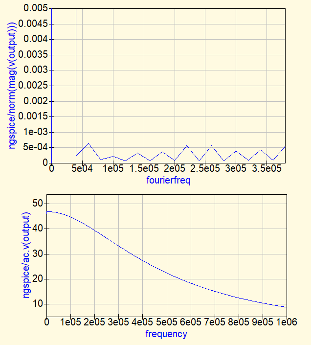

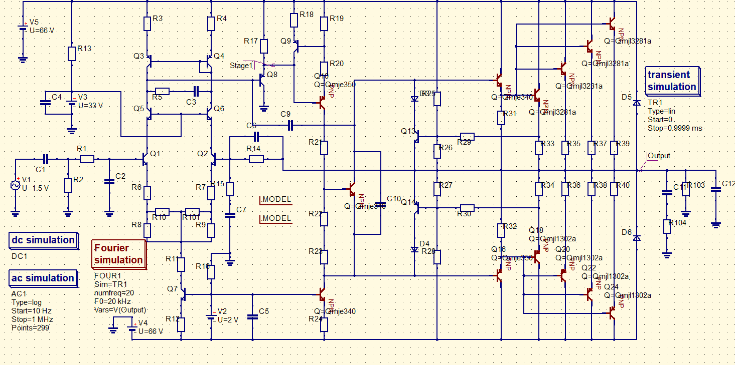

simulation of C300 amplifier
I am working on building up Michael Chua's C300 amplifier which does include a Zobel load on it. I have a SPICE simulation of it going. I am trying to figure out what could go wrong with it through simulation. I have been able to put 10 to 20 nF on it without problems, but once 100 nF is directly loaded on it, oscillations start. I can increase the Miller compensation capacitor to bring the pole down to be stable, but if the loop bandwidth is reduced too much, THD increases. It seems to be in the neighborhood of 0.05% to 0.1% for 20 kHz @ 200 W output to an 8 ohm load (at least in simulation).
The attached SPICE file is used with Qucs-S/ngspice and uses combinations of faster transistors to try to increase the loop bandwidth so that the dominant pole is the Miller capacitance. If anyone uses Qucs-S you can load this model up and try it for yourself.
This is why I need to have some idea of what a reasonable capacitance to design for is. 100 nF seems like a lot of capacitance for a cable, but perhaps someone has some ribbon-like audio cable that works that way.
  • C300_Qucs_S_Spice_Simulation.zip

Unfortunately, there will always be a feedback arrangement that provides a bit less distortion at the price of stability. You have to do everything you can to stabilize your feedback and then look to other means to reduce distortion. For example, replacing R31+R32 with a single resistor and perhaps a capacitor (no connection to the final output) in order to cross-couple the drivers will improve the cross-over and high frequency performance.
C6 should be limited with a series resistor, 100 to 1k depending on R14. C6 causes RF rectification problems because it is a direct path from the speaker cable antenna to the LTP. C6 also exaggerates unpredictable problems that result from stray capacitance and inductance.
There are many complicated compensation methods but complicated compensation is vulnerable to unexpected variations that cause instability. My favorite plan is KISS, a single dominant pole. So I would not use R5+C3, and simply adjust C9 and/or R6...R10 until the circuit is stable.
Not using a series inductor +resistor in the output is leaving the feedback wide open vulnerable to all kinds of stability issues. I would only omit the inductor if the amp is integral to the speaker, ie no speaker cables to speak of, and the speaker impedances well defined.
"Not using a series inductor +resistor in the output is leaving the feedback wide open vulnerable to all kinds of stability issues. I would only omit the inductor if the amp is integral to the speaker, ie no speaker cables to speak of, and the speaker impedances well defined."
Definitely, who wants full power oscillation at 200kHz?
That lower distortion is illusory if it is only available along with conditional stability.

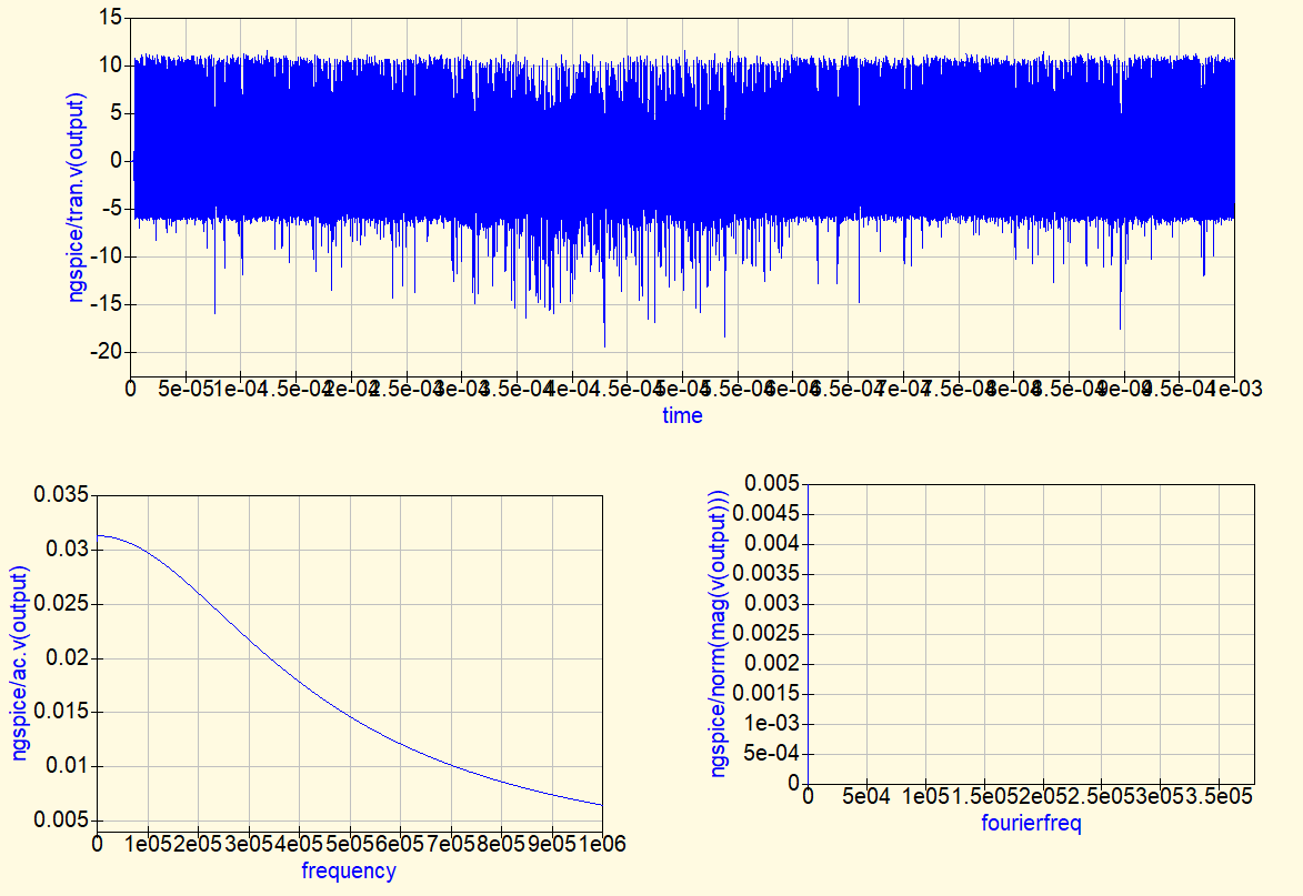

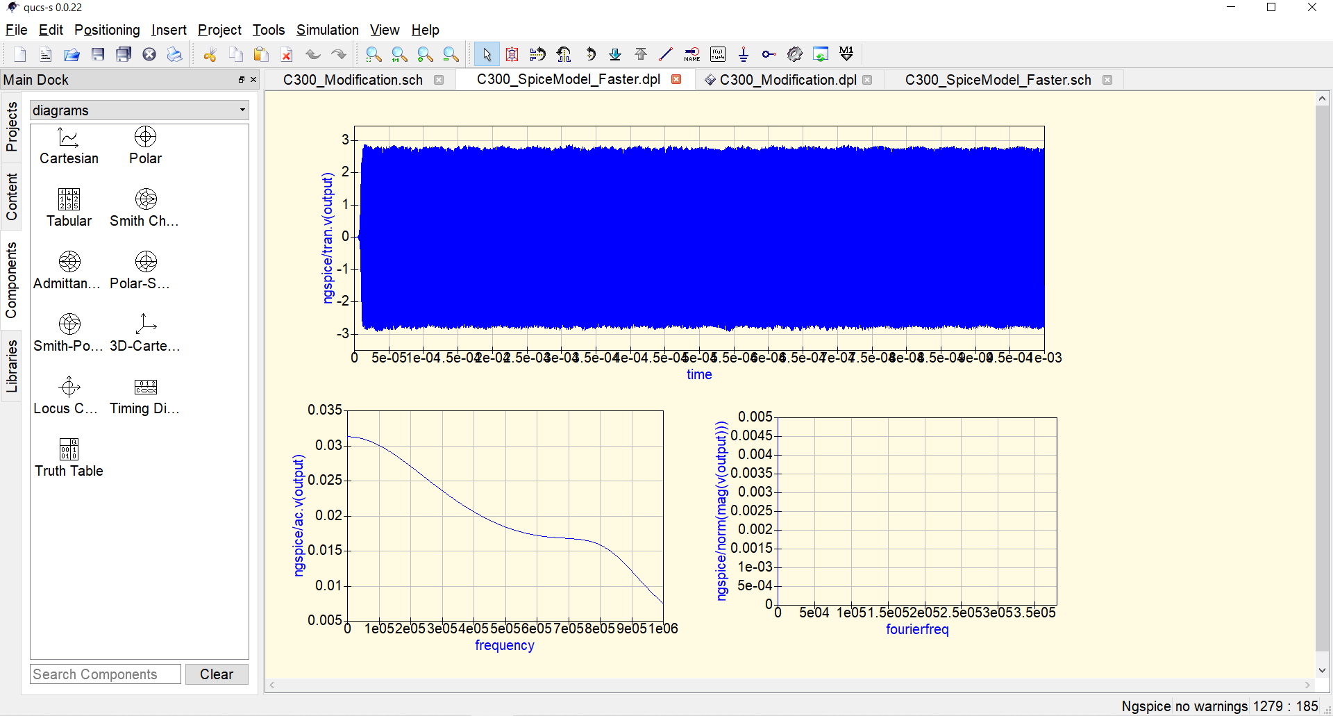

So I tried to replace R31/R32 with a single resistor and capacitor, and it did not seem to change the distortion much at all (using the Fourier harmonic analysis).
The oscillation that occurs in simulation never seems to be the full amplitude range of the power supply (+/- 70 VDC). Instead, it is usually +/-3 to +/-10 VDC. See the examples below. This occurs at an onset of 40 to 60 nF applied directly to the output of the design. If a 2 uH inductor/10 ohm resistor combination is applied before the capacitor, it is stable even though the output voltage is somewhat more distorted.
Perhaps the reason why this oscillation is not observed in practice is that cables are distributed capacitances and inductances, and so for example a meter of speaker cable is going on have on the order of 0.1 to 0.5 uH inductance anyways, so to have this amount of capacitance (10 nF or more) over this short distance the cable would have to be a long flat ribbon. Basically, the effective impedance of the cable would have to be extremely low (square root of inductance/length divided by capacitance/length) for the cable to act like a lumped capacitor at the terminals of the amplifier. Does this sound reasonable?

One question I would ask about the output inductor would be is how much the cable inductance itself acts to limit the oscillation, and this might explain if oscillation at the amplifier is not such as problem as it would be as if the speaker terminals are directly loaded with a capacitance.
Given that oscillation of an amplifier could produce a catastrophic effect on a speaker if the amplitude was high enough, I would think this might be a consideration to maintain SOA.
If an amp oscillates it is at a very high frequency like 100kHz or higher. Also the amplitude is not full scale but "parasitic" rather 10%. The amp will get hot because of high dissipation also at 0-crossing where both the capacitive current and the voltage across the transistors are the highest.
This will not kill any speaker because the impedance is inductive and little current will flow at this frequency.
Speakers get killed by DC voltage or very low frequencies, but all amps have a detection and shut down hopefully.

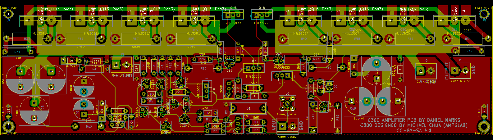

A proper zobel network on the output can make the amp more stable, but bad board layout can not be cured so easily.

Another question: I laid out a board for the C300 and I made one side of the amp a ground plane (except for the TO-264 power transistors). I kept the lead lengths as short and wide as practical and kept room for the parts. I noticed that most audio amps don't use a ground plane, and for the most part are single-sided boards. Does putting in a ground plane cause a problem? I am used to designing RF stuff where the inductance is generally minimized by running a ground plane for the return currents, especially when closed loop feedback is used or the inductance of the ground plane connection would cause oscillation.
If you look at the layout of the board, the red is the top layer, the green is the bottom layer, and yellow is the two layers together. I made the top layer ground for most of the board, and where the transistors are, I made the layers the output and the +/- VDC rails to try to minimize inductance. The trace that is between the two sides of the AB amplifier is 4 mm wide. Also, I use 100 nF capacitors to AC couple the ground plane to the chassis to reduce noise, as well as use power conditioning on the input power (two layers of film capacitor filtering and common-mode chokes). I think these are good design practices, at least for RF which I am more used to laying out.
