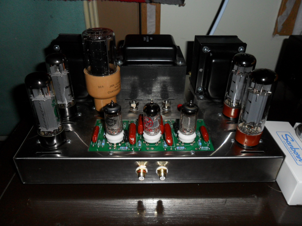

How far away from optimal is the 'bad' set of tubes biasing? (What voltage should they read, and what are you getting?)
If you can bias one side, but not the other (Which I think is what you are saying),
Swap the set of output tubes from one side to the other. If the side you can (or can't) bias moves with the tubes, then that pair of tubes are the problem.
the bad tubes are about 30% from biasing, they read about .7 but should be 1 volt

it's 5r4wgy it has a large ceramic base and it's called a potato masher.

now i have a 5r4 rectifier and it gives me 390volts plate. i have the bias set at .85volts which with the 10R bias resistor gives about 43mA per tube.
43mA*390volts=17watts. el34 are rated at 25watts max plate
do you think this is a good set up? i want to run it a bit cool
You'll be down on max. power but other than that if it sounds good it is good. Many people use the 70% rule, bias the tubes at 70% of plate dissipation, which is 17.5 Watts, so you are right there.

why doesnt the SS rectifier drop the voltage more, it is supposed to be a direct replacement for the gz34. i would prefer to use it. can i pop it open and put a higher value resistor in it? with the gz34 i get about 430volts and with the SS about 460v
There's nothing wrong with running the SS rectifier, many of the old Dynaco based amps and mods used SS rectifiers. Using the same formula figure out what the current needs to be with whatever B+ the SS rectifier makes. One of the main reasons for using a 5AR4/GZ34 is to provide a warm-up for the tubes before B+ comes up. Using the 5R4 doesn't provide a warm-up time so you've already defeated that purpose, good or bad. I'm working on a friends ST70 and it came to me with a 5U4 which I don't think is a good idea as the filament draws 3A making the already hot PT hotter with less power out. I'm also building a pair of MK3s and I'll be using SS rectifiers because of the dreadful new GZ34s and FP capacitors that are available. If you do decide to run the SS rectifier makes sure the voltage doesn't exceed the voltage rating of the filter capacitors, a short period of overvoltage is probably OK though. There are many opinions about the new tubes but I keep thinking this, 20-30 years ago you would buy tubes throw them in and make whatever adjustments needed, now you throw the new tubes in and wonder how they are going to last. At least I had some time in the good old days.

5R4 has a directly heated cathode(the filament) where as the 5AR4/GZ34 has an indirectly heated cathode and that's where the warm-up time comes from, the indirect heater. As far as reliability goes you have already experienced some unreliability from crummy parts but if that had been a Solid State amp you'd be changing a lot more parts than just a tube. Tube circuitry is many times more forgiving of mistakes, abuse, etc. Solid State usually goes in an instant with more smoke if there is a problem. Though the JJs sound good there is a big "wonder factor" on them, except maybe for the EL84.

The 5R4WGY is a high voltage power rectifier and was designed for transmitter use. It has a rating of 180 Watts. The maximum reservoir capacitor is specified at 4 µF and the rectifier needs a series resistance of 250 Ohms to limit peak current.
i now get just under 390 plate and so i run the amp at about 40mA/tube to keep things cool. still sounds good.
