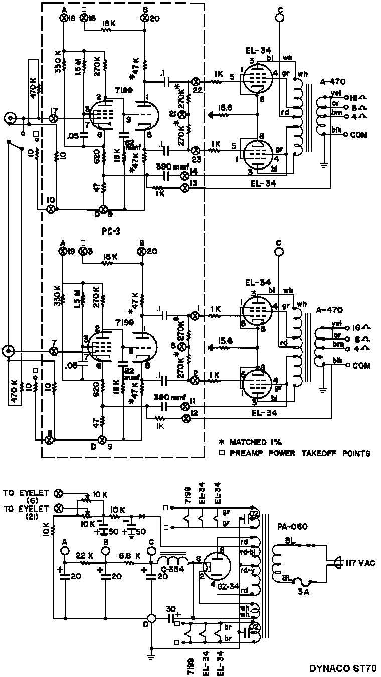

Go back to using a tube rectifier and add a 10R or 20R 20W power resistor at the secondary CT, not the primary side. 20W may be more than necessary but that is what I'd start with until you see how hot it gets. Fine tune the resistance value after you see the results with a 20R.

what is CT? do i connect it between the rectifier and the cap board?

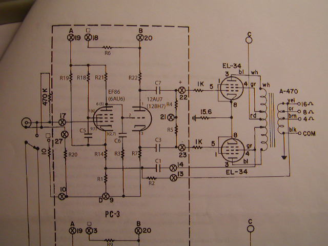

i attached a schematic for this amp. the power supply circuit is at the bottom. pin 8 leads to the cap board.
can you pls let me know where exactly i should install this resistor?
thanks
what is CT?
Center Tap. It's the line to ground on the secondary. Put it in where the lines hook to ground.
It's easier than puting 2 individual power resistors, one on each line, to the rectifier. Your chassis wiring might make one big one impractical so the other way might be necessary.

What tubes don't work/trashed? Take a look at the schematic I posted. Is it the same as the amplifier that you have? Are we dealing with an SDS Labs driver board that uses EF86 and 12AU7? Is the output stage wired the same as the schematic that I posted? Look at pin 8 on the EL34's on your amp. Is there a single 15.6 ohm resistor there or is there a separate resistor on EACH of the EL34's on pin 8? If the size of the bias resistor isn't 15.6 ohms what size is it? Let us know....😀
Have you ever set the bias? Take your meter and set it on Volts DC and measure ACROSS the bias resistor (the 15.6 or what ever value goes from pin 8 to ground) and let us know what the voltage is. Example 1.56 volts across the 15.6 resistor means you have 100mA bias for the pair of output tubes. If you happen to have a 10 ohm resistor then 1.00 volts across the resistor would give 100mA for the pair. Please take these measurements and post your findings. If your voltage across the cathode resistor(15.6) is less then adjust the bias pot for THAT channel until you reach the desired voltage.

There is a VERY simple way to reduce the B+ on an amp such as this, with no re-wiring or component swapping/trimming ---
Replace the rectifier with a 5R4. It has a 2 amp filament, only .3A more than the 5AR4, buy has a much greater forward voltage drop; 65v total or so, for a net loss (from the stock rectifier) of about 30v B+

1V across a 10 ohm R for a pr of tubes is 50ma/tube, assuming that they are reasonably well matched.
Power is VI so your output tubes are dissipating 456V*.050A=22.8W; the max rated dissipation for EL34's is around 24W, so you are within limits. Note: the calculation above assumes triode operation, I have neglected the screen grid current, etc. Also note that I neglected the drop across Rk, since it's only 1V. For a cathode bias output, you need to subtract the voltage drop across Rk, since it's usually in the tens of volts range for typical output tubes. You want the voltage drop across the tube.
