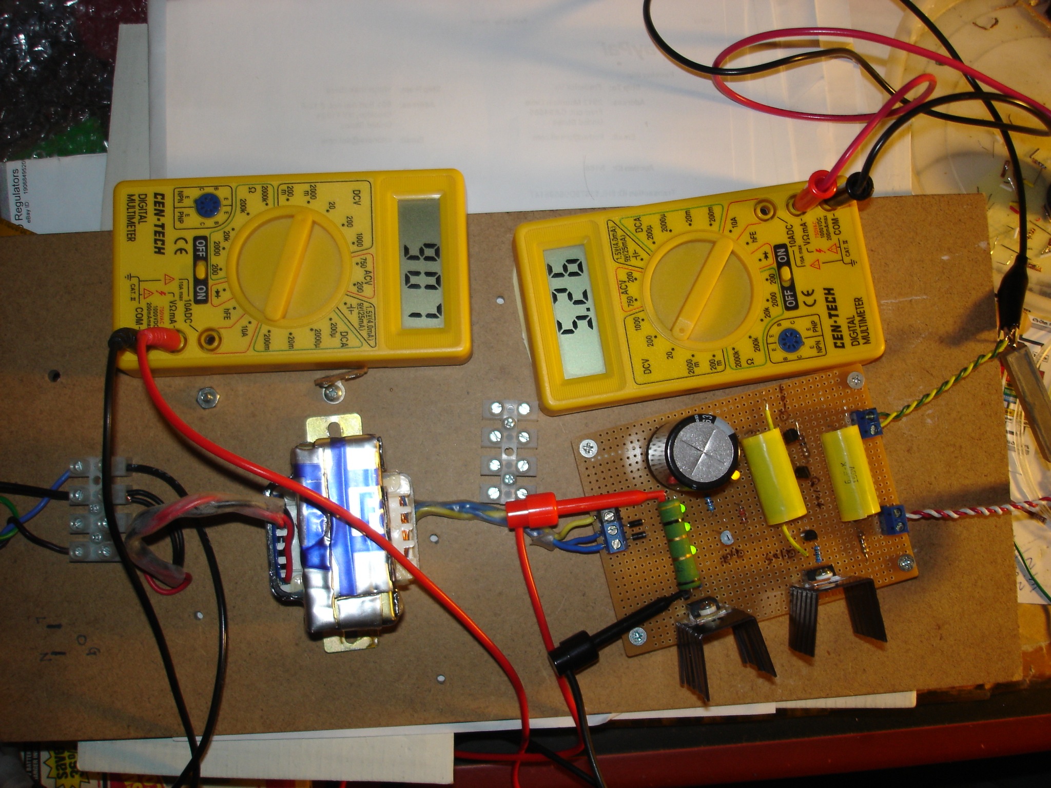

Hi all,
I just happen to be in the middle of a SSLV1.1 board PSU build for a standard Pass B1 Buffer PCB (the original from Pass Labs). Target voltage is +18V single rail.
I already built one successfully for my phono pre-amp and had no issues at all. But for this one, the two red LEDs in the voltage reference area do not light up. The 4 green LEDs do. I used the calculator to get the right parts (although I don't really know the load current), used 15R/5W for R301, 2 Wima Mks 4,7 uF Caps for C303 and C301, 1K8 for R303 and a Bourns W502 5K trimmer. D301 jumpered. I used BYV28-200 diodes for D311-314 as rectifier that I had lying around (instead of the MUR120). Nichicon Gold Tune 4700uF 100V as C305 (polarity is correct)
I had no visible signs of bad soldering, so I thought it would be good to build a second board with a different set of parts to be sure there is no bad part involved (I had a second board and IRF+ set on hand). Unfortunately with the same result.
Since building a shunt regulator with Salas and teabags boards for a B1 has been done loads of times in the community, could anyone give me a hint where I went for the wrong path?

Most probably you are exceeding the CCS current with the load needed current, hence running into no juice for the shunt FET transistor.
I think the IRF9530 might be shorted. Measure voltages there, and all the T0-92 devices.
15R @ 18v should work, but 10R might be better if Roender is right.
What is the dummy load used? That will say something certain about the set current sufficiency.
1R is effectively a short circuit. Thumbs up if with 2 surviving regulators, but to simulate a B1 make that 1K 1W.
Seems like we have found a source for my issues: myself. Thanks for your help, will see what I can rescue....

As Salas said, nothing was fried as short circuit protection is one of the many advantages for a shunt power supply. And it comes free with the design ;-)
