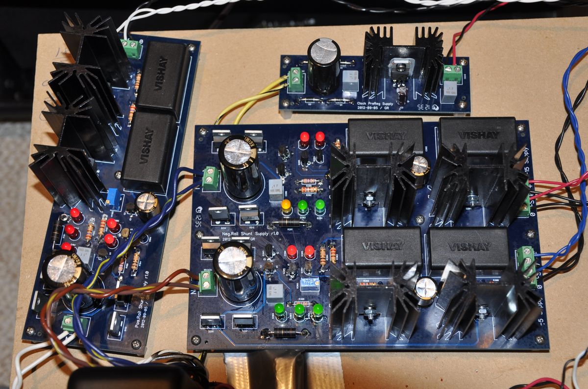

No worries, I do worse all the time. Post a picture of your self made boards shunts at work if able.
Here's a picture. Excuse the messy boards, haven't cleaned them with flux remover yet. Also, ran out of green LEDs and had to use 1 yellow. As you can see I used a lot of layout space; I don't like components squeezed together.

What value are those VISHAY? Polyprop?
What kind of tube stage, line, phono? You mean the SSHV2 reg I guess.
Or some I/V tube stage?
It's powering a TDA1541A , and your SSHV2 is powering a single 6SN7 tube stage.
I'm just completing a 4-layer PCB for the DAC and tube stage. Right now they're on separate PCB's while I test and tweak. Now that all components have been finalized, I'll combine boards.
Those are nice caps. 10uF at 500V. Here's a link:
MKP1848S61050JP2C Vishay BC Components | BC2788-ND | DigiKey
500V capacitors on low voltage regs... For the looks?
yeah, they do like nice, eh?
They were cheaper than boutique caps (under $6 each), they're MKP and they're Vishay. Seems that most film caps in that range are 300V and higher. I thought that in spite of these being a bit bigger and higher in voltage, the "cool" factor won out. You like them? 😎
They look like modules, cool caps.
