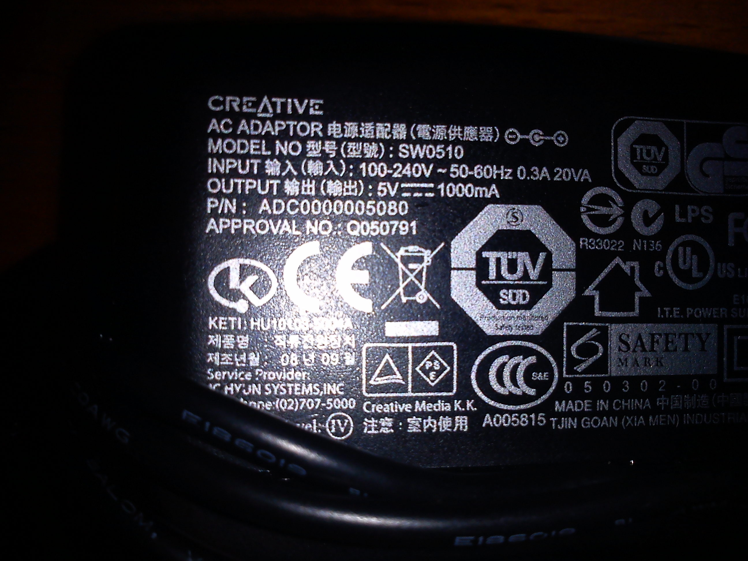

With a tx 9VAC 30VA could I get 5V 1A?
R301 1R5
Vref 1K trimmer + 1 red LED, other parts jumped
I can't reach 5Vout😕?
Have I to connect 1K resistor in R303 (Vref area)?

30VA / 9Vac = 3.3Aac.
Max continuous DC current from a capacitor input filter is 3.3 / 2 = 1.67Adc.
Your 1A will use up 60% of the maximum continuous rating.
9Vac * sqrt(2) * ~1.3 (regulation) * 0.94 (mains low voltage) - bridge rectifier ~ 13.5Vdc.
Vdrop to output voltage ~8.5V
What's the problem?

Measure what the emu really draws, see your set resistor's drop/rvalue, see if its enough to cover the emu. When you can't raise voltage on load its usually the reg is out of steam. If it raises voltage on the dummy, can't be malfunctioning.
Now current adjust resistor 1R5 voltage drop 4.09V current 2.7A enough for the E-MU.
Before current adjust resistor 2R2 but can't get 1A need because E-MU only lit the ON LED & with AC wall adaptor more LEDs lit.
When E-MU switch is OFF Vref red LED lit strong but when switch the E-MU to ON the red LED lit light.
Very difficult to measure what the E-MU really draws.

See if it works with polar output capacitor and no resistor. To exclude oscillation in case it isn't a load thing.
Following your advice now polar output lytic 47uF & no resistor.
I used a dummy load 4R9 10W to simulate the E-MU load:
-Vref red LED don't lit.
-0Vout
-I see a little smoke over Q302-305 I'm not sure wich transistor

Did you jumper the resistor position? You got to check 2 things. 1. The connections of the 4 wires and the polarity of the Emu plug. 2. The current it needs. Else we can not guess.
1. Polarity 4 wires connection checked: was correct.
2. shunt reg 2.7A it's enough device max power consumption 1A see attached pic of wall psu supplied with the E-MU
