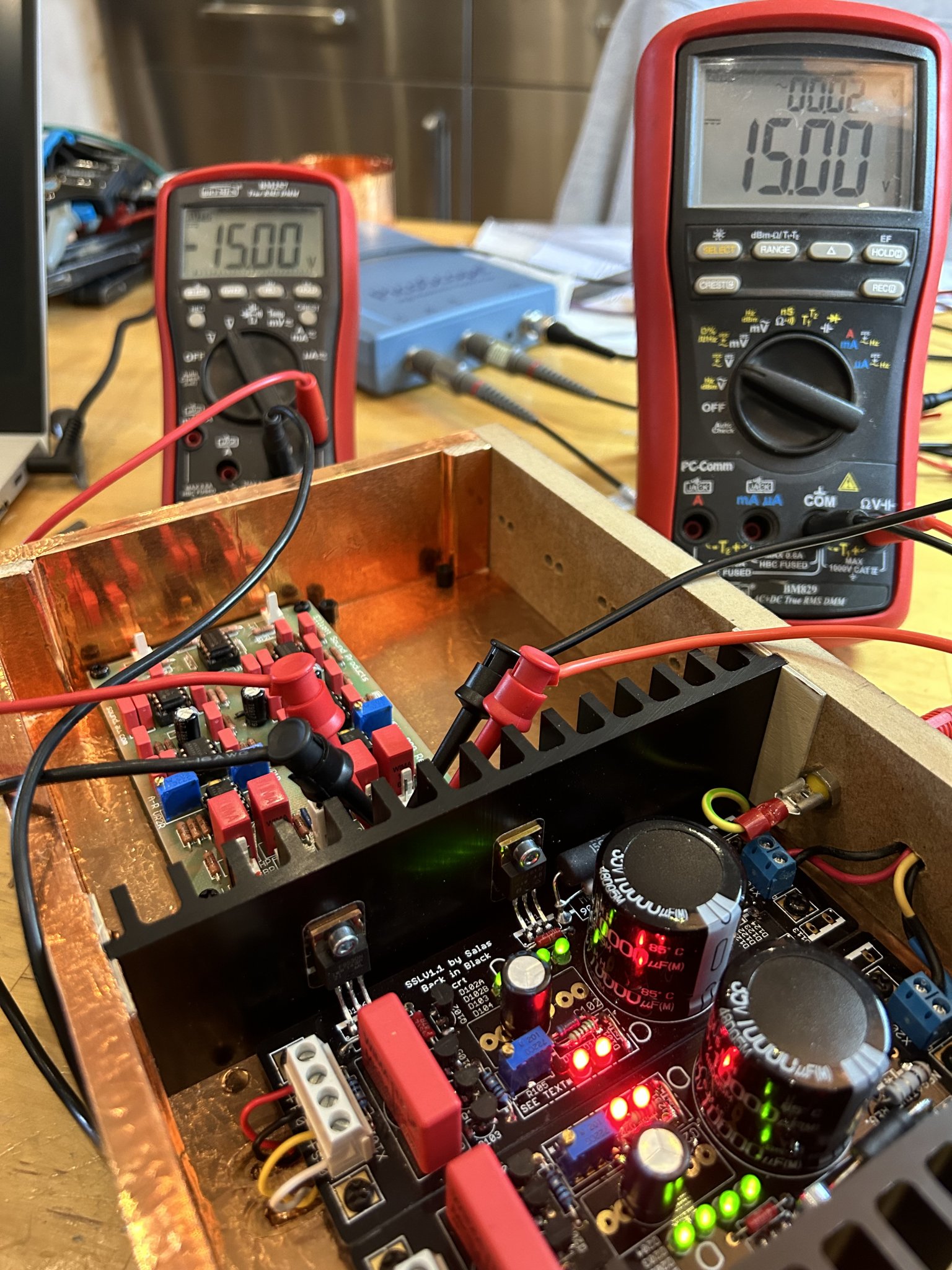

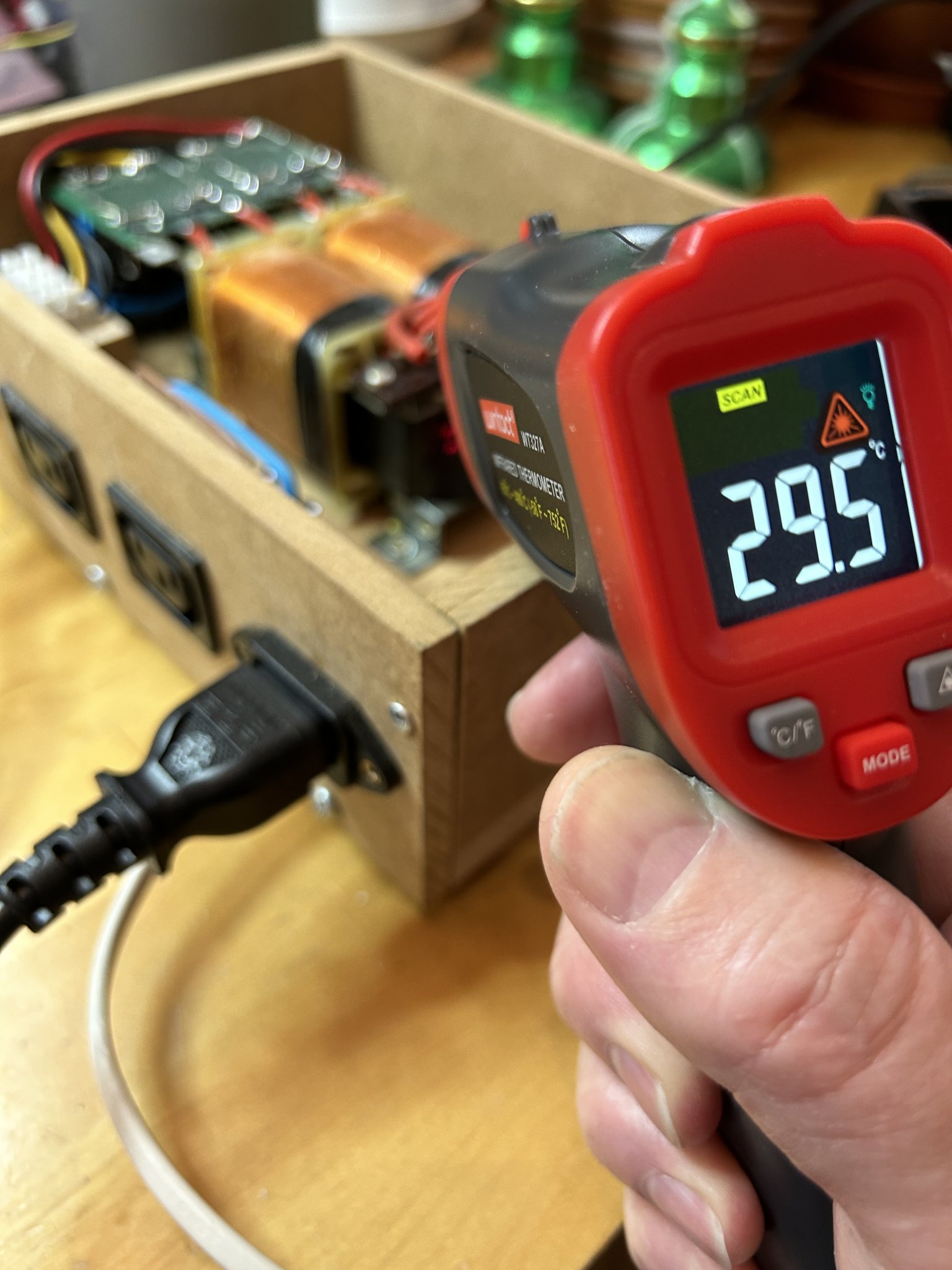

Been dryrunning on the table for four hours now.
Ambient room 23,5 C.

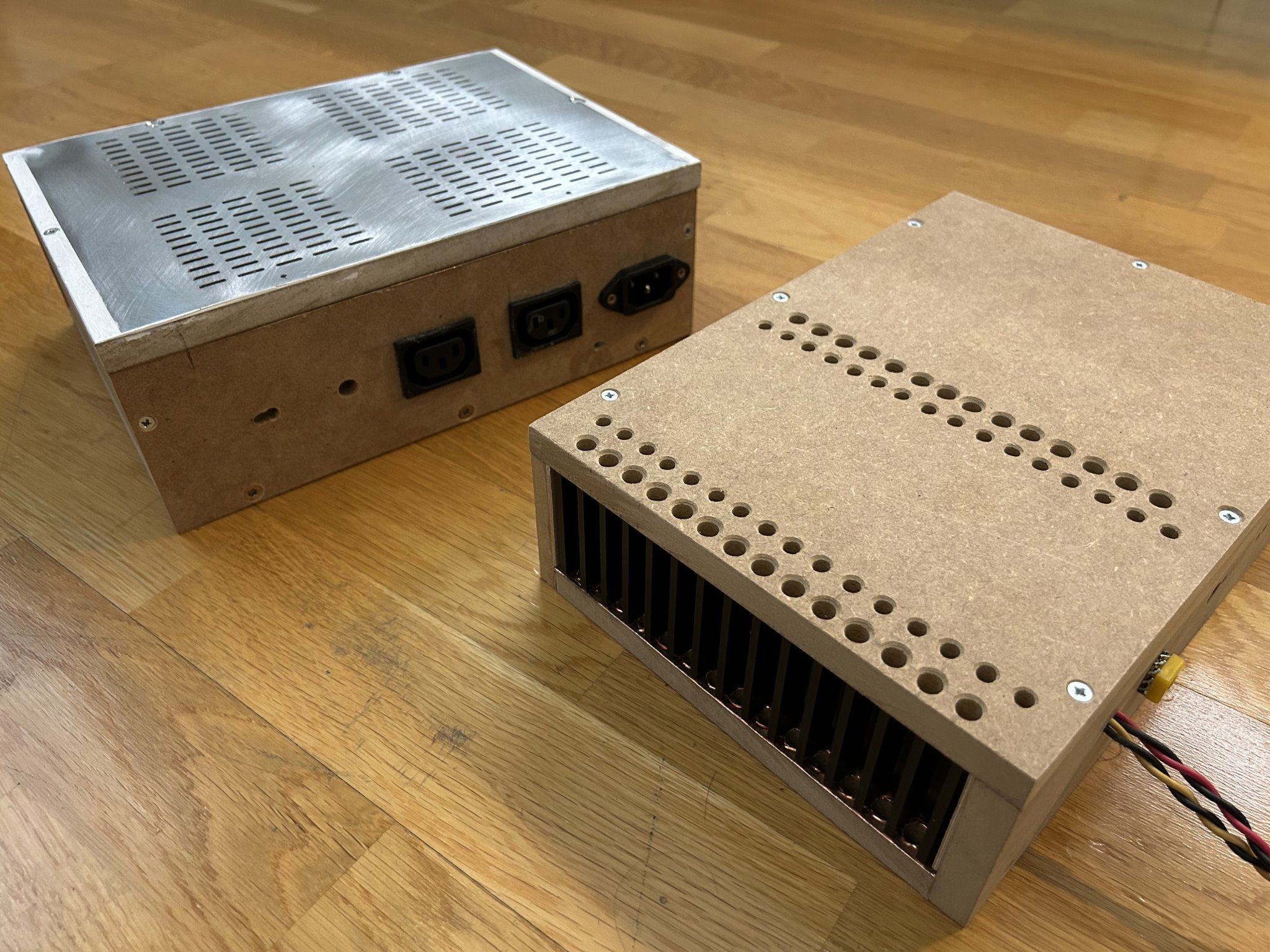

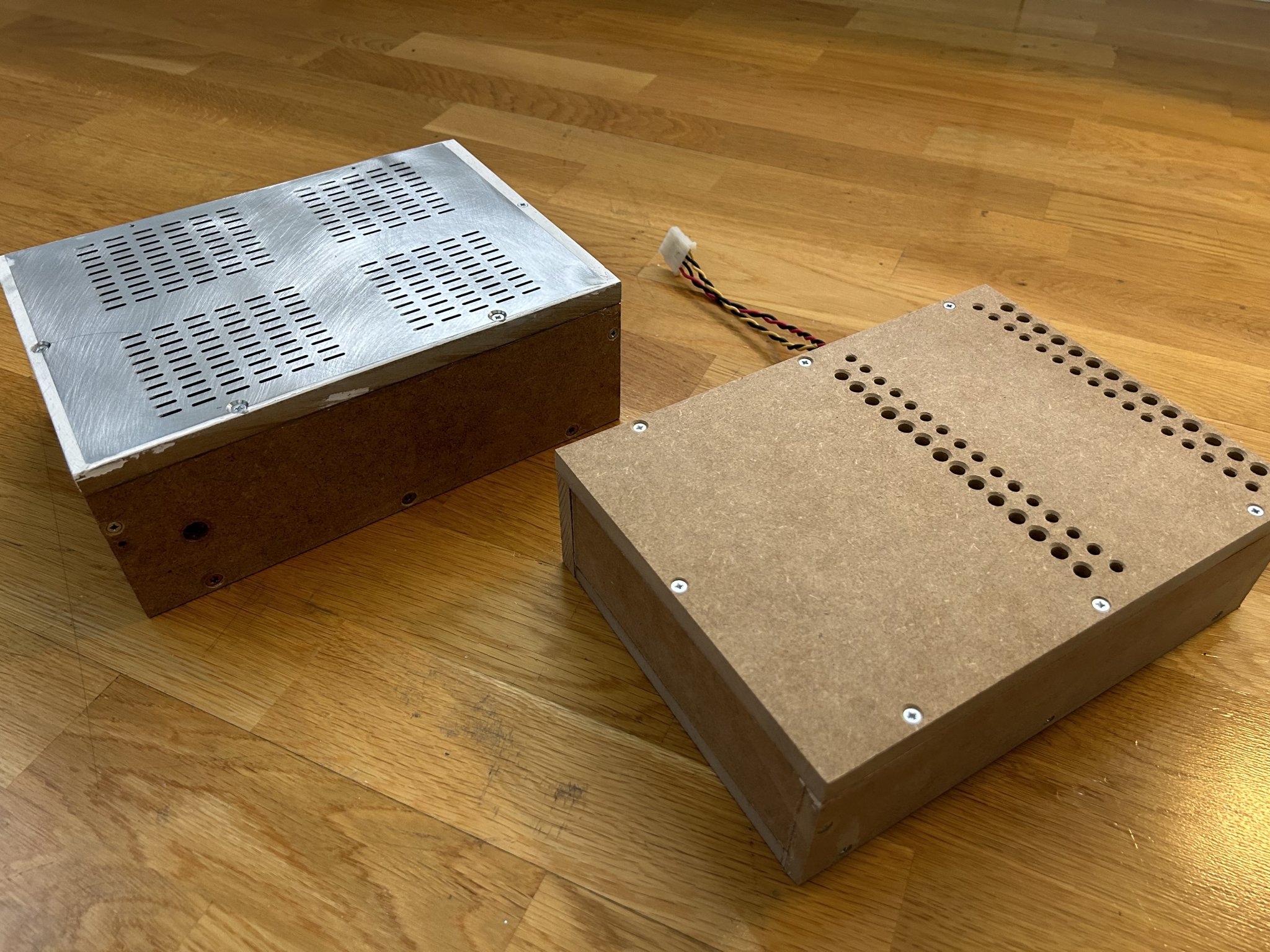

Small update. Since things seems to work technically as supposed I thought I’d do the boxes some decency. Chances are that if it gives no crazy surprices its gonna sit in my rack until I have v2.0. Im not caring for external finish so much now but I am giving some effort to fire saftey, RFI shielding and electric hazard saftey etc. Lids are being made just now.

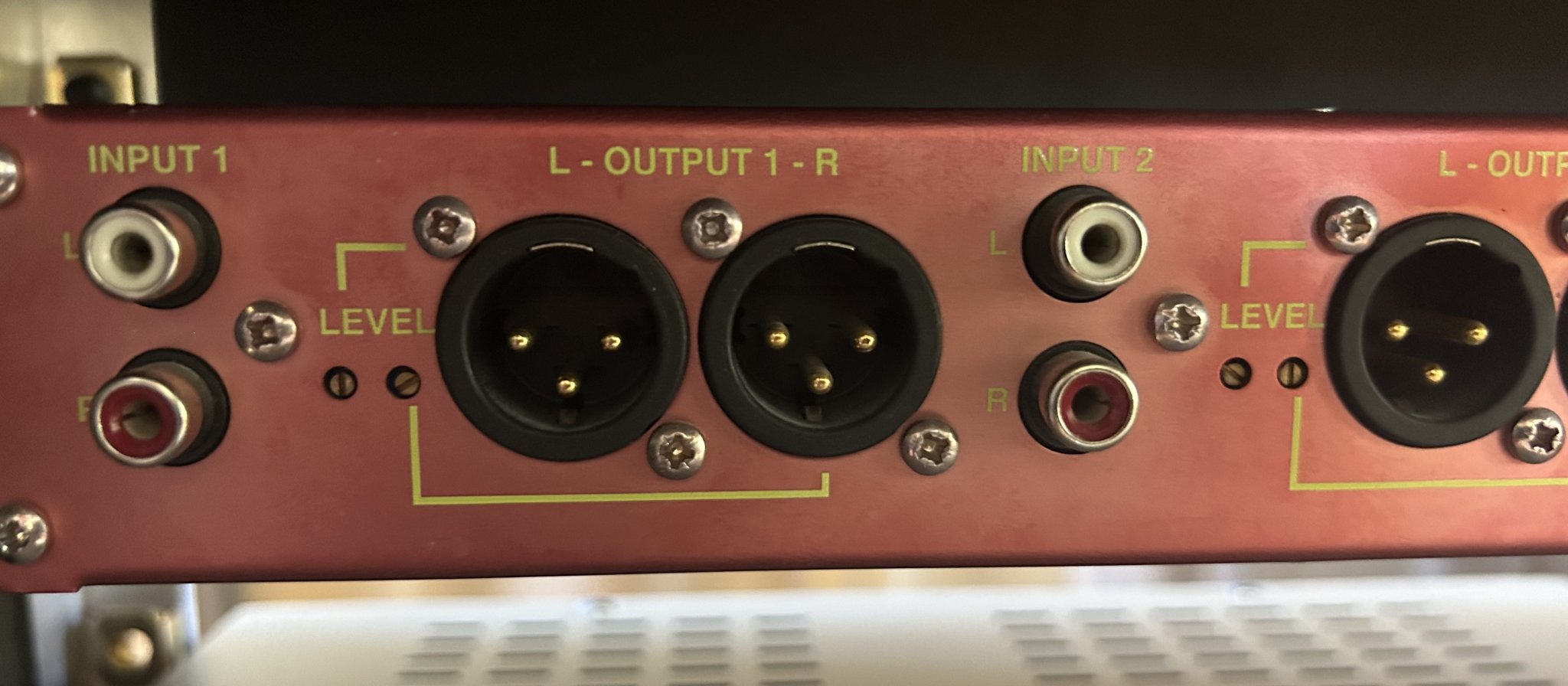

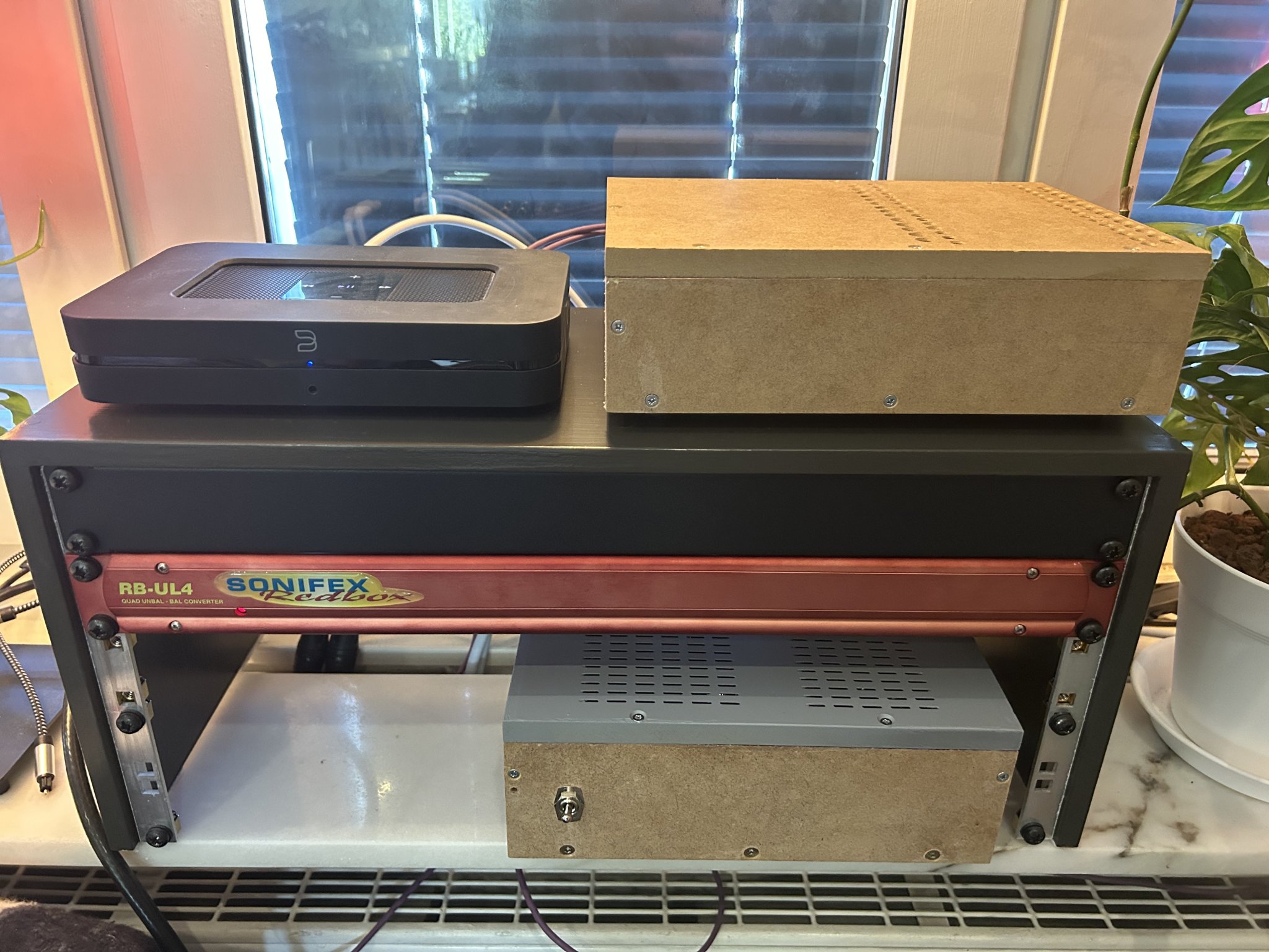

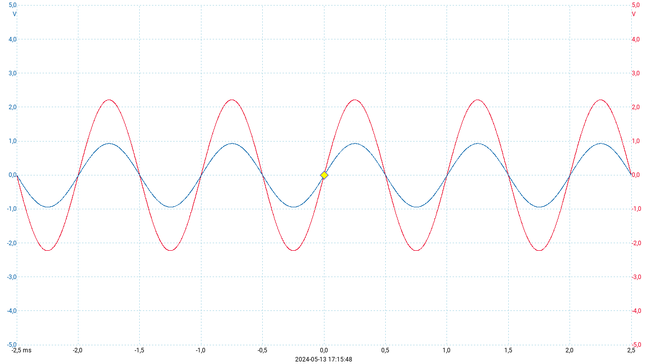

About gain structure. This is the Sonifex RB-UL4 that is going to convert the dignal to balanced for now. I just remembered that it has individual level adjustment. I guess they are set to +6 dB. How do I measure the balanced output correctly to adjust it to 0 dBu unity gain? Between Hot and ground i suppose, but shall that be full or half the input from the gen for 0 dBu? Any load except the scopes own?
Here is the current situation on Input 1 Left to Gnd-Hot on XLR out.
661.7 mV RMS in and 1571 mV RMS out between Hot and GND

Balanced level is characterized between phases. You measure the output voltage between pins 2 and 3 of the XLR without shorting either to pin 1. XLR is twice SE for level. Something like 5kΩ or 10kΩ is typical for most console inputs.About gain structure. This is the Sonifex RB-UL4 that is going to convert the dignal to balanced for now. I just remembered that it has individual level adjustment. I guess they are set to +6 dB. How do I measure the balanced output correctly to adjust it to 0 dBu unity gain? Between Hot and ground i suppose, but shall that be full or half the input from the gen for 0 dBu? Any load except the scopes own?
