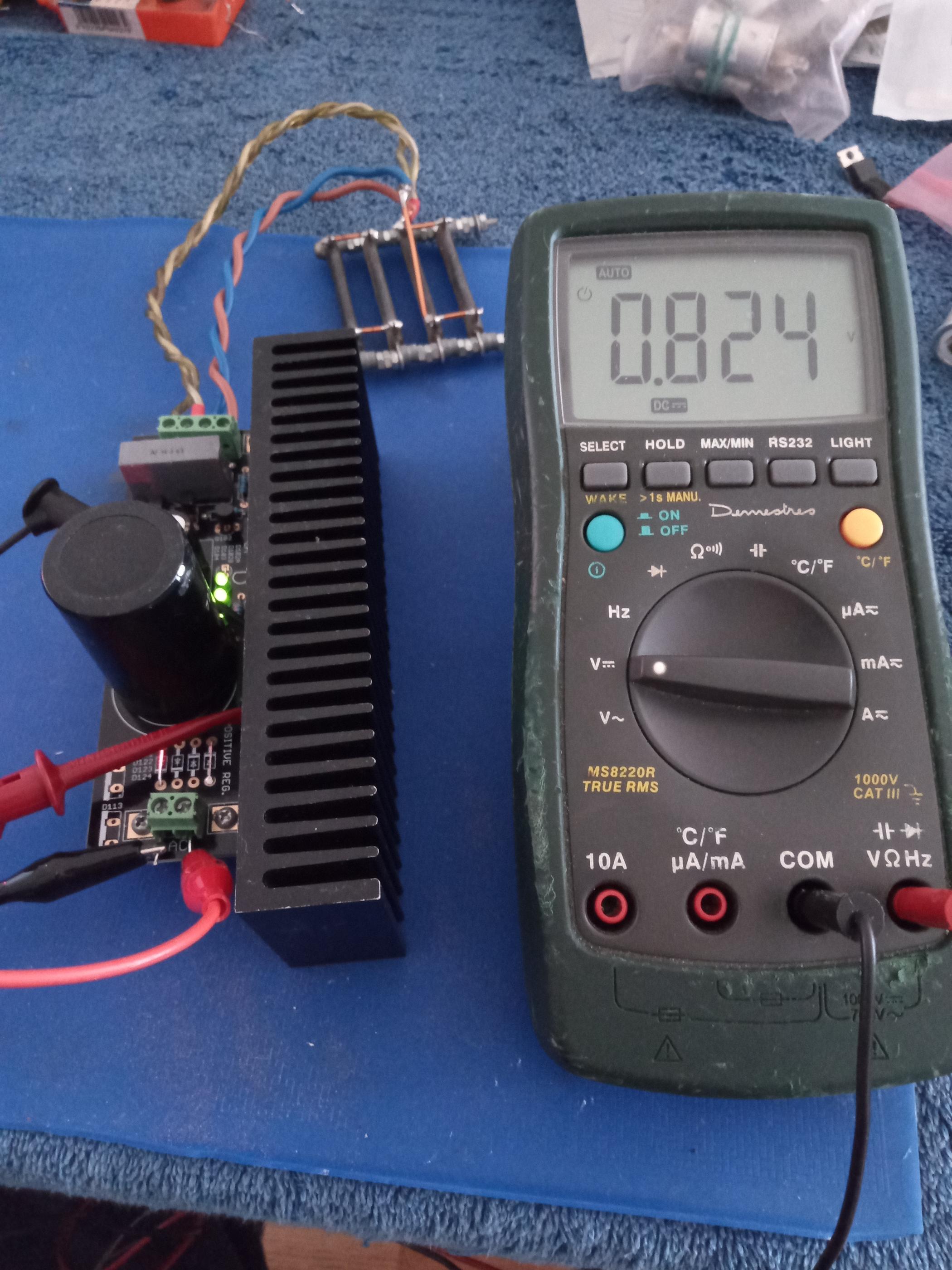

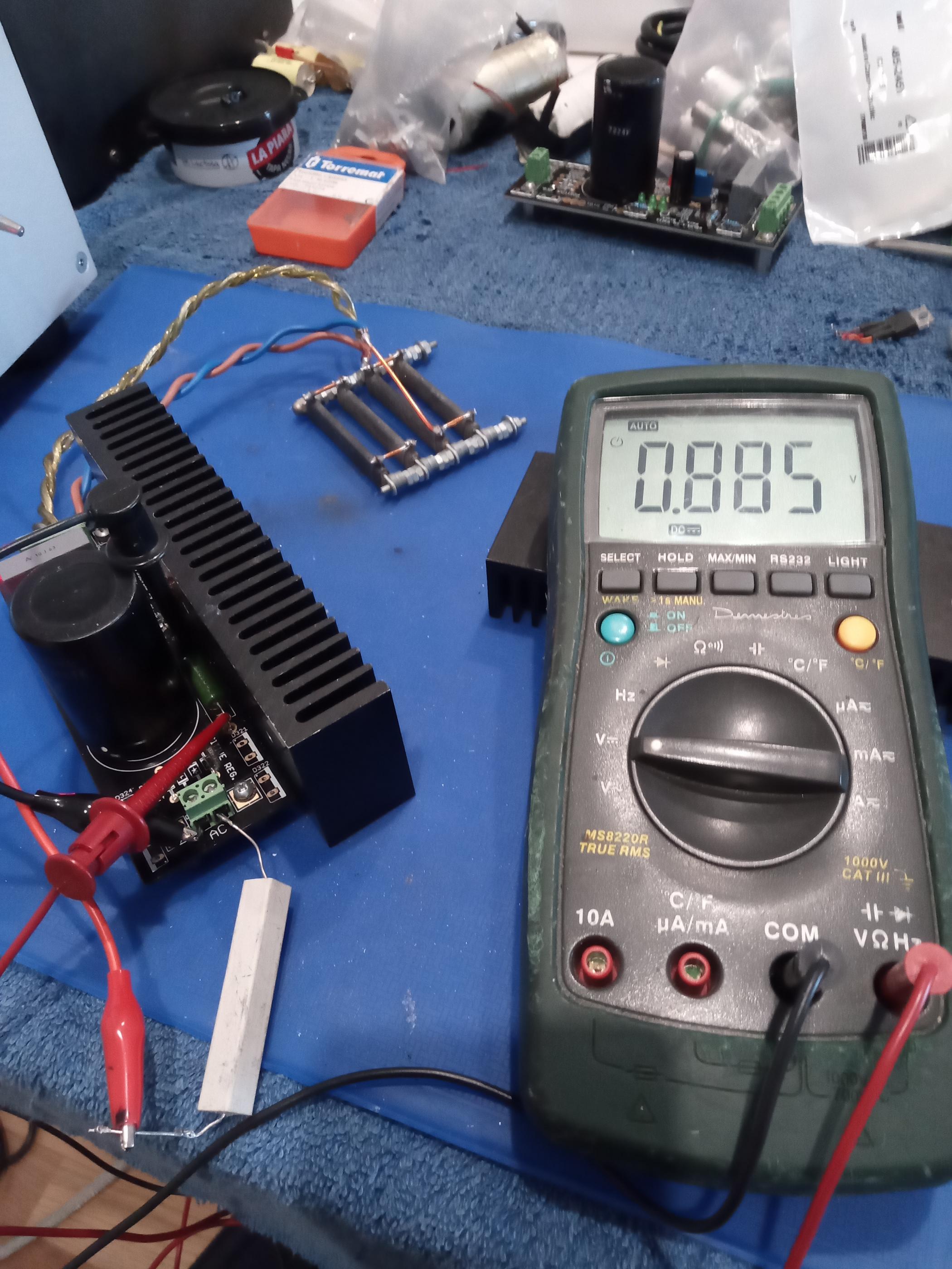

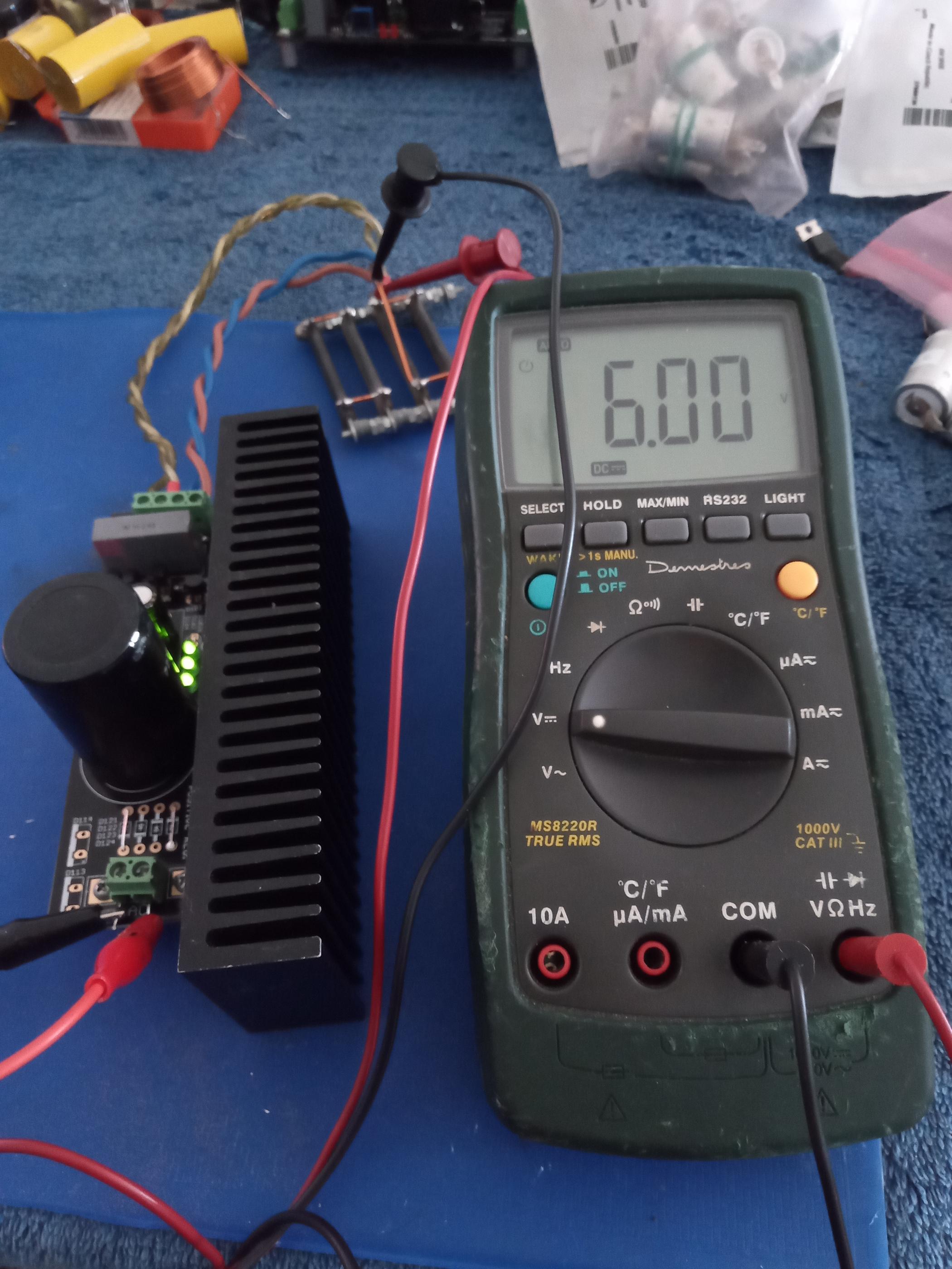

Salas the new reg. CCS 0.68R 1.215A but can't reach 6.3V because don't have enough current with my dummy load 5R.
3 green LEDs & R106,206,306 270R
Same power tx & psu like the other reg.
I believe that with the real load (Itch filaments) go well because power is 1A +0.2 own reg. and now CCS is 1.215A or have I to increase the CCS reducing the CCS resistor or adding a 4th green LED?
Have I to increase the CCS reducing the CCS resistor or adding a 4th green LED?
What's the reason for the difference of CCS using the same components?
You still have some voltage headroom before adding another LED because at 0.824V now.
The reason is tolerance. LED VF & MOSFET VGS differ from sample to sample. You may build two same regs but their Rset resistor need be different enough for achieving same CCS current. Tolerances manifest more in strong current settings.
If you match LEDS and mainly MOSFETS with the transistor tester between two regs they will react very much the same for CCS setting.
So your advice is that I will try as is?
I'm sorry if my language sounds rude Salas, English isn't my native language.
As is, it will just work for your 1A heaters. But better have a little more CCS headroom to match the other reg. If not equipped with a smaller 0.62R resistor right now but you have spare IRF9530s measure VGS of all you got with the DCA Tester. You must remove and compare the one already installed too. Replace with the lower VGS unit you will find. The difference to lower VGS is going to add on your now 0.824V. For in circuit bias it gets bigger. If you will add an LED the new Rset valet to use for 1.3A target is going to become much higher than 0.68R.
