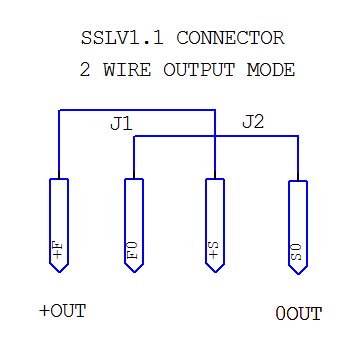

How do i handle the GND connection?
I need +12vdc / GND / -12VDC... I suppose, i will put the two "0" together, but how do i handle the 4 wire Kelvin connection then ?
Jesper.

If the DAC will be near, short sense+ with rail+ and sense- with rail- under the connectors and use three thick enough wires for conventional connection from rail+/0/rail- If you will bridge positive's return with negative's return you get a zero
For Kelvin see the pdf instructions

Imagine you do this and its analogous at the negative section:
Now you got +OUT 0 OUT 0 OUT -OUT. Bridge 0+0 across sections. Three thick wires +/0/- you can output to the load.
If it was Kelvin mode you would bridge nothing and send F+ S+ to +Rail(Load) F0 S0 F0 S0 to 0 power ground (Load) F- S- to -Rail(Load). Each with a separate twisted pair. Thinner gauge than in conventional mode is permissible.
