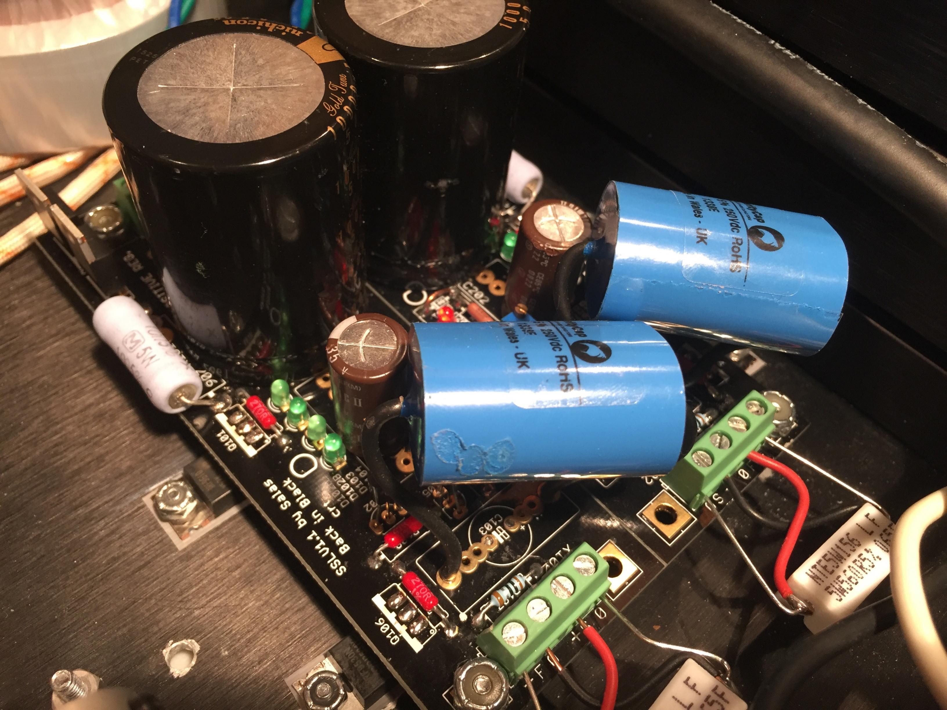

I'm having problems with the left channel regs. The output reaches 24V at about 85% on the variac and turning the trimmer in either direction has no affect. This is the same on both positive and negative regs. All LEDs light up.

Let it come up at 100% mains first then measure drop on R101 & R201 as well as Q101 & Q201 VGS. Make sure you aren't using too high R103-R203. Your dummy load should be calculated for drawing at least 20mA less than the CCS can provide.
Measurements
Now only one positive reg won't adjust. Here are the measurements I took at 100% mains on all four regs:

Positive ** This is the reg that won’t adjust
Output = 29V
R101 Vdrop = .05
V Ground to Scource = 26.5
Q101 VGS = 10.4
Negative
Output = 24V
R101 Vdrop = .28
V Ground to Scource = 25
Q201 VGS = 5V

Shows from the very small Vdrop in the problematic one. It will probably need a new q101. Also the q101 vgs is unusually high in both positives. Maybe you got a dodgy batch of 9610s?
Replaced Q101, same results. I've had 9610s in the circuit from two different sources with same results.
The only physical difference in the problematic one is where I melted the side of the output capacitor taking mosfets in and out. Could this be the problem?
