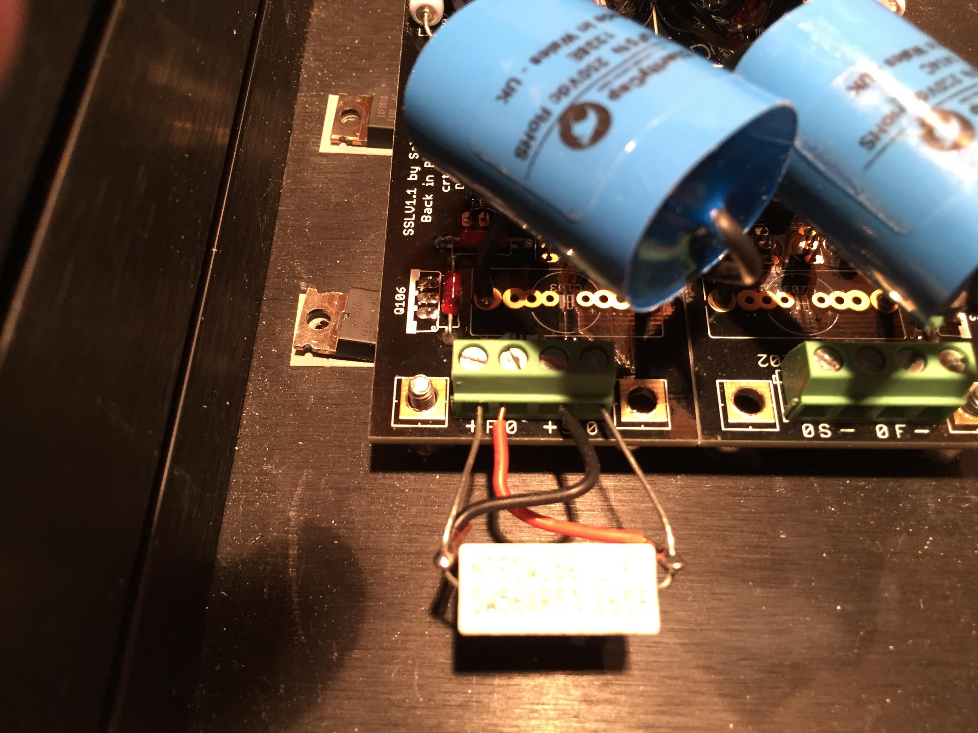

I powered up one positive board of the SSLV but I'm not getting the results I expected. The reg. is for a BA-3FE which draws 53ma of current at 24V. So I have installed R101=10R 3W, R103=4K, R105 (trimmer)=2K. I started with the trimmer at the halfway point and brought the input voltage up slowly, at 80% it toped out at about 16V and didn't rise as I turned the variac up to 100%. All LEDs where lit so I turned the trimmer up to the maximum and only got 19V. At that point R101 became extremely hot. Mosfets never got above room temperature. I took the board out and checked all parts for orientation and value, everything seems correct. I'm using a dummy load of 560R 5W. Could the dummy load be the problem? Have I done any damage?
I am speculating that there is overcurrent due to a shorted CCS Mosfet that is why you must check how much current runs there. Vdrop across R101 divided by 10R will tell. Your dummy load value would draw 35mA @ 20V or 43mA @ 24V so it is a logical choice given your target for the real load bias
Do you mean shorted to the chassis? I check for continuity before firing it up.
Shorted internally maybe because zapped by handling even, but don't believe it, we only speculate now. Measure first.
four green
Maybe for your parameters we will end up with three by shorting the fourth with a touch of solder
Voltage across R101 = 6.1 so Vdrop = .61 with 10R resistor?
0.61A times 6.1V is 3.7W burning on the resistor. Now we know there is way much current there. Quickly measure between S leg of IRF9610 (last pin as you face it tab up) and ground. Also voltage between its outer pins.
