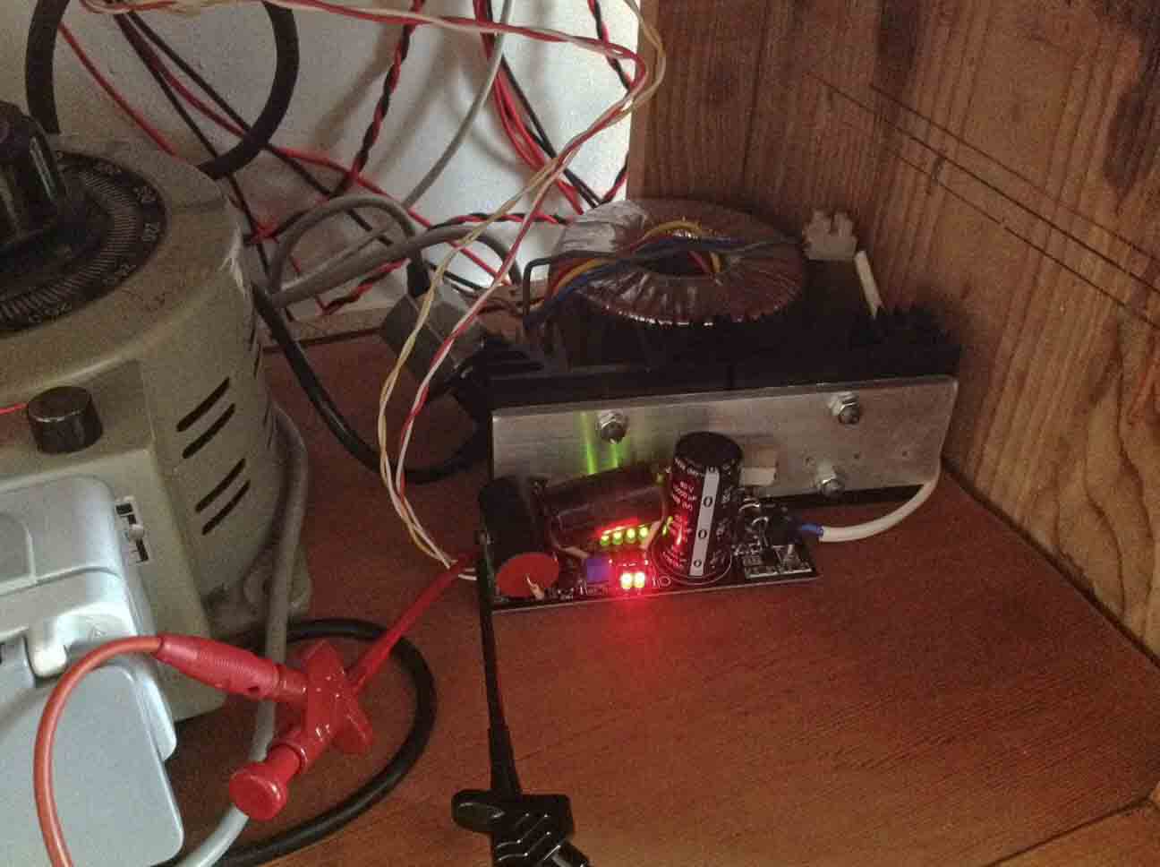

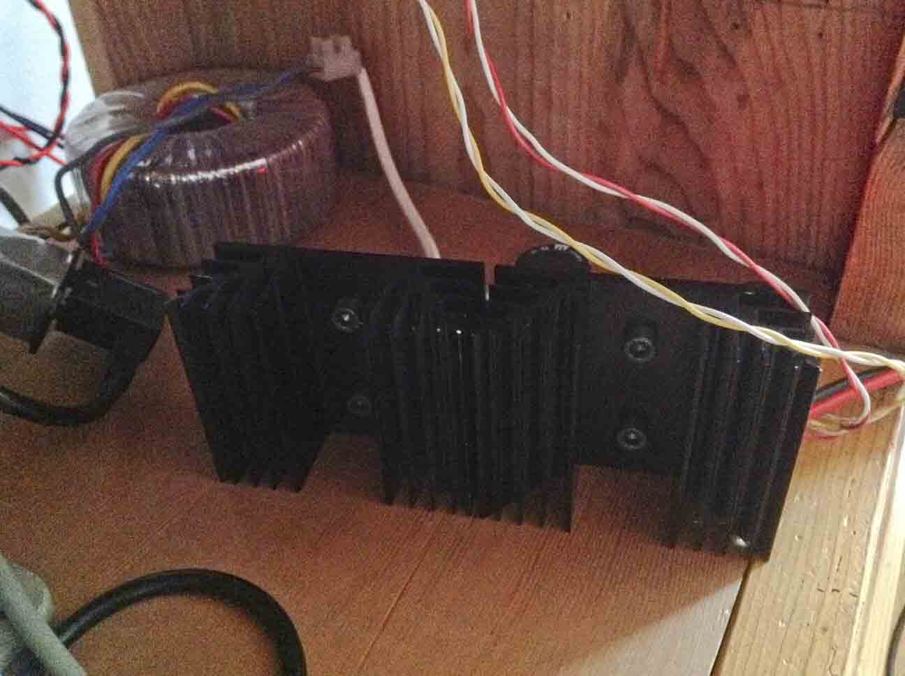

This is the type I am using. Height 75mm. I have mounted two pieces on an aluminium strip.
The sinks do not get hot, just hand warm, so I expect one sink will do fine.
I will try to add some pictures, but this does not work on my crappy IPad, so I need to mail them from the IPad to my laptop to add them.

Here are some pictures of the heat sinks
Don't you get any EMI on the rail with such long sense cables in the open?
what brand and value are films on that picture
They are Angela (rebranded Solen) MKP caps for tube amp usage; 4,7uF/600VDC. They are bit big but I have al lot of them lying around.
