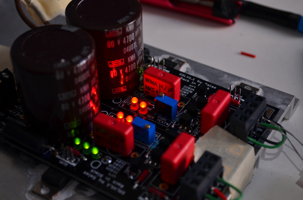

Building a +/-15V pair of BiB's for a phono preamp. I still want to trim the current setting resistors a bit, and am waiting for a pair of enclosures, but otherwise it went very well. I will mount the transformer, rectifiers, main filter capacitors, and some dropping resistors (CRC) in one enclosure, and the BiB board and the phono board in another enclosure. So far it's running around 200mA per rail (negative a little less, positive a little more) with 5 Ohm resistors. I want to get to around 250mA per rail or a little more.
I will post more pics when it is finished.

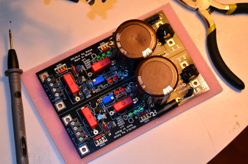

I build the reg today. It is running now on my dac with a borrowed transformer from an amp and a variac to adjust to 15,5vac.
D102/3/4 are 4 green leds measuring 1,76v.
R101=1,2r, 10w
R103=1,5k, r105=2k, max. Voltage adjusted is approx. 13v
CCS current is 1,35A, dissipation of dac is 1,05A.
Main cap is 10000/50v nichicon, other two are 4,7uf mkp.
Adjusting voltage was pretty difficult because it alters when I touch the board or components, I also noticed that if I touch the voltage output leads, the output voltage swings from 12,3v to 13v. Is that normal?
I want to lower the current overhead a bit, how can I obtain this easily? Best by upping r101?
Can I alter r103/105 to any value to make the voltage adjustment range bigger?

1.35A is at the limit of what a an IRF9610 can safely do for internal temperature, better unload it by 200mA. Up the R101 accordingly. Is the PCB rather hot now? Touching the sense points adds interaction. If the Q103 JFET CCS has plenty of current as a sample then you may try shorting R103 or altering it with a parallel so to see if R105 is enough almost by itself. That will widen its turns effect.

The pcb itself is not hot, I use a pretty big Heat sink.
I will lower the current first and than adjust the voltage components.
So touching the wires interacts, best to keep them short than.

If you got an oscope see if there is any EMI or oscillations on the rail too. If not having a scope to know for sure put 100uF across the sense outputs at the reg's connector for good measure. With digital its easy to have interference over sense lines, so keep the power loop short, yes.
Do you mean 100uf over x102-3 andx102-4?
I will put the scope on it tomorrow.
btw. It does sound pretty good now!
Yes, at the connector screws that secure the sense wires directly even. Watch the capacitor polarity.

I have set r301 to 1,55r and current is now around 1150mA, as my dac sinks 1040mA the headroom will probably be enough. Setting voltage is now also better, the IRF was at its limit as you stated.
Still need to scope the supply but that will be work for the weekend. For now it's running stable.
