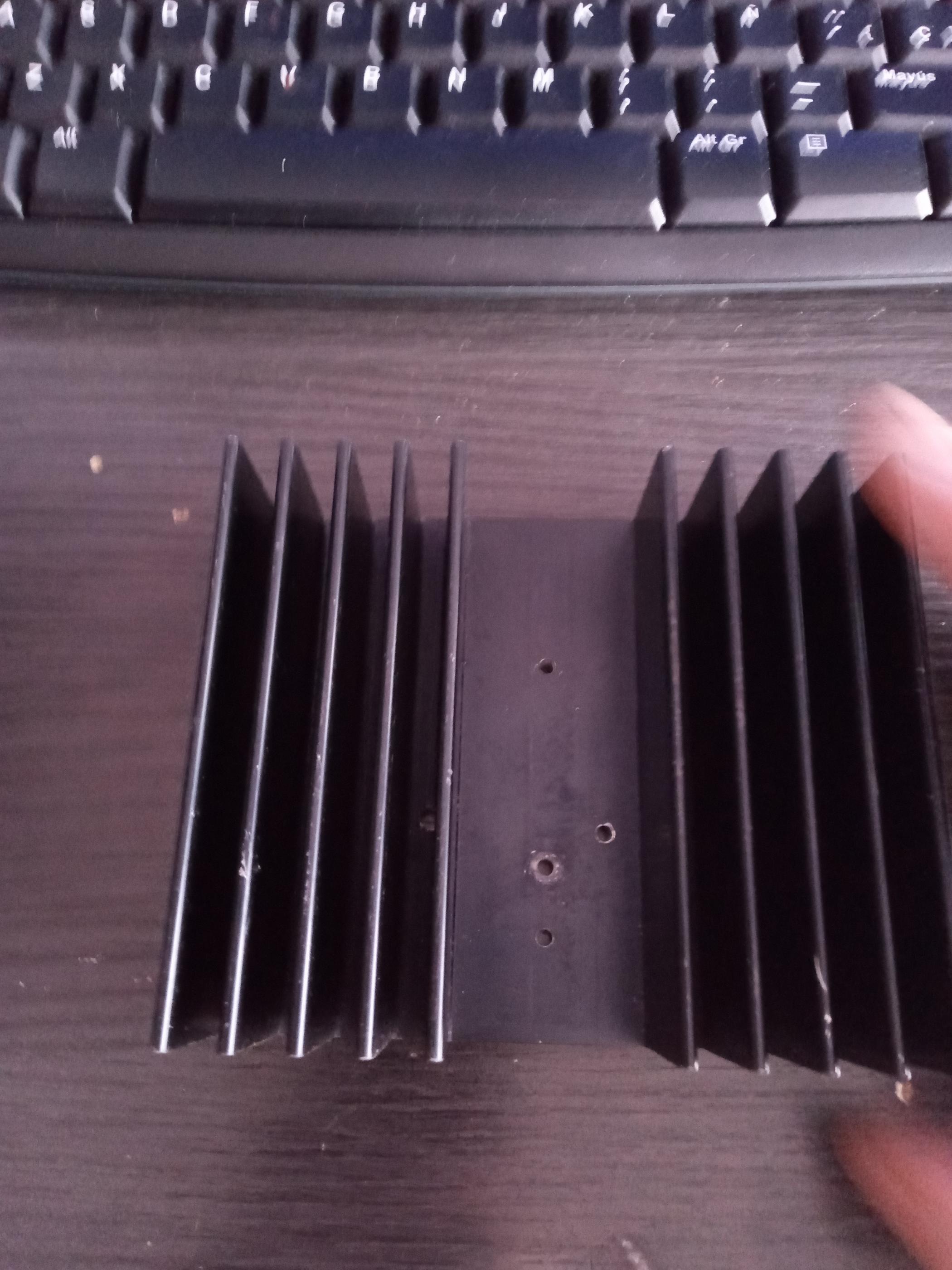

Thanks for the reply! Yes, I read that from the build guide and have difficulty finding documentation to calculate 1.5C/W size heatsink. What have you use in your build? Can you post a pic? I am thinking of using the chassis as the sink. Thanks!
Abe
Mine advice is not use the chassis for HV reg.
Attached pic with the heat sink I use 12cmx10cmx3.8cm
Thank you guys!
Merlin, that is huge! What is your H+ going into the SSHV? I have about 210V, with B+ at 150V.
I thought the write up says spare I x B+ = Watts. Did I miscalculated it? 20 mA x 150V = 3W?
