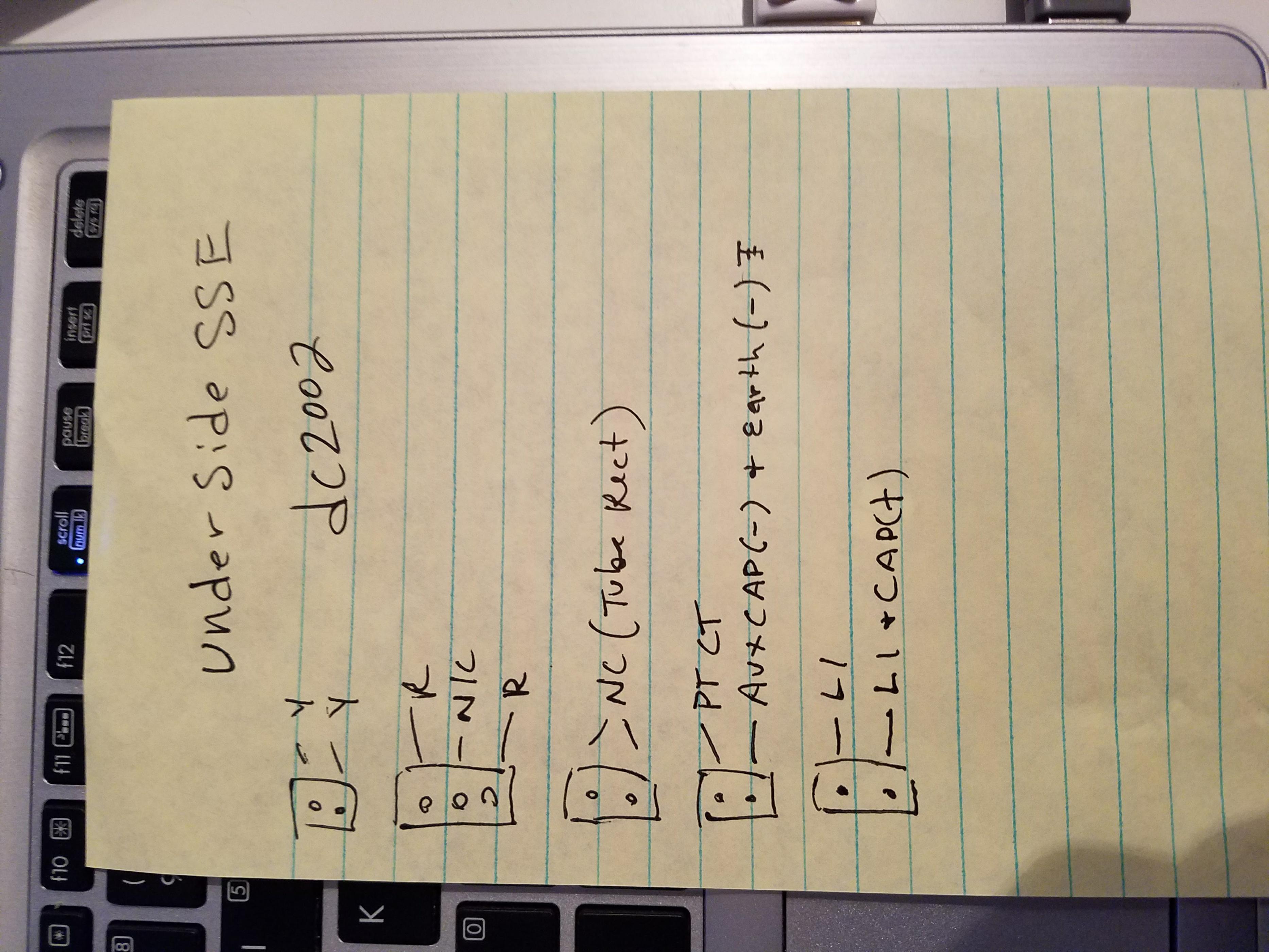

I'm not following you guys - the schematic shows the T1 red / yel at gnd, and the other leg of the aux cap at the choke pads.
So you connect the ct to one of the pads, the gnd end of the aux cap to the other.

only thing i cant figure out is where he connects star ground to the board...i have mine at the terminal where the PT CT is.

Yes that looks the same as he has to me.
That N/C between the 2 reds means not connected.
You told him to put the centre tap there.
He has the red/yellow ct up above where it belongs.
