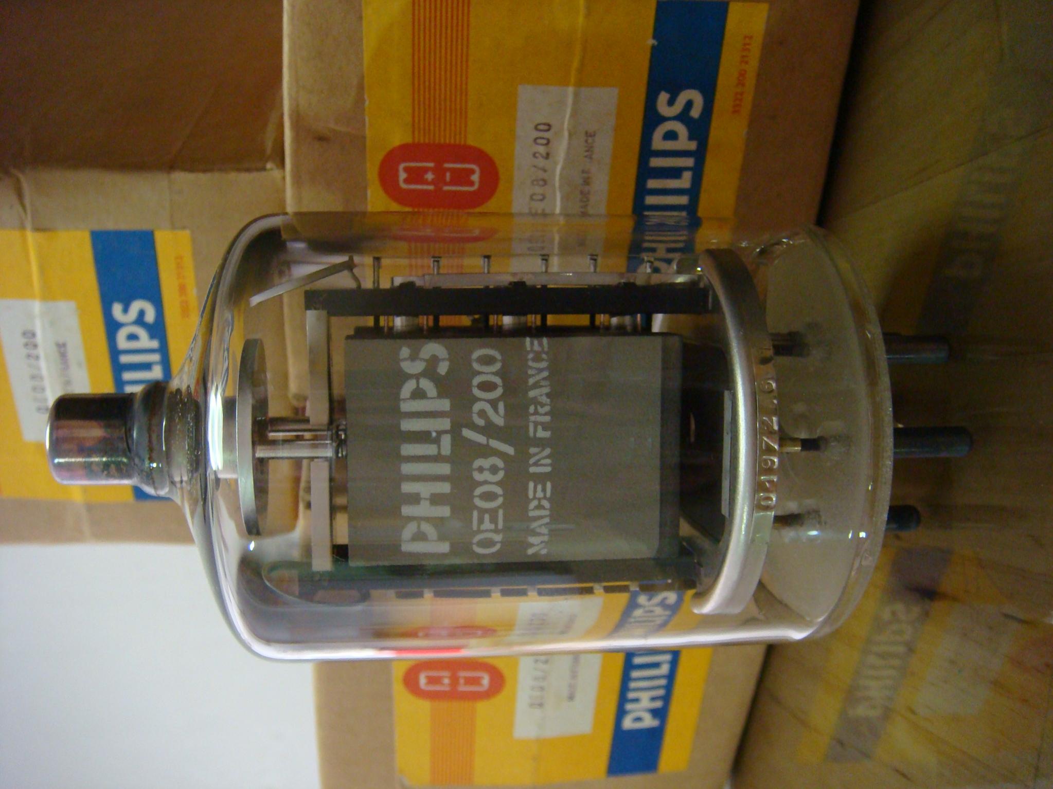

Unfortunately I have to report, that a newly installed Philips QE08/200 tube in mint condition (so the seller told me), blew up! 🙁 It happened to the first design version on breadboard. The actual project is not operational yet, but the second one, mounted on a chassis is almost ready.
Now I`ve got some NOS power tubes from an old and very experienced radio technician, and exchanged them to check their state of health. The first power tube is a SRS461 (eastern germany made, in the past german democratic republic GDR), which stayed for a longer time in the amp. Today I put a Philips QE08/200 in mint condition (so I was told) in the amp - as second power tube for push-pull mode.
It was running very well, the tube was strong with good emission. I was playing music with a second tube amplifier, fullrange on broadband speakers. The monoblock was driving a 15" subwoofer with a passive crossover for the bass, just with a little load, nearly idle (in this video with an active crossover, recorded a few days ago). I listened to the music, and I was not alerted by some distorted sound or something other audible. Certainly the bass disappeard, but not noticeable.
So for about ~2 minutes I didn´t pay attention: but I was suddenly retrieved by some fireworks going up! - my first impression. The second impression was a burning amplifier in my dimmed livingroom, furiously scattering sparks around... 😱 ..and sadly recognized the bright white glowing Philips QE08/200 tube! Very astonished, I realized two choices: grap the phone and take a video... :scratch2: - or to switch that thing out immediately! Due to the fulminant behavior, I switched the power off at first.... I recorded the video a few seconds after the fire had extinguished. The power tube was still glowing very bright and hot. It vented immediately, air came in and the getter material turned to white.

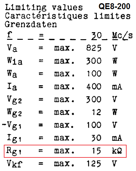

Did you keep the Rg1 low enough ?

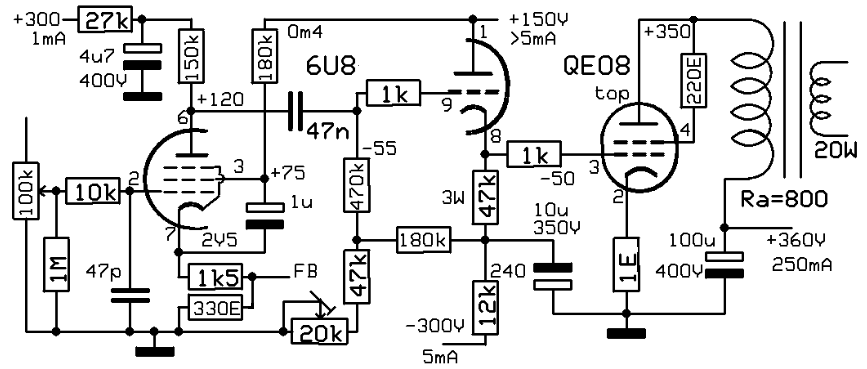

I generate the -G1 voltages with an own power supply. These two voltages go over 100k resistors to G1. Otherwise the signal level from the preamplifier stage is pulled down in the power supply. Like in the datasheet "AF class B amplifier" "operating condition two tubes" I count with Ig1 up to 1mA each tube, that is delivered by the power supply.
Please see my schematics attatched.
There are 150R protective resistors on G2, and a 1N4007 diode. Interesting: +250V from the power supply is measured (before the diodes), but directly on the tube pins G2 you can measure a much higher voltage, 350V for example!
That´s why I´ve put the diodes in, there is a reverse voltage from G2 back to the power supply. And I think this is the problem why some tubes blow up. They just don´t react to adjustment of +250V voltage.

From my experience with the QE08/200 I learned that it is very sensitive to the value of grid leak resistors, especially when working with fixed bias. By experiment I found that the maximum value of the grid leak resistor should be 47kOhms, but for safety I installed a resistor much lower 27kOhms. Such a low value of the grid leak resistor requires that the driver stage has very little internal resistance.
The PHILIPS transmitter tube QE08/200 is designed for operation at relatively low voltage (max-825V!). The factory data does not have curves for triode connection, and since I could not find them on NET, I had to experimentally determine the initial output settings for the A1 SE-audio amplifier class. Available data indicate that the maximum voltage for G2 (in tethrode!) can be ~ 350V, but in a triode connection, the tube is stable at Ua-Ug2 of 500V!
The value of the G1 leakage resistor has been problematic, and for stable operation, it is necessary to keep a relatively low value compared to the normal values, at least when using a fixed negative bias. With values ​​of ~ 50 kOhms (and larger ones, especially!), there would have starteed a backward emission and a gradual increase in current through the tube, which would ultimately lead to self-destruction of the tube.
The limit value of the G1 resistor stability ranged around ~ 45kOhms, but for stable, safe and long-term operation, it would need to use lower values. Although the electronics are foreseen for permanent work at anode dissipation of Pa ~ 100W (in triode connection probably more!), to prevent longer working life of the tube, I decided not to go with dissipation greater than Pag2 ~ 80W, which with voltage from Ub ~ 450 -460V results is a current of Ik ~ 175mA.
Existing output transformers can expect an output power of ~ 20W )more for maximum power!) but in practice the usable part is smaller (parametar is distortion up to ~ 2%). The low value of the G1 resistor requires low internal resistance of the driver stage (or more excitation power), so the choice of driver tube is limited. The intention to use the tube D3a-triode connected with its small internal resistance (Ri ~ 1,9kOhma) and high gain (~ 77x in ideal conditions, and in practice a little lower!) which excludes the need for more tubes.

Hi Tobi,
imo, a forward diode to G2 can be deleted, not sure if 220 ohms in series is a good value...
nice inputs, G1 grid leak of 10k is seriously considered, 27k seemed to work, these are invaluable tips to consider....
inductance in the grids? i have had not so good results with those is the 6C33 grids...i used carbon composition resistors in that spot...
your opt with a dc resistance of 0.95 ohms and Ik of 185mA gives you a loss of 175 vdc, i think that is too high....
others may comment about this...i want to be corrected....
... 100k resistors to G1. Otherwise the signal level from the preamplifier stage is pulled down
You can't cheat Rg1 (much). If the datasheet says 15k, USE 15k. If you need a stronger driver, build a stronger driver.
Since you have a coupling capacitor to the grid, the class B(2) conditions do NOT apply. You can not force 1mA of DC through a coupling cap. You *can* have 1mA of DC grid current from gas or ionization in a hot tube. Working in 100k, this is a 100 Volt shift of grid bias. That can not be good.
Yes, some tet/pentodes can have negative screen current under some conditions. You do NOT want the G2 to "float up". Lose the diode. If your 250V supply can not *absorb* the negative G2 current, use a bleeder or other trick so the G2 voltage never floats up.
A small (100r-1k) G2 resistor has little effect most of the time but may reduce G2 abuse in extreme conditions. Guitar amplifiers often use G2 resistors.
Perhaps the safe way to drive that tube is with a cathode follower.
Something like this (didn't try it) should give an input of around 300mVtop without FB.
Best to turn on the supply after the 6U8 is warmed-up to prevent allmost -300V between heater and cathode (heater at ground level).
