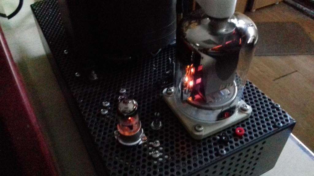

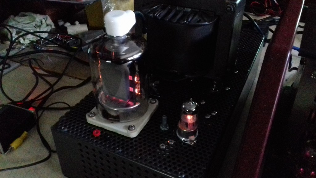

- Negative G1 voltage works best at -36 to -37V.
With lower G1 voltages, sinus test signals are distorted, and the SRS461s took too much current and start to glow dark red.
- Anode current is 0,2A idle, with G2 at 250V.
- The unclipped sinus output power is ~200Watts at 8Ohms, for permanent duration. Music power is ~250W.

The few malfunctions that appeared within these 300h:
After 150 - 200 operating hours, there was suddenly a fatal breakdown of the circuit. By analyzing the aftermath, the -36V G1 Bias voltage failed for one SRS461. The Bias voltage for the second tube remained ok.
Unfortunately the anode heat was too much, the glass cracked on the top cap connection. Caused by a shorted grid, the negative G1 voltage then went more and more positive, and the tube blew up. By inspecting the inner systems of the tube, it can be seen that some metal sheet connections were botched in the assembly.
A "military grade" trim pot from surplus started to noise annoyingly in the driver stage after ~250h . Even though it looks like rugged quality.

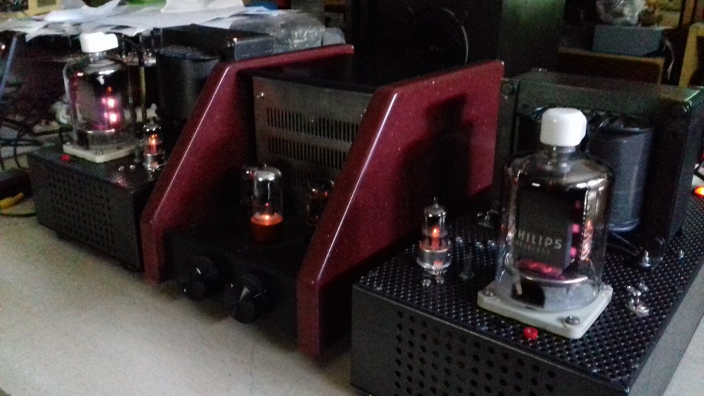

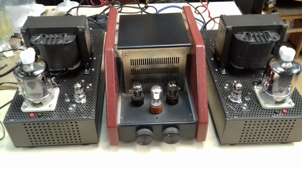

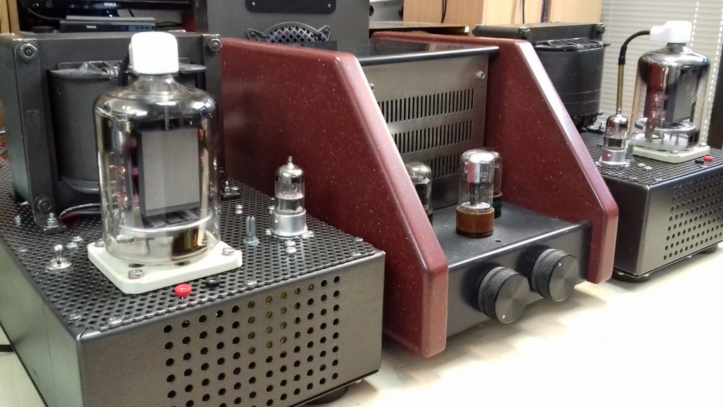

My monoblocs with QQE08/200 and D3a:

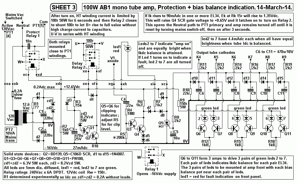

Good work. I'd include a protection circuit like the one used on one of Patrick Turners amps, see attached (Q5 etc). I put one on my 120w EL34 amp and it has been very useful especially when mucking about making changes. Not shown is a 15r "sense" resistor between cathode and ground of the OP valves, I used 10r in mine and tweaked R8 and R10

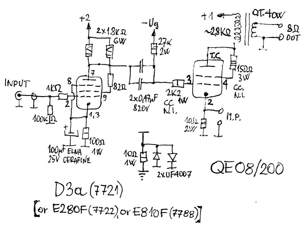

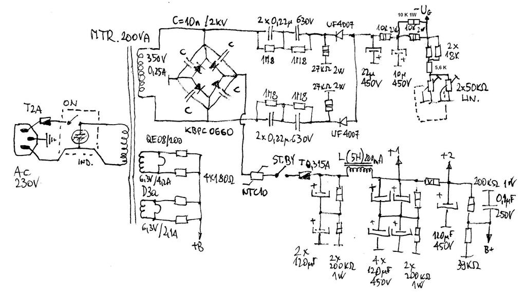

QE08 / 200 is connected as triode (G2 to A), and output power is P ~ 20W in class A1 without current G1.
The cathode current is Ik ~ 170-180mA, and the amplifier works very stable for 3 years.
Attached to the amplifier and rectifier scheme:

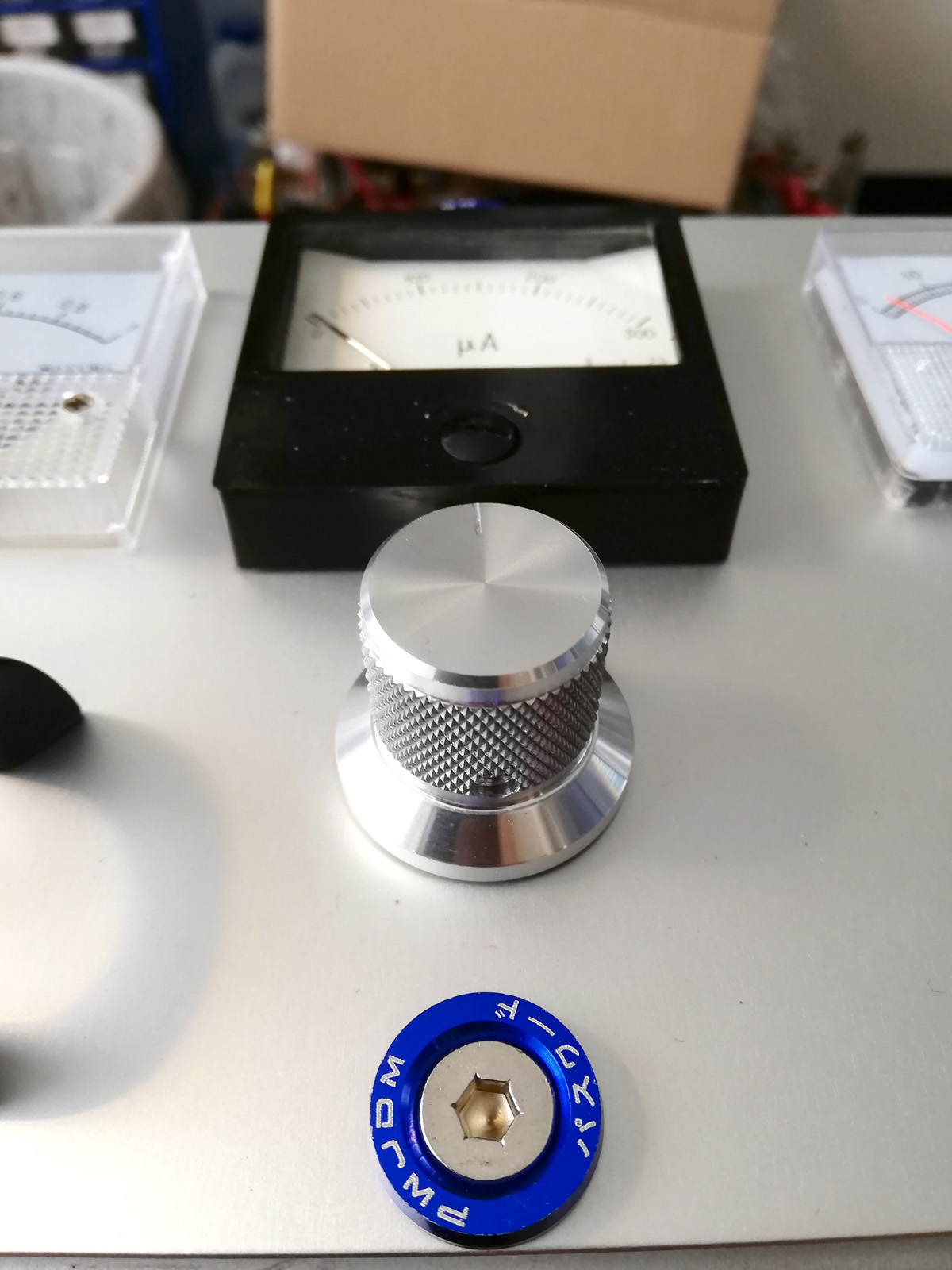

Thanks for all your replies, I will answer them after some new pics!

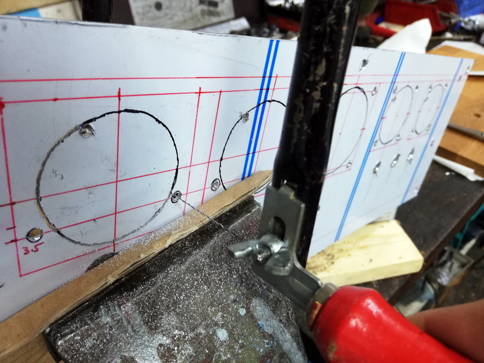

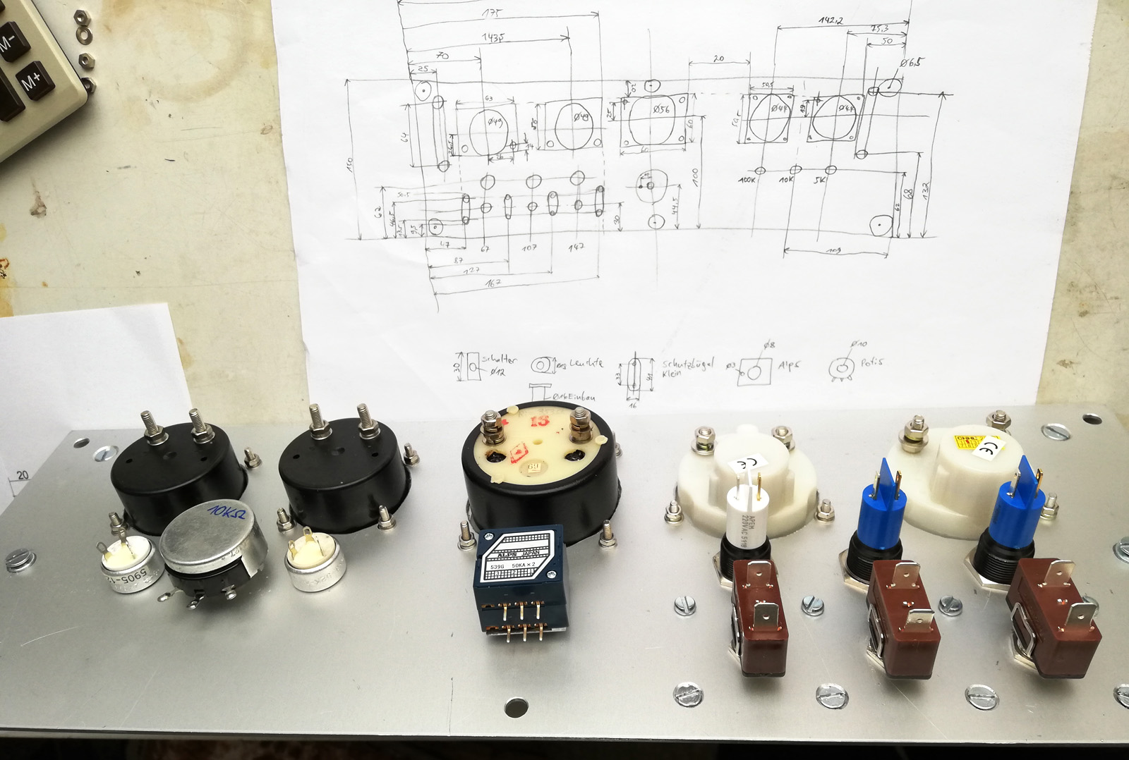

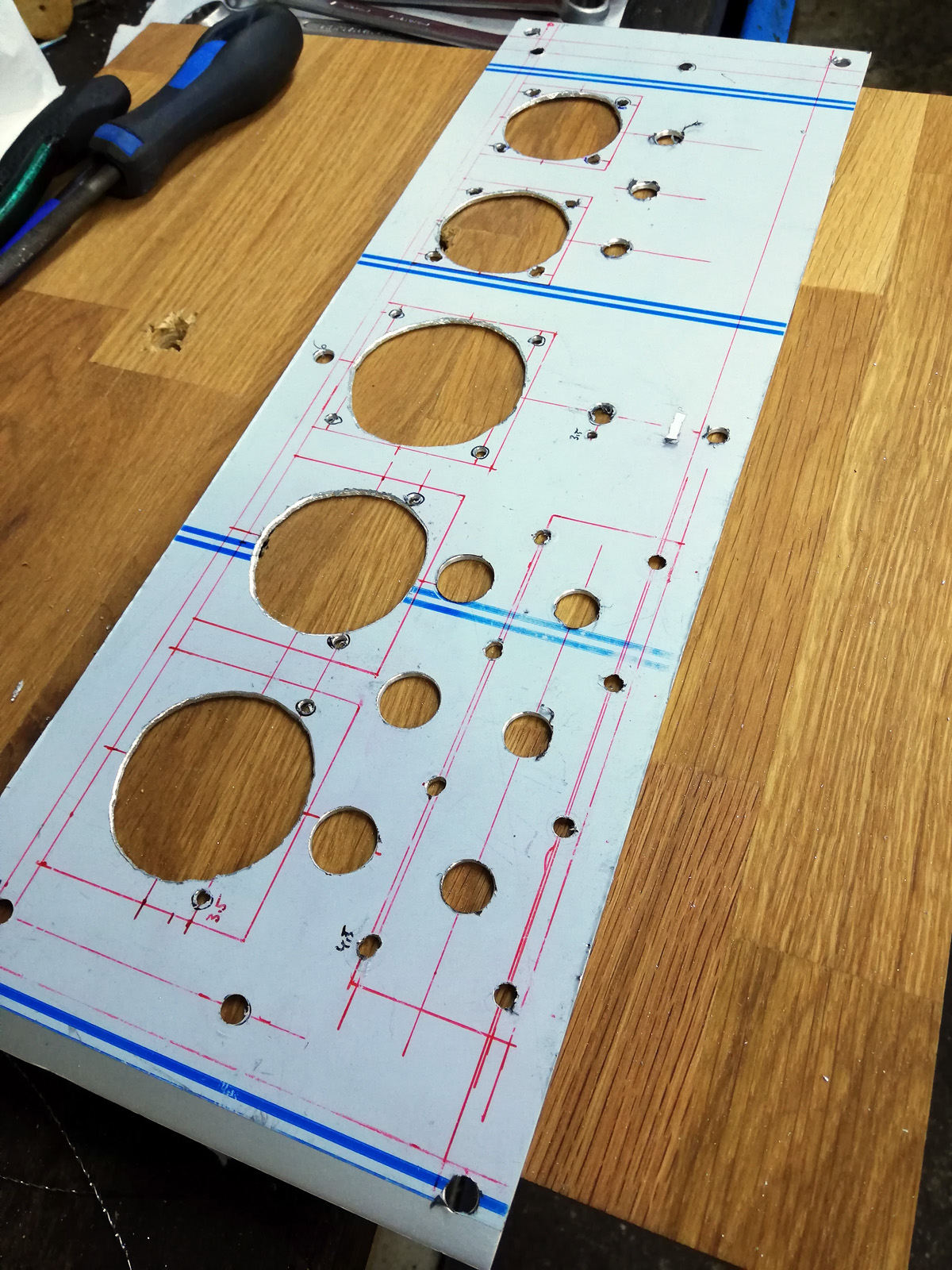

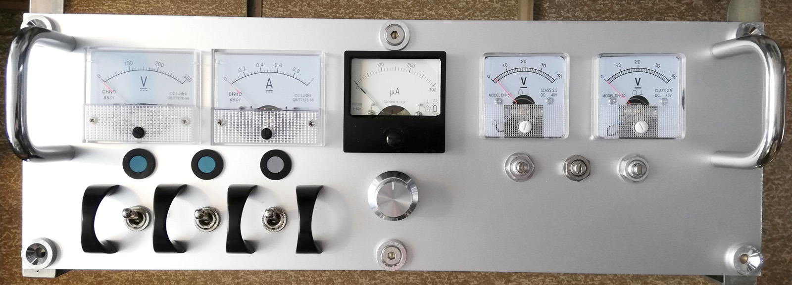

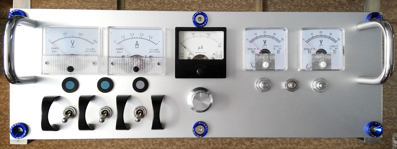

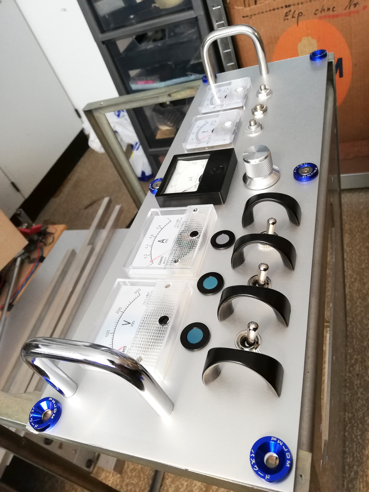

This is how the front plate will look like. The signs are still missing.

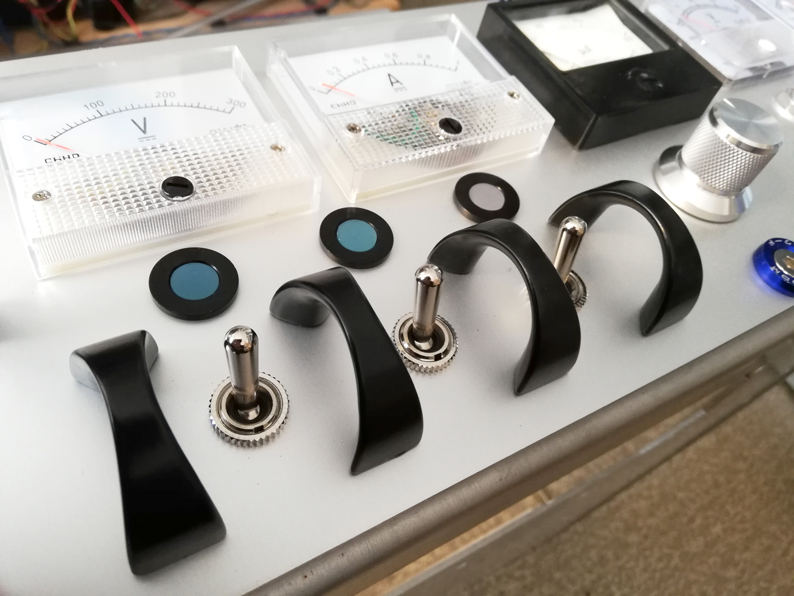

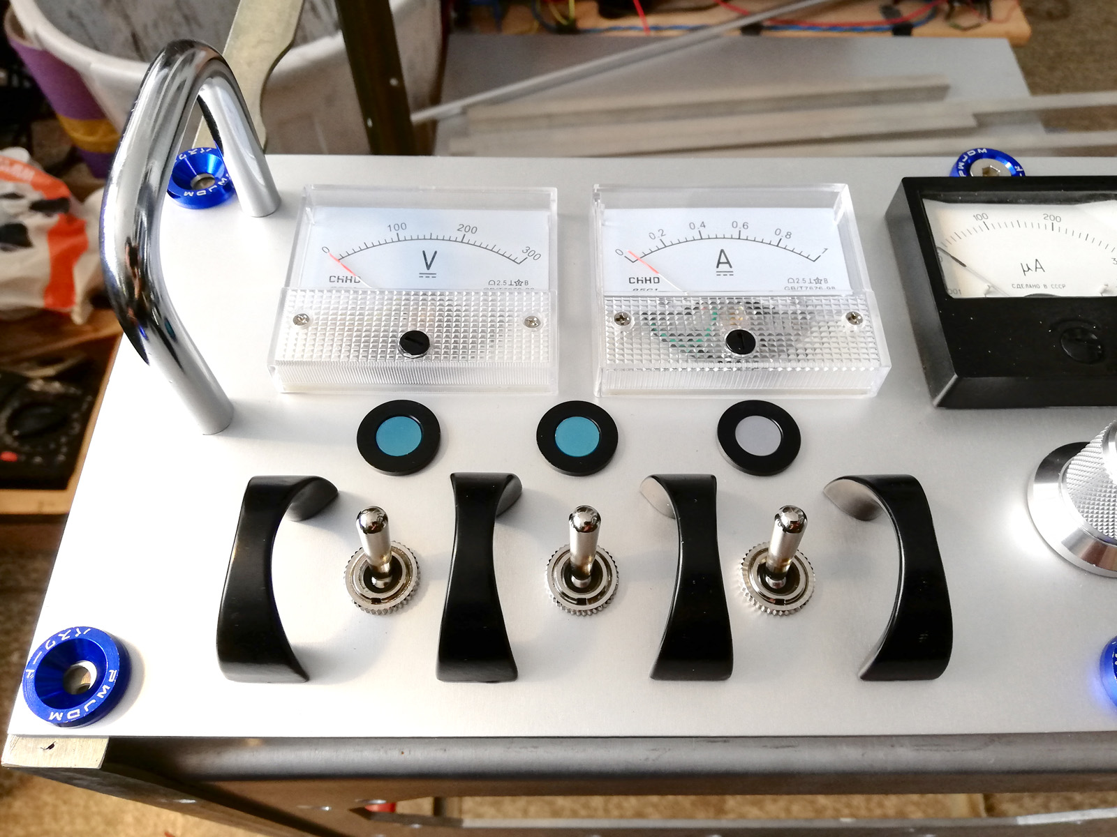

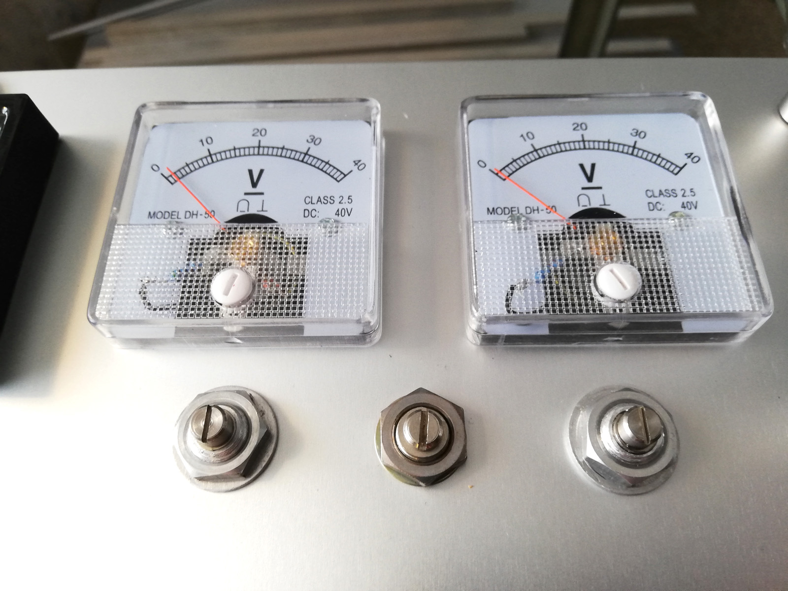

During operation it has become clear that monitoring of the following values is important: total current consumtion (1A gauge), G2 250V (300VDC gauge), negative G1 voltages (40VDC gauge). Output power is nice to have (300uA gauge).
In an earlier design I desired to have a fully automated design with time relays which start after a specific time for the rectifier tubes and some more.
At a closer look, that will bring more sources of error.
An automated process is not necessary, the operator should know what he´s doing.
Now I use three power switches for three stages of operation:
1. pre-heating DCG4/1000
2. auxiliary voltages and heating of preamp and SRS461
3. high voltage
The blue highlights took up the topic of the blue glowing rectifier tubes.
The second monoblock will have silver washers on the front plate
3. high voltage
