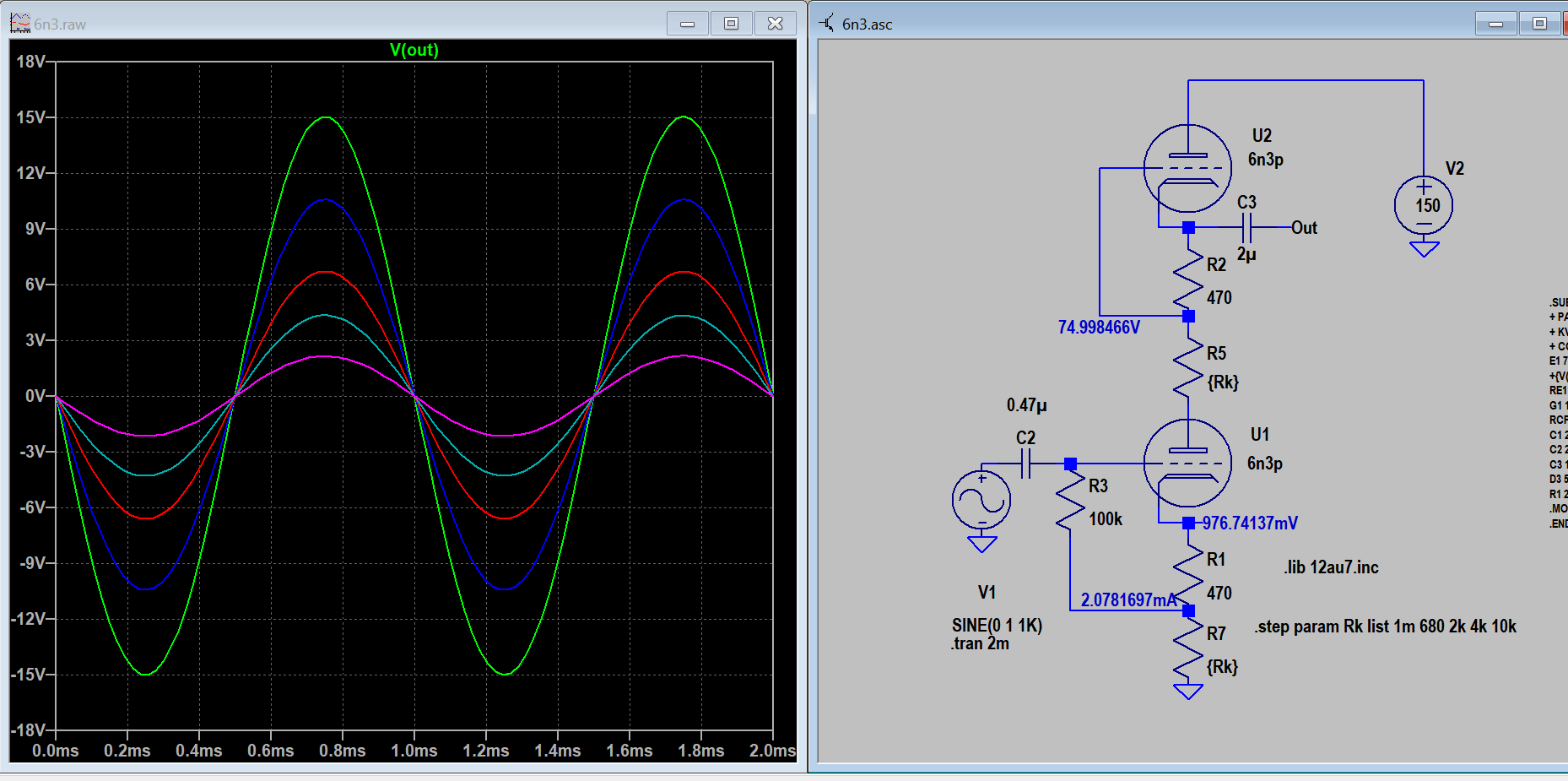

Try this mod. Added 2 resistors as sch. attached, they reduce gain by introducing degeneration or local feedback. Pick the resistors up to 10k. The mod does not change the operating points as bias and current are same, just reduce gain. You can't reduce gain by simply changing SRPP cathode resistors.

The gain of 6N3P is 24.6 dB in SRPP circuit. It is not possible to reduce it by changing the cathode resistors. The only possibility is to use a lower μ tube. The μ of 6N3P is 36.
6DJ8/ECC88 would give about the same gain.
