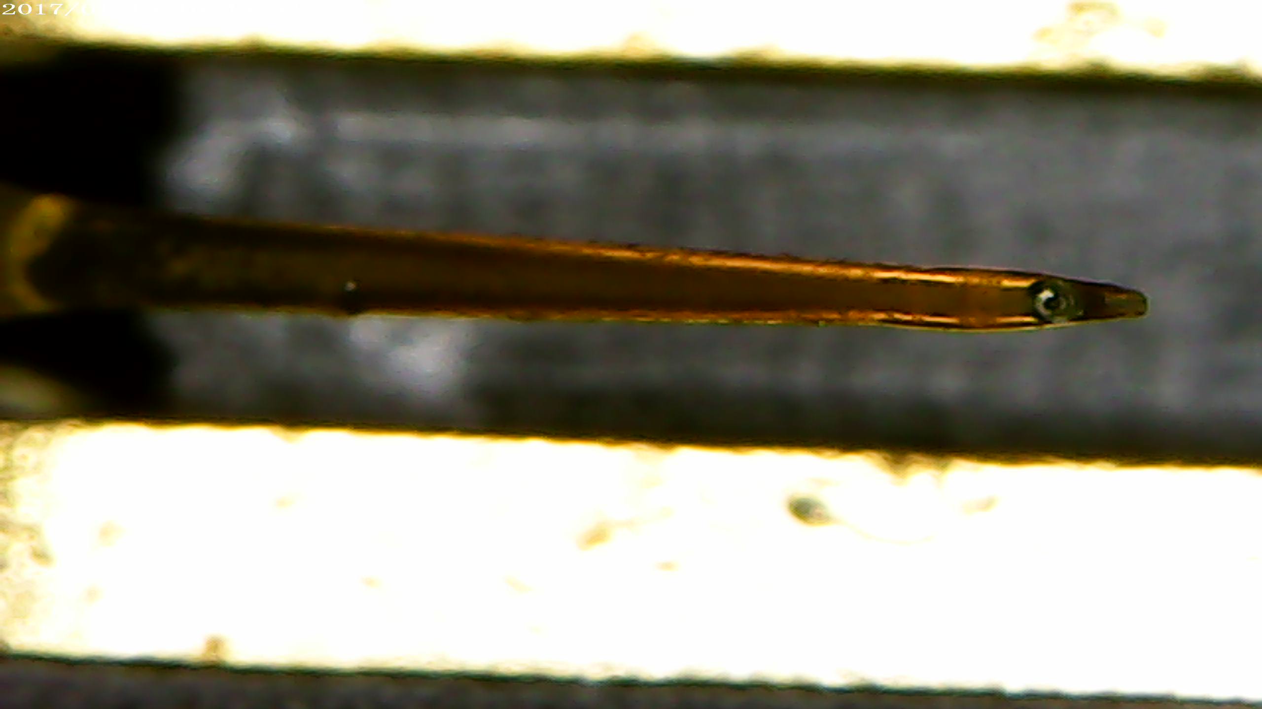

Attached is a (bad) pic of an AT-150 carrier fitted with a cactus cantilever and 0.5mil 'microcone'.
perhaps 0.5mil spherical was Shure's intention prior to the elliptical variants which
solved some of the loading issues?
Shure thought that the 0.5 mil spherical rides too close to the bottom of the groove,
and went with 0.6 mil instead. See page 20.

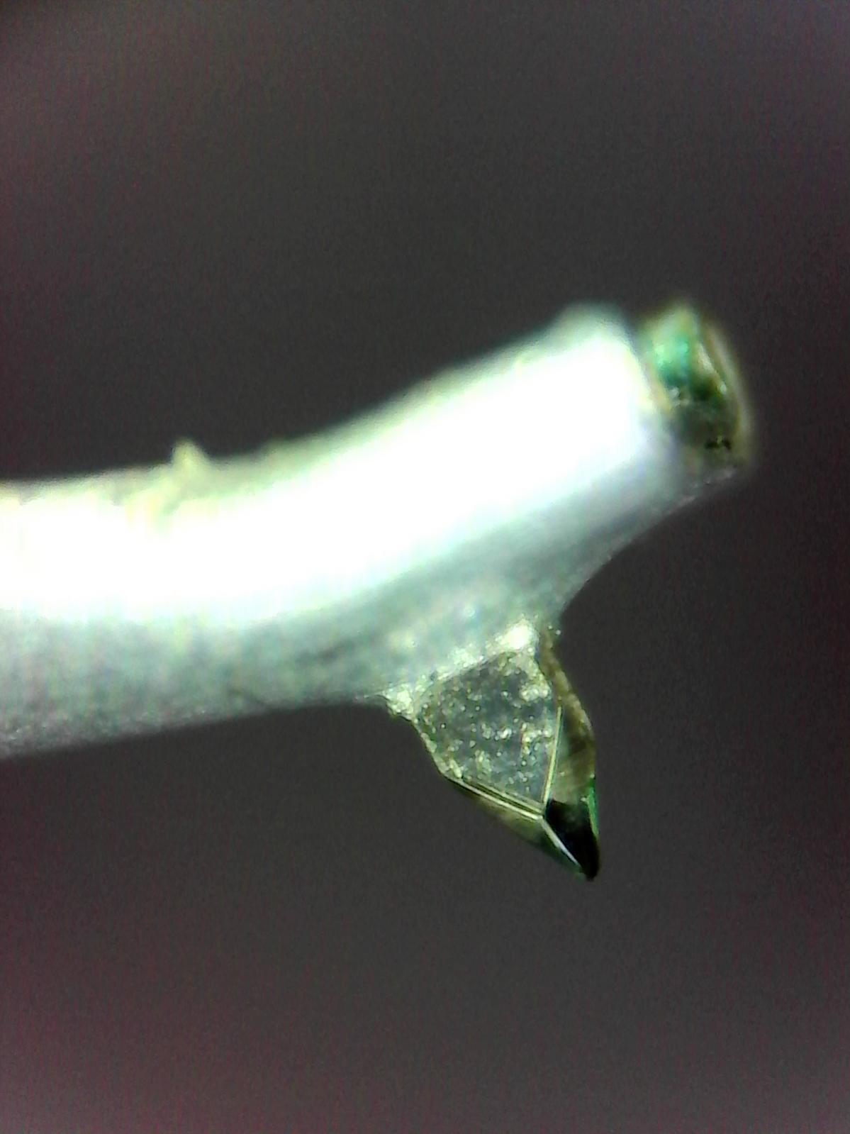

Hi, Spend the morning taking photos of the Shibata cartridge in position & have managed to get a half useful shot.
Superimposed that onto a XL spread sheet to try & guesstimate the angle & have come up with 95/96 degs, slightly over adjusted. but it still sounded fantastic, with bass slam to die for.
Have slightly backed it off & this afternoon will do some more listening and report back.
It is difficult to see from that pic. However, as I mentioned before, the cartridges are designed to be parallell to the record surface for correct SRA/VTA and nominal VTF. If there are big deviations for this, the cartridge is faulty. I have not found that any of my cartridges need to be different than a parallell arm to get the desired SRA/VTA.
