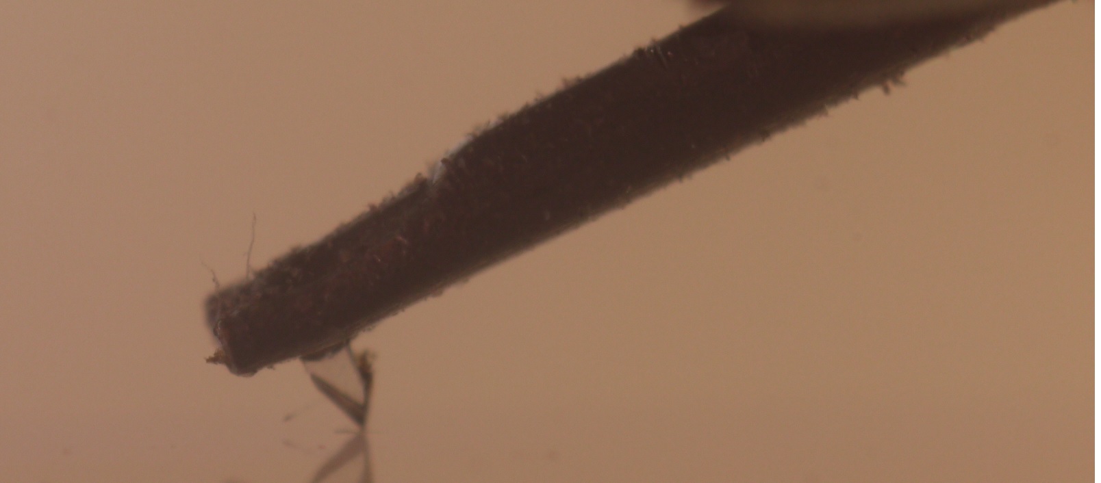

ok last night's pic. I have given up on the tripod and gone hand held for this. Gets me a better angle. This is with the rear of the arm up and a 30mil shim.
Next step is to get a shim 3D printed. Meanwhile it still sounds great :)
