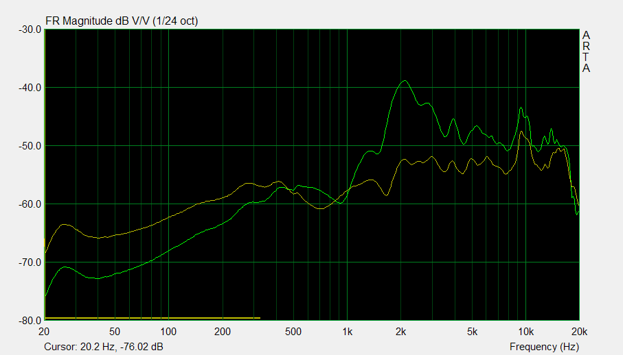

Here's the strange thing that Arta does, that screws up the measurements:
It seems to "normalize" the graph.
Here's an example:
A few months ago I built a horn sub. In order to evaluate the horn sub, I also measured a vented sub that I had. Arta showed that the horn sub had no output advantage
This made no sense, as hornresp predicted an efficiency advantage of 10+ dB, and the horn sub SOUNDED louder.
After banging my head against the wall for days on that, I measured with HOLM, and HOLM showed exactly what Hornresp showed:
An efficiency advantage of about 10dB for the horn.
So Arta is "normalizing" the measurement, for some unknown reason. I've read through the manual, haven't been able to find a way to turn this "feature" off. It also makes me wonder if polar measurements with Arta are reliable. (IE, if the output off-axis is down by six decibels, will Arta's stupid "normalization" feature normalize the off axis graph?
Well FWIW, ARTA definitely is not and has not ever done that for me. If you want me to try to reproduce it, just let me know how you're using it (I've got a mic right here and can just run measurements of one the desktop speakers whenever, easy peasy). If I just run a normal FR measurement how I always do and then change the level (completely outside the computer setup so equivalent to changing speakers), the difference in level is accurate.
To replicate it, simply measure a sealed box and a horn.
When I do it with Arta, it shows that their output levels are basically identical.
It appears to be normalizing the peak of the graph.
You can't replicate this by simply measuring the same speaker at different voltage levels, because the normalization appears to be base on the PEAKS. Arta seems to be graphing things so that the peak of the measurement is always the same. (IE, normalization.)
I don't think your reasoning makes sense as to why changing the speaker level wouldn't be equivalent but no matter, here is a measurement on the tweeter axis from pretty close (yellow), and then the same with me holding up a piece-of-paper horn (green). The woofer output is included, so you see it go down with the horn blocking it, but no levels or settings were changed.

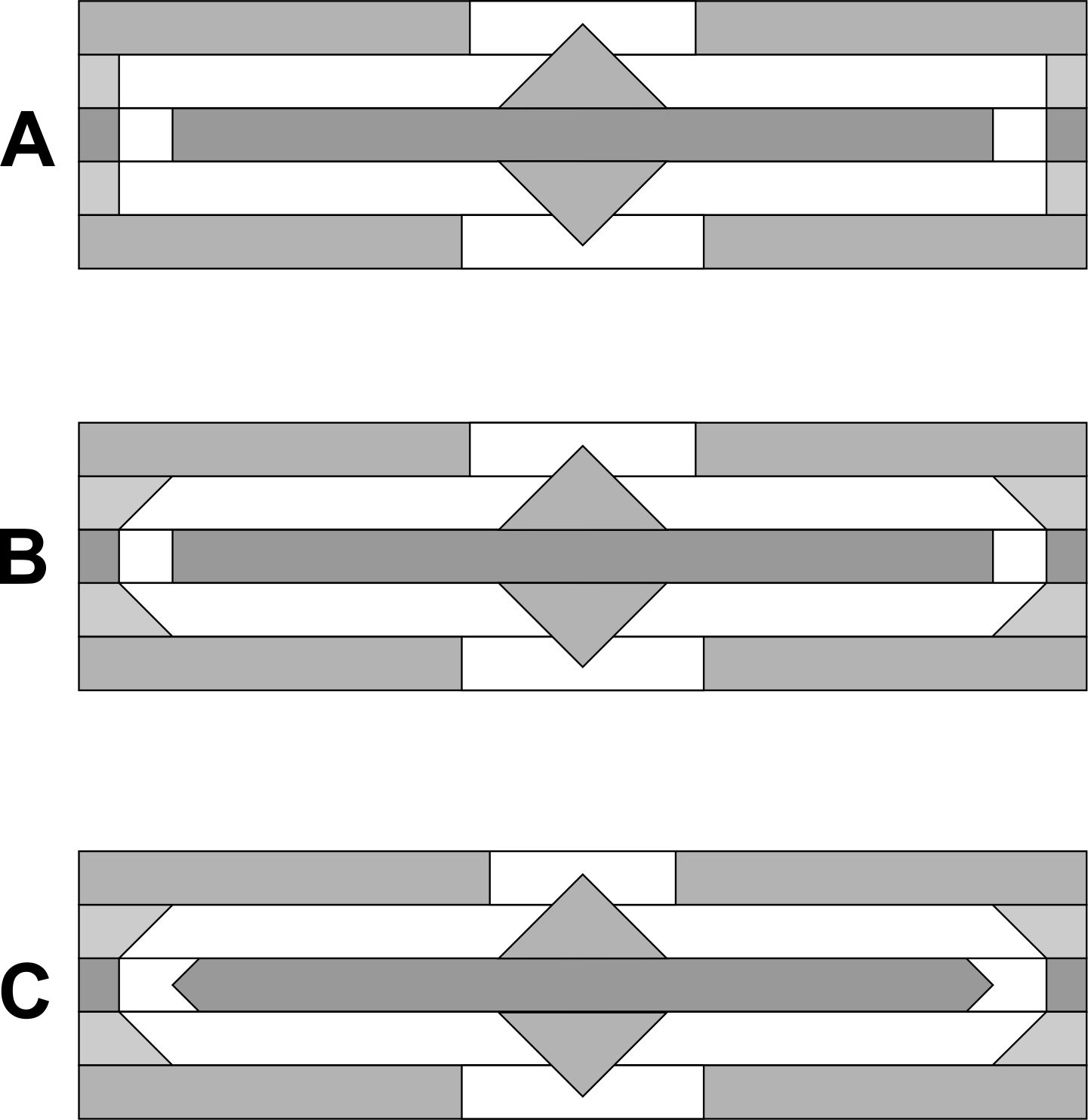

Hello Guys 🙂
After reading tons of interesting posts here I bump up this thread from sleep just to ask one question.
Is there any conclusion about purposefulness of internal 45 degree reflectors along paraline spacer layer(s) - on 180 degree bent?
Hello Guys 🙂
There are two schools of thought: some people think of this as a ray tracing like optical reflections off mirrors, some like me, say it is all pressure waves and can be modeled with 1d lumped element models and that 45deg or 0d reflectors won't much difference.
I'll add a third way of looking at this. This involves pressure waves and reflection, diffraction and reversion waves. Sharp corners and short wavelengths are a real problem with these designs, it is obvious when you look at the outputs from the many designs that have been proposed.
Considering that in this case "reflector" is considerably smaller than wavelength reflector does not make too much sense.. than again this is true only when we observe just one dimension of wave-guide so I believe that reflector may help to improve paraline device by a bit.
There are some of my brief observations and sketch of three examples:
A. Original, straight cut paraline element without reflectors - only pressure wave approach. Due to pretty long "vertical" area exposed in one dimension of wave propagation .. higher possibility of partial reflections/cancelations within paraline device
B. Huygen's approach - Corner reflectors (chamfered edge of spacer layers) - reduced passage area on each turn (possible effect of "choking" - low pass filter effect)
C. Combined approach to justify booth worlds and avoid possible negative effect of each.
..so chamfered edge of spacer layers + chamfered edge of eyeshape-center wafer. Huygen's full area "optical" reflection is possible but without area reduction.
From "pressure wave" point of view there is constant cross section area through 180 degree turn (I believe,.with even less unevenness than in original A. example)
..any thoughts, critics, observations.. WELCOME 🙂
