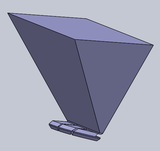

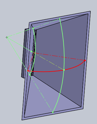

I was actually playing around with ABEC3, to see if I could sim a paraline in it. I made the software work, but the results were awful without a horn to complete it, so I thought I would add a simple horn. I just saw Tom´s comments, and thought perhaps this drawing would help. And if I´m wrong, you guys will correct me.
I aimed for a 60 degree vertical paraline with a standard rectangular exit.
The green sketch shows the apparent apex of the "squashed" dimension, while the red one shows the apex of the "diffraction slot".
If I wanted these to come together at the same point, I was forced to have the horizontal angle be 83.5 degrees.
If the height is 500mm, the width then needs to be 350mm, so height is about 1.5 times higher at these angles.

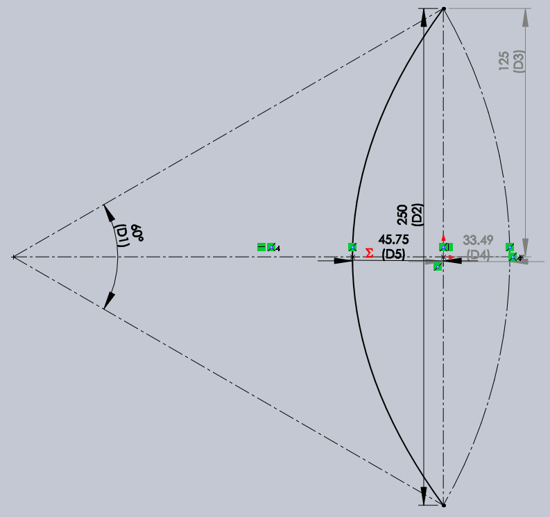

Well, I had a go at simulating the Paraline (see post 862with BEM in Abec3. It´s probably strictly not a paraline, since I didn´t really think about dimensions.
It was really an experiment to see if the BEM solver could handle it, and if there are any learnings from it.
So, aiming for a 60 degree vertical angle, this is how to arrive at the curve. Draw the 60 degree arc, then make a parabolic arc with depth (D5) = D3/2-D4/2. This ensures that the total distance traveled is equal in all directions.
Note, the height (125mm) was randomly chosen - more on that later.
I thought it was a good idea to split the paths into segments - perhaps that was a bad idea, perhaps it works out well to reduce resonances in the material. ABEC doesn´t simulate that (i think), so it won´t matter here, but it could have other effects.

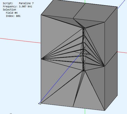

Getting the solid file into a mesh is quite easy, just export to STL. But for subdomain modelling, ABEC needs to know what´s the inside and what´s the outside. For that, I made a "negative", which basically shows the inside. That negative can be imported to ABEC, and normals reversed, so the mesh of the negative becomes the inside of the paraline and horn. From the image below, you can see the slanted reflectors inside the paraline.
In ABEC, the whole thing looks like this, after adding some simple walls to enclose the externals:
The model simulates everything inside the "negative" above as one subdomain, and then there is a boundary element across the horn mouth that lets radiation exit to subdomain 2 which is "everything else".
I set the mesh frequency to 10kHz, which translates into a rather fine grained mesh. Perhaps it´s too low, but with 10kHz it took about 1.5GB memory to solve, and memory requirements increase exponentially with mesh density. On my computer this took nearly 24 hours to solve for 100 frequencies between 100Hz and 20kHz.

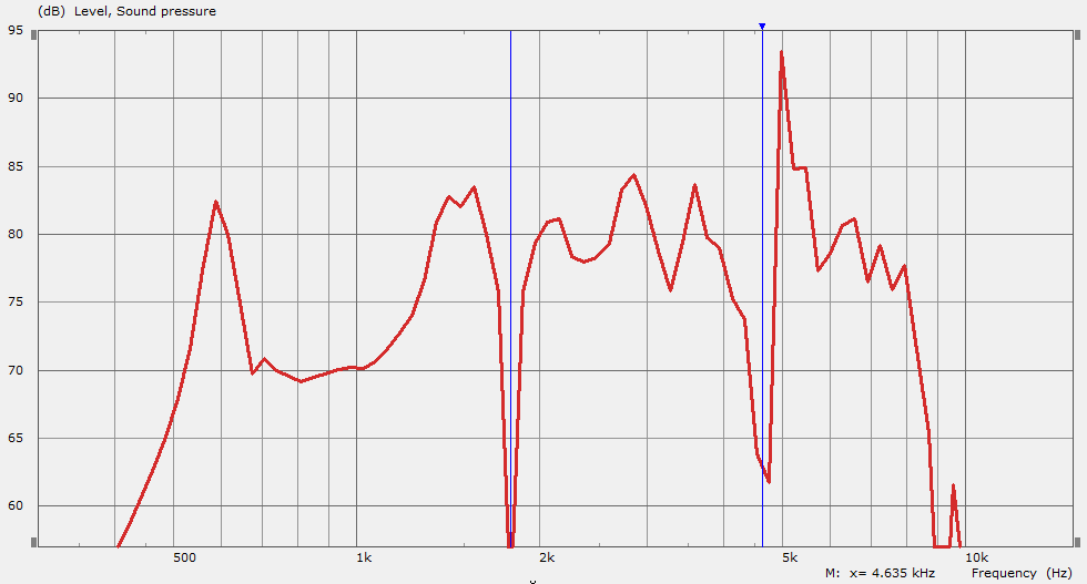

The driving source for the analysis was a stock compression driver (i´m not sure which one even) that is included with ABEC. It has a one inch exit at least. If somebody has a known compression driver modelled in ABEC, let me know, and I can plug it in to see how the results are.

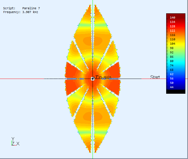

Anyway, here are the results:
Now, this is at 2m distance from the entry of the paraline driver. Pretty bad.

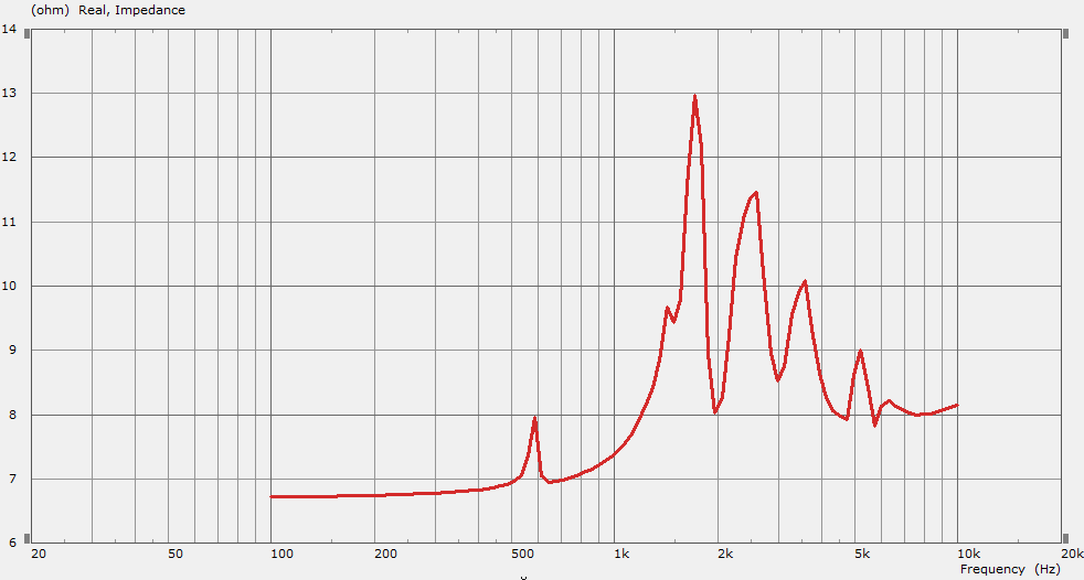

Impedance:
Ok, so how does this look "inside" the paraline. Since the paraline is folded, and I can only do "two dimensional" spectra, I chose the frequency of the second dip to examine, and only include the expansion layer after the entry.
One can clearly see two "modes" inside the paraline, caused by reflections I suppose. Why the SPL of the four center ducts are so much higher is beyond me, but it could be that the smaller path length to the bend cause the reflections to actually sum constructively there.
Anyhow, it does seem that the 250mm total length is way too much - set randomly as I mentioned.
It would be interesting to model one of the "successful" ones, or one with significantly smaller dimensions. Anybody care to suggest a length to try next? 🙂
I can also extract all kinds of charts from ABEC, but horn directivity etc is not that interesting with such a ragged response. But if there is interest, I could certainly post them.
Impedance:

Cookiemonster,
You are the man! Very nice simulation.
This is the first 3d BEM (FEA) I have seen of a Paraline. Great work!
I have to step up to ABEC3 one of these days. I have SW too.
Here is a 1d Akabak model of my Paraline (a little different but same concept of flat folded channels) from Post 759 or so. I got some really ratty looking response curves too:
Looks kind of similar to your 24hr sim:

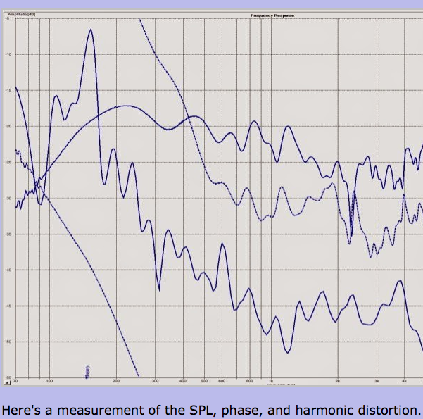

Check out some of my projects. I once used the Faital 3FE20, but I've found that the Dayton ND91 works better.
I've also used the B&C DE10 for a Synergy project.
My latest project uses four of the ND91s and a Vifa XT25. If cost was no object, I'm not sure if the XT25 would be my choice. But at a cost of $20 each, it's tough to beat.
Here's a measurement of the SPL, phase, and harmonic distortion. This is at 45 degrees off axis. (Which is the listening axis.) The measurement is kinda rough bcuz I did it in my living room. But you can see that the $19 Vifa keeps distortion 30+ dB below the fundamental. Works quite nicely on a waveguide.

"Patrick",Here's a measurement of the SPL, phase, and harmonic distortion... But you can see that the $19 Vifa keeps distortion 30+ dB below the fundamental.
I can see the distortion level rising 20+ dB above the fundamental frequencies below around 160 Hz, well over 100% distortion.
What was the approximate SPL of that measurement demonstrating distortion in excess of 100%?
Art
I measured in my living room. The gate is set long enough
to get a general idea of what the response is. But the lower you go, the less accurate, due to reflections.
I measured at -10dB from the maximum output on my amp. Its about 50 watts, so thats probably around 95dB
In room distortion level rising 20+ dB above the fundamental frequencies, well over 100% distortion, around 5 watts producing only 95 dB is, IMHO, effing pathetic.
